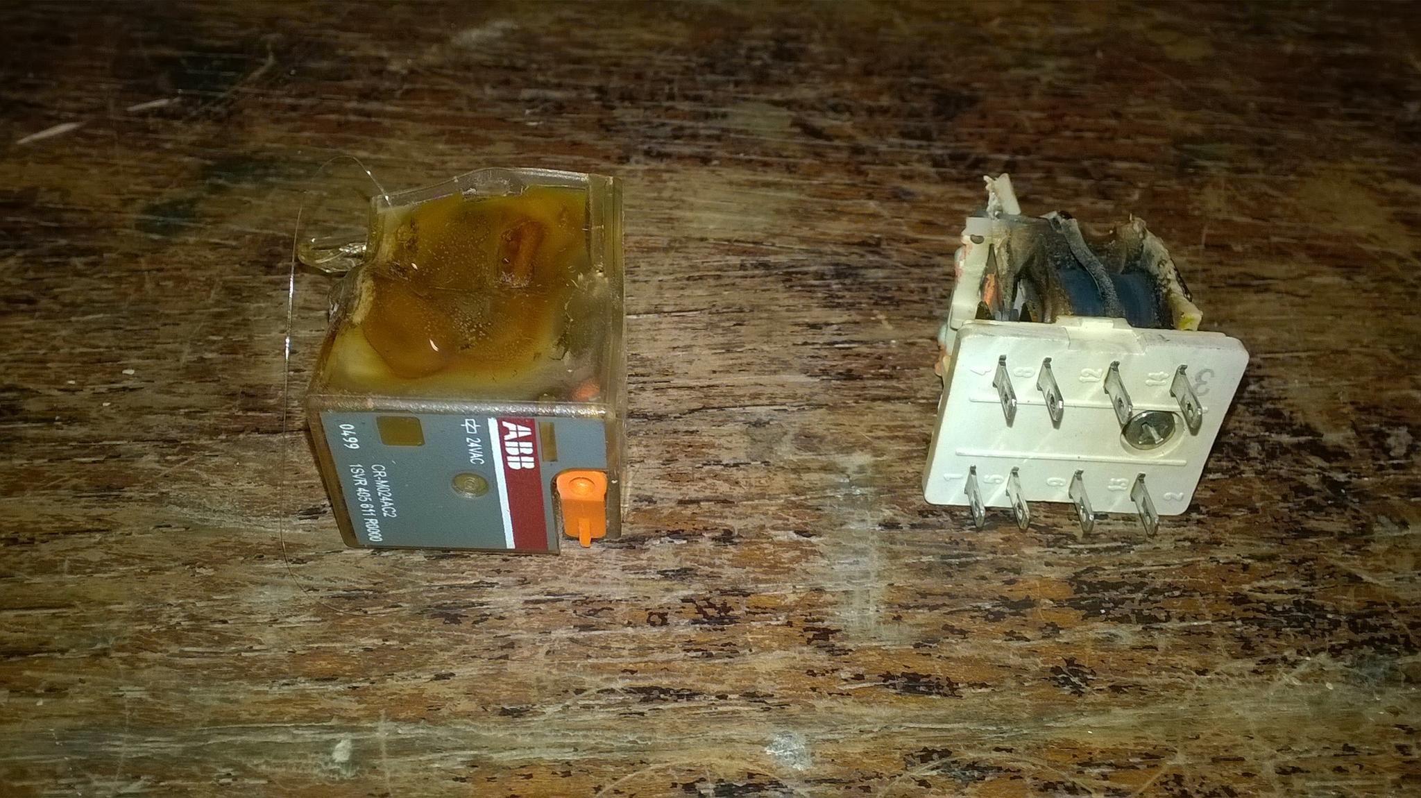

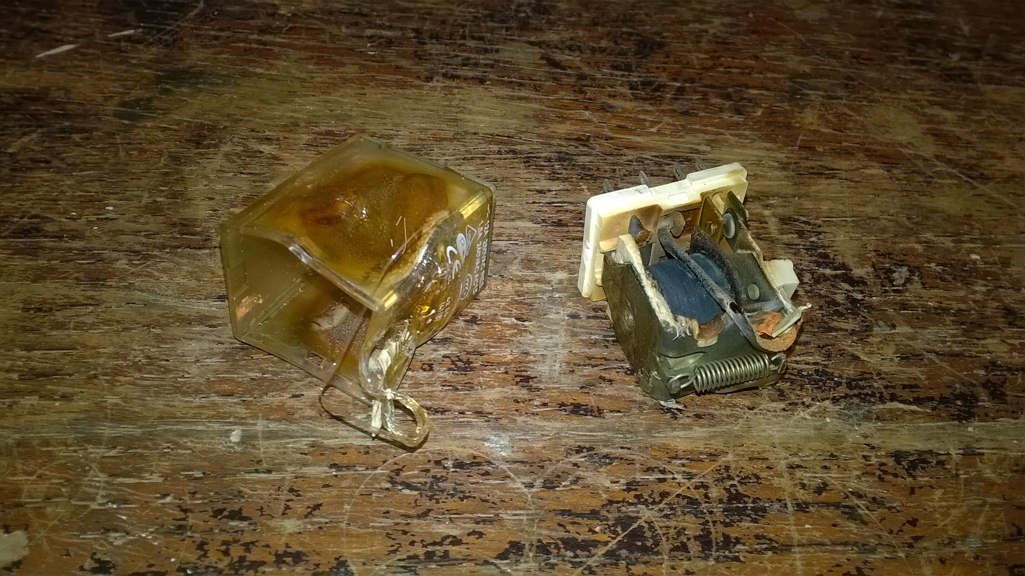

    I designed and made a control panel for a furnace a year ago and it has worked well except for one relay in the 3phase control box. This relay powers up a contactor to keep the fan running for the air supply. The furnace is on 24/7 and that relay has burnt out with a coil overheat twice. This happened for the second time today, while I was visiting the workshop, so fortunately a spare relay could be plugged in without the furnace cooling down too much.
ID:	16246Click image for larger version.
    The only thing I can think of that caused the problem was that the relays are 24vAC and the power supply is a solid 24vDC. The next relay will be DC rated, and I can only think that the AC relay coil limits current to a 'safe' level due to its' inductance.
    I would welcome any input on this problem - in fact I will relay it on to the furnace owner (GROAN !!!).
    Cheers,
    Rob

    Rob I am sure it is because as you say A DC relay with have a higher resistance and the AC relay will be lower R because inductance will come in to play and limit the current. It would be interesting for you to measure the current with the AC relay fitted and then check again with the DC relay in circuit. ..Clive

    The relay states 24V AC on the picture. Thinking about it 24V AC will be RMS so the peak with be higher about 34V !!
    Yes, indeed it will and you will then have AC running through an inductance, which should tell you something, if it doesn't then at least it tells you why AC or DC is included in component marking and should be observed ;-)

    Eh why would you use a AC relay with DC supply you numpty Rob. .
    Would you put AC servo's on your router and Try to run them on DC supply and expect to work correctly.!! . . . . The AC relay didn't limit to a safe level it tolerated it until couldn't tolerate any more then melt down.!!

    I wouldn't expect an AC servo to work on DC, cos I know how servos work and I know how a relay works, it is just a solenoid. The first burn-out was caused by excess current and I will put my hand up to not thinking about it. The second burn-out was because the furnace owner replaced the relay with like.
    We put in another AC relay to keep the furnace on over the weekend, but it will be replaced by a DC block on Monday.
