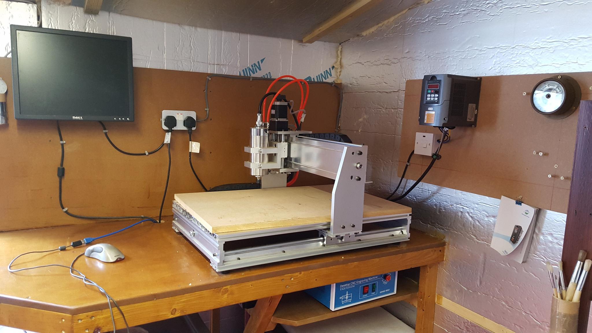

    I'm just trying to get started with my first cnc router , i got a chinese 6040 machine over 6 months ago but been waiting for supplier to sort the parts that did not work , serves me right for buying chinese off eBay :(
    I've cut some spoiler boards and what to surface the boards to make my cutting surface correct before i cut but what bit am i best getting here in the uk and how do i create the toolpath for such a cut and given tool , I'm using mdf for a sacrifice board.

    for MDF almost any tool will work - it is very easy to machine.
    Just try to get a rather large diameter to save time - it also has the benefit (or disadvantage depending on how you see it) that you'll immediately see if your spindle is aligned perfectly perpendicular in relation to the machine bed. If the tool leaves palpable marks the spindle should be aligned until the marks disappear.
    Creating the toolpath is simple: just draw a rectangle of the required size and create a pocketing operation. You can e.g. do this with Estlcam:

    Wide cutter will give you perfect finish if trammed correct and take fraction of the time.
    Wouldn't get a fly cutter these spindles don't like them. Get one of these with indexed tips http://www.wealdentool.com/acatalog/...nning_928.html
    Or if on budget one of these. http://www.wealdentool.com/acatalog/..._Wing_250.html

    I've ordered a bit to get me started http://www.wealdentool.com/acatalog/..._Wing_250.html

    i have thought about putting one of those on my 6040 rather than use the std breakout board in the blue box, it does seem to work but many say the electronics can cause problems, I'm hoping the drivers and steppers will be ok in mine for now they are
    leadshine microstep drivers
    dm542-500
    and
    sumtor nema 23 57hs7630b4d8 1.8deg 3amp
    it has a 1.5kw spindle that seems reasonable build quality ( but time will tell i guess)
    i have replaced all the stepper wiring and cooling hoses as they were junk and had bad connections
