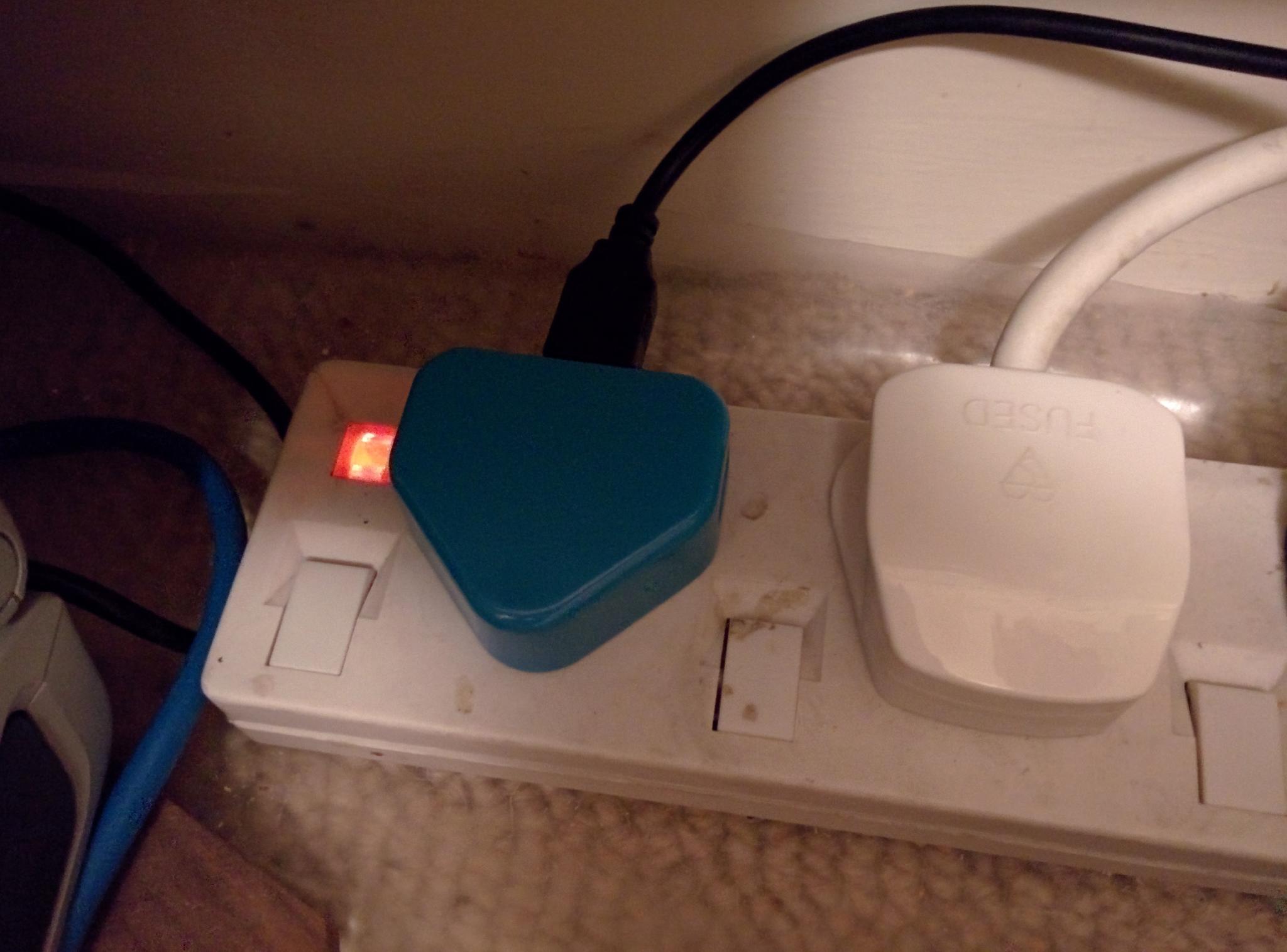

    Also, you you guys think it's okay to use one of these generic phone chargers to power the ESS? I don't know how clean the output is, but it does give 4.9V and power up the ESS.

    Hi Tenson, I am Andy from Warp9TD.com, the guys that make the ESS SmoothStepper.
    I will reply to this post first, since it is shorter and simpler. There have been more than a few people that have used phone chargers successfully. The biggest issues are:
    1. Does it supply a stable voltage? (Easy to verify if you are within 4.5v to 5.5V, but preferably within 4.75V and 5.25V)
    2. Can it source enough current? (Easy to verify if it can source 0.5 A at 5.0V)
    3. Is it old and flaky? (Weird thinks happen like random drop outs...)
    Here are the specs and FAQ that will help you and others answer those questions.
    I will write another response to your first post now.
    Thank you!

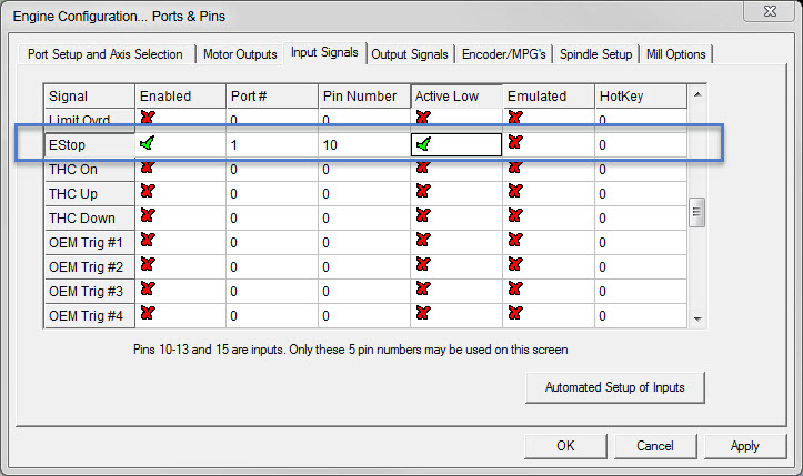

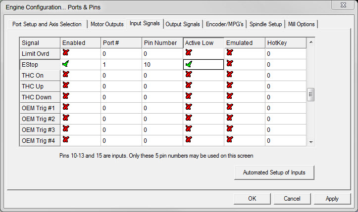

    The EStop pin issue is something I will be removing from the plugin. When I wrote the plugin I was concerned about the ESS knowing that an EStop happened. In the meantime, I would recommend assigning EStop to an unused pin, such as Port 1 Pin 10 and making it Active Low. Any of pins 10, 11, 12, 13, and 15 of Port 1, 2, or 3 will work.

    This is in Mach3 -> Menu -> Config ->Ports and Pins -> Input Signals.

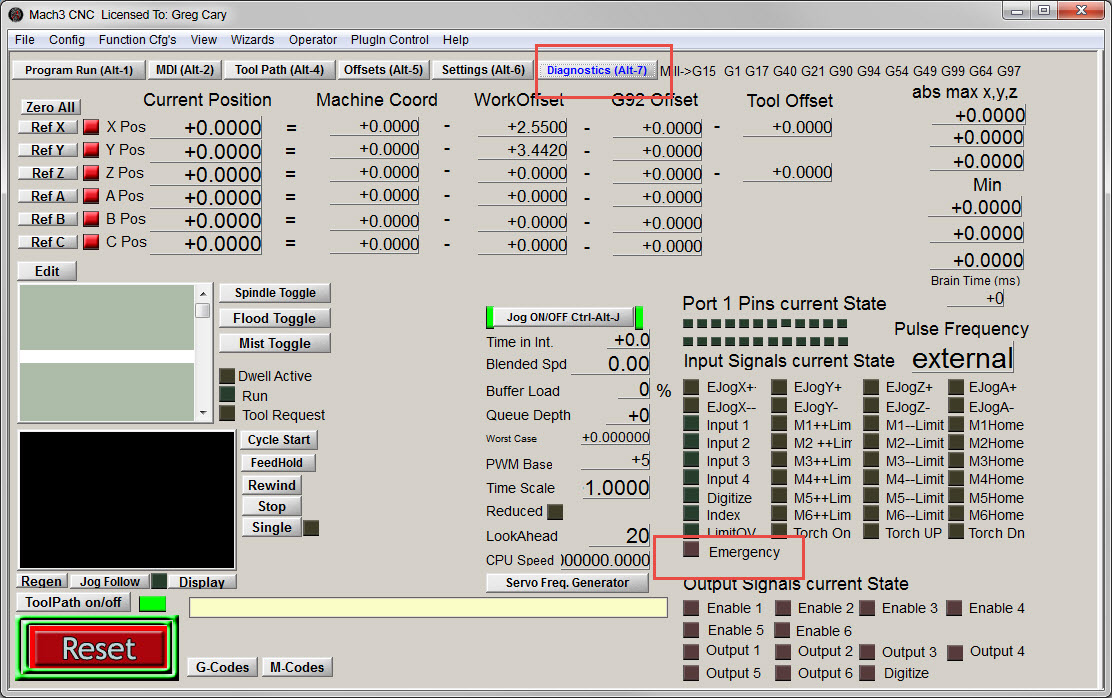

    Once you do this, you should see the Emergency light go off in the Diagnostics tab:

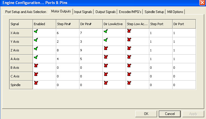

    Your pin assignments for the motors look OK. The ESS uses the same dialogs as Mach, so just enter the same values for the ESS.

    Thanks for your help Andy. I got it working!!
    I first had to set an input pin for the estop in the 'ports and pins - inputs' menu in Mach3 as you said. I just set it to port 1 pin 1, which is otherwise unused. Then it let me get on with other setting up.
    I put my same old settings into the Mach3 'output pins' menu for motors and hey presto I got motion :)
