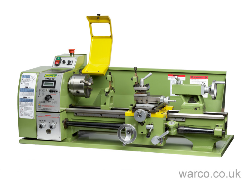

    Well I visited the Warco open day last weekend and finally ordered a lathe !
    I had narrowed my choices down to the WM250 (£1195) and the WM250 with invertor (£1475). I started asking a few questions and asked about the special offer on their website for one of the lathes (free extra goodies which I wanted to buy anyway). Turns out that the offer would apply to any of the lathes above, plus they would offer a show discount.
    So I asked for them to be run up. The WM250 has a DC motor with variable speed control and gave a constant hum all the time which although not loud could get annoying. However the WM250 invertor had a VFD control and sounded much nicer straight away. I also asked if the invertor had terminals to allow separate control of speed, direction etc. (thinking of a future CNC conversion) and the salesman paused as I don't think he'd been asked that before. The lathes were tight against the wall so we couldn't see round the back to check.
    I asked to price up the WM250 invertor lathe including the offer and discount and I got the follow list:
    Lathe (with all the usual bits - 3 jaw, 4-jaw, faceplate, travelling and fixed steadies etc.) (£1475)
    Live centre, set of 9off 12mm indexable tools, tailstock chuck (£113) (these were the 'free offer' bits)
    DRO 2 axis read out with 500mm and 100mm scale (£280)
    Nice parting off tool with insert (£33)
    QCTP including small modification to make it fit (£140)
    This would have been £2041, but the offer total was £1648 ! Well that was an easy one. So now I have the WM250 invertor model on order with all the above bits. This comes with the power cross feed as well, although it still only has the single main feed screw on the saddle. As I plan to CNC convert it with ballscrews at some point neither of these things matter but I suspect that will be some time away.

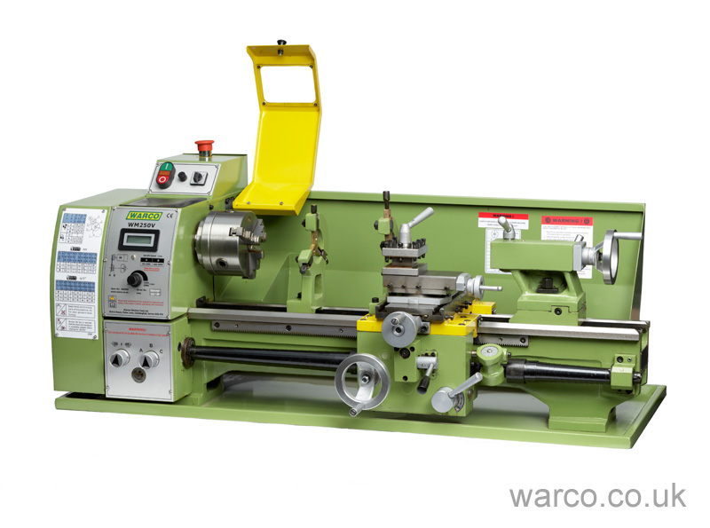

    So I've cleared one of the benches, just need to wait for the order to arrive now (some items on back order). Meanwhile, here is the stock photo:

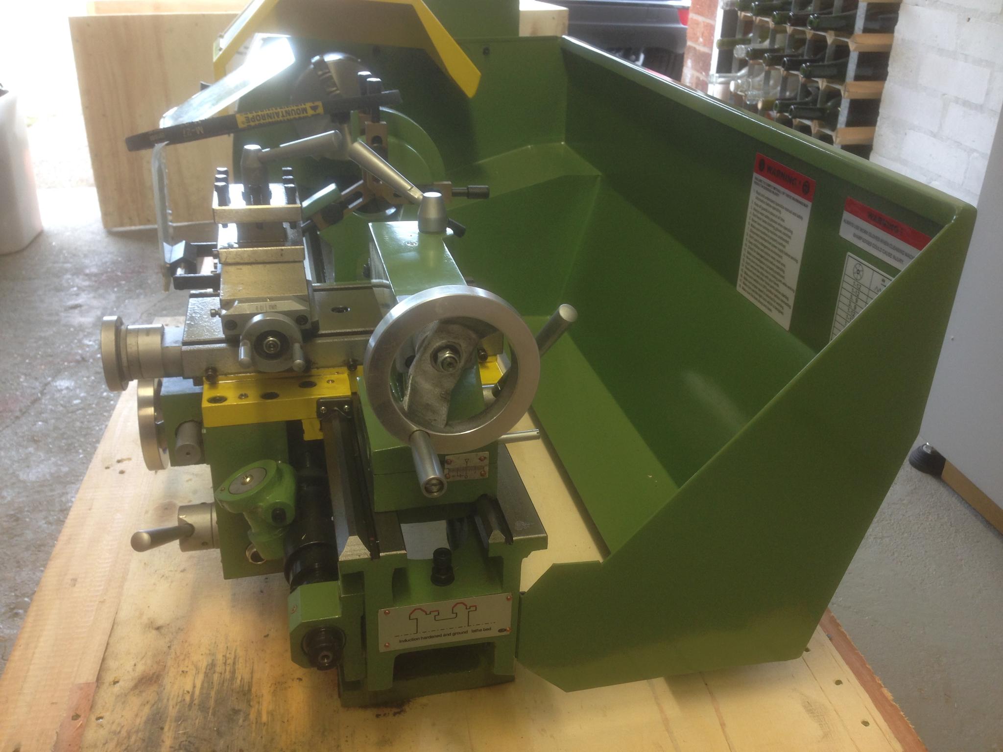

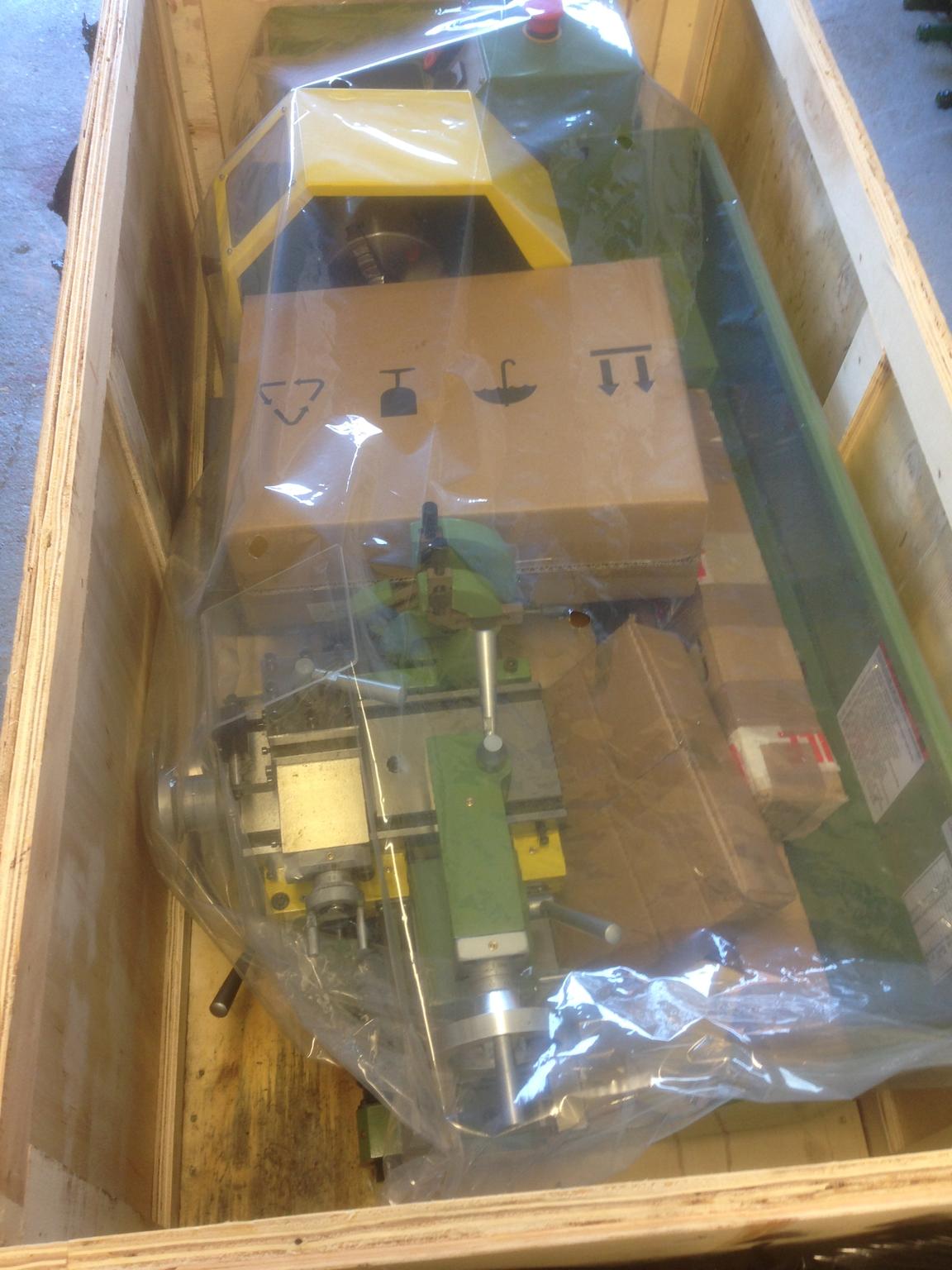

    It arrived in a big wrapped wooden box:

    Levering off the lid revealed the well packed machine with all the accessories:

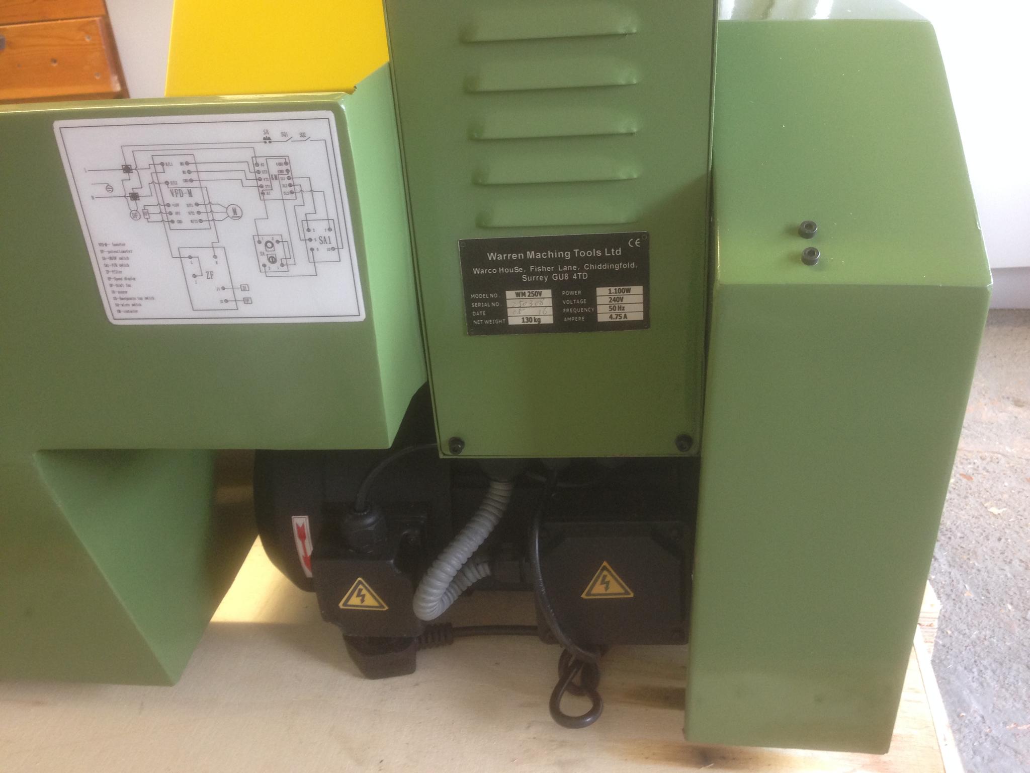

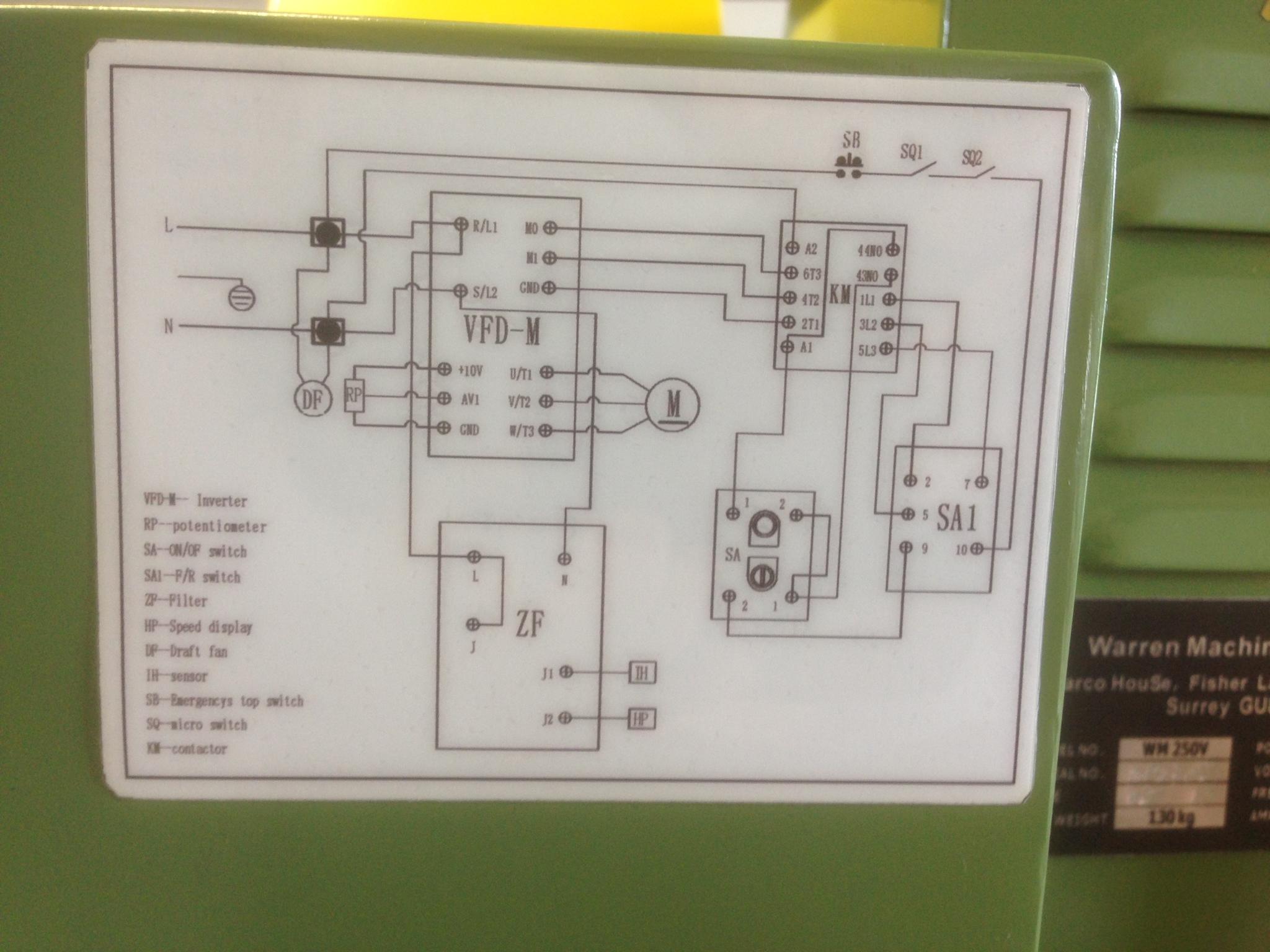

    The invertor is behind this cover. A branded model, with a branded contactor, so bodes well:

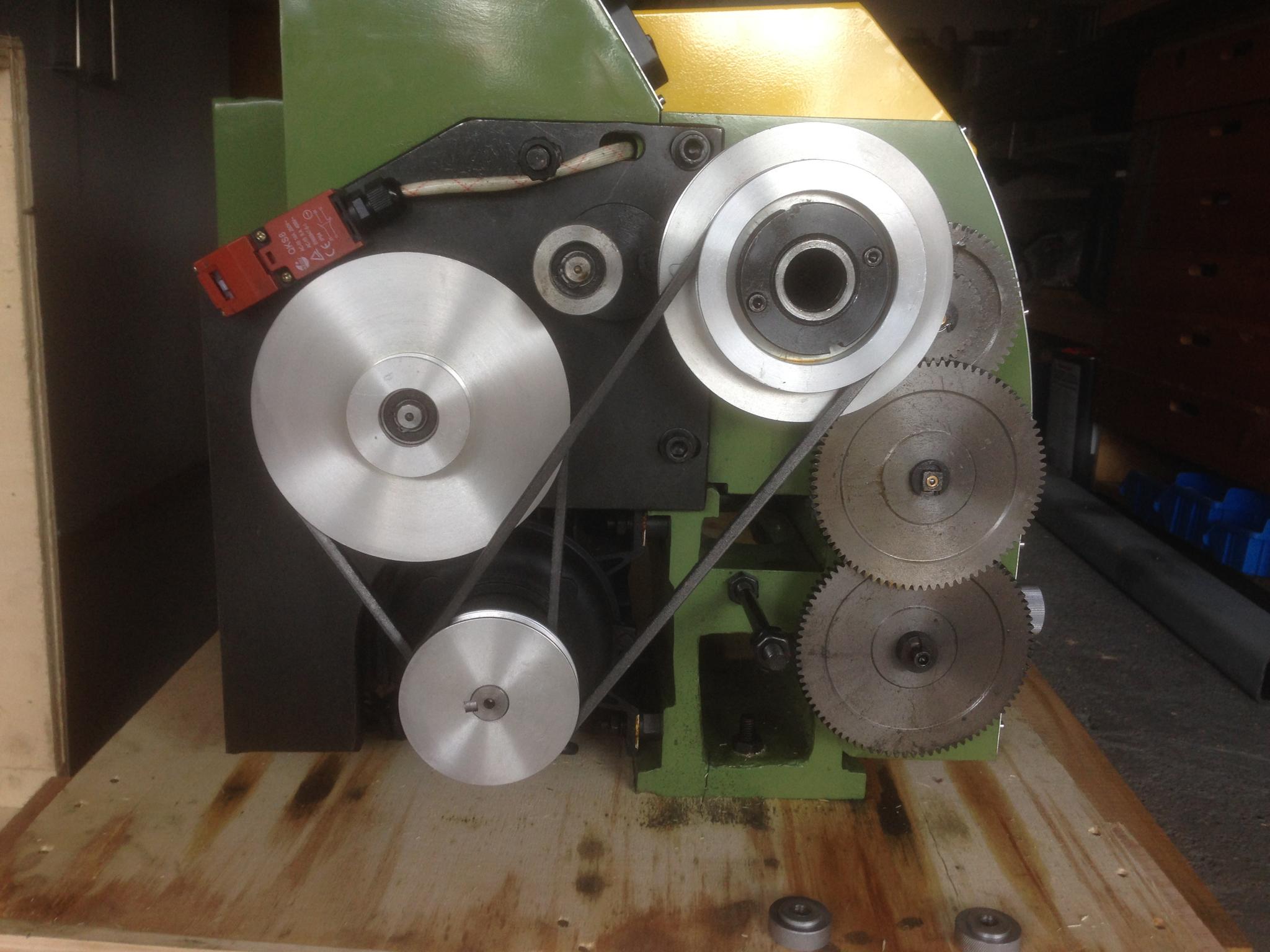

    A look behind the end cover panel:

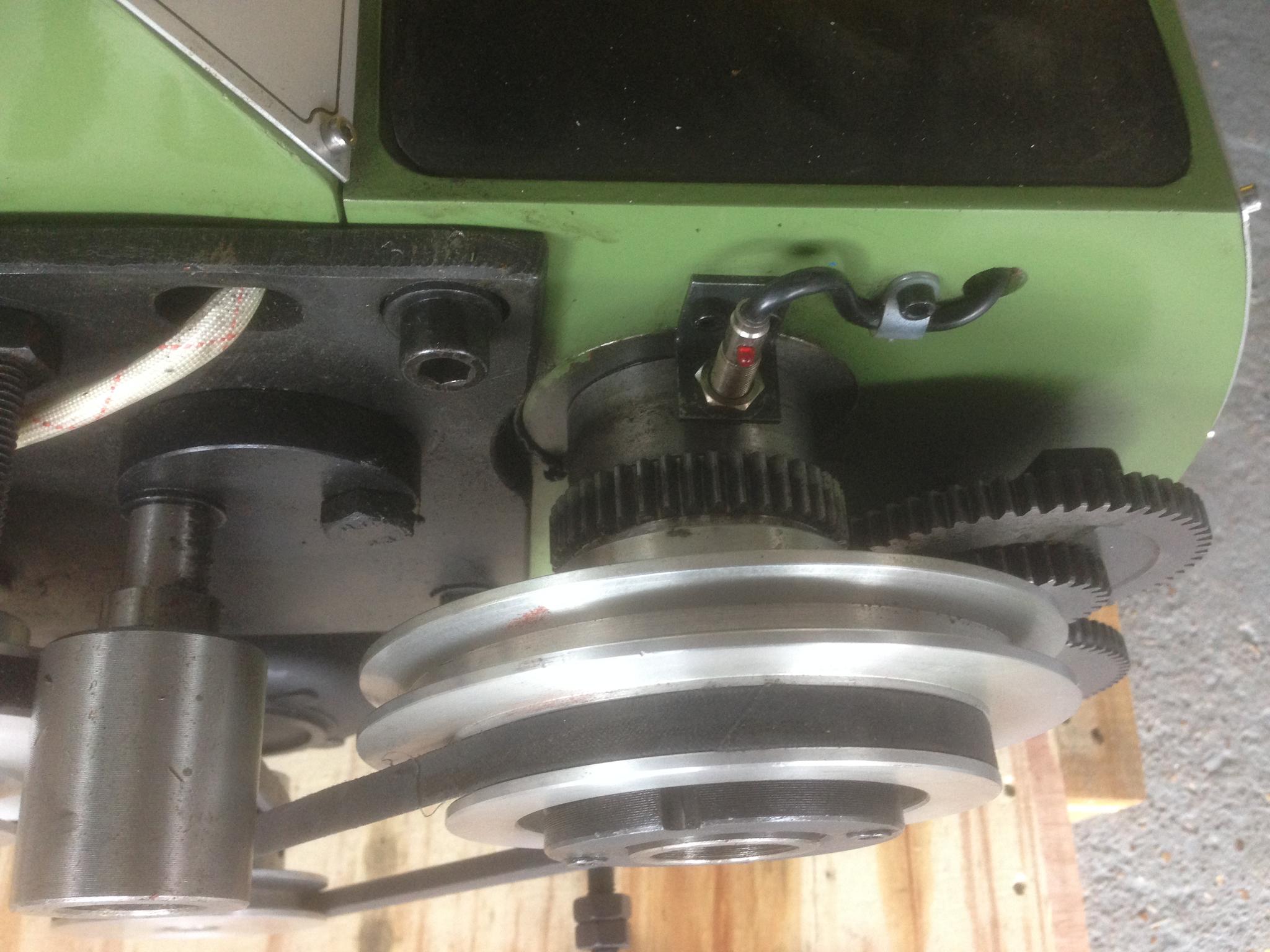

    Sensor for the rpm readout (there is a once-per rev small metal rod sticking out of the shaft):
    Should be quiet easy to add a multi-pulse index wheel for cnc threading (at some far distant time!)

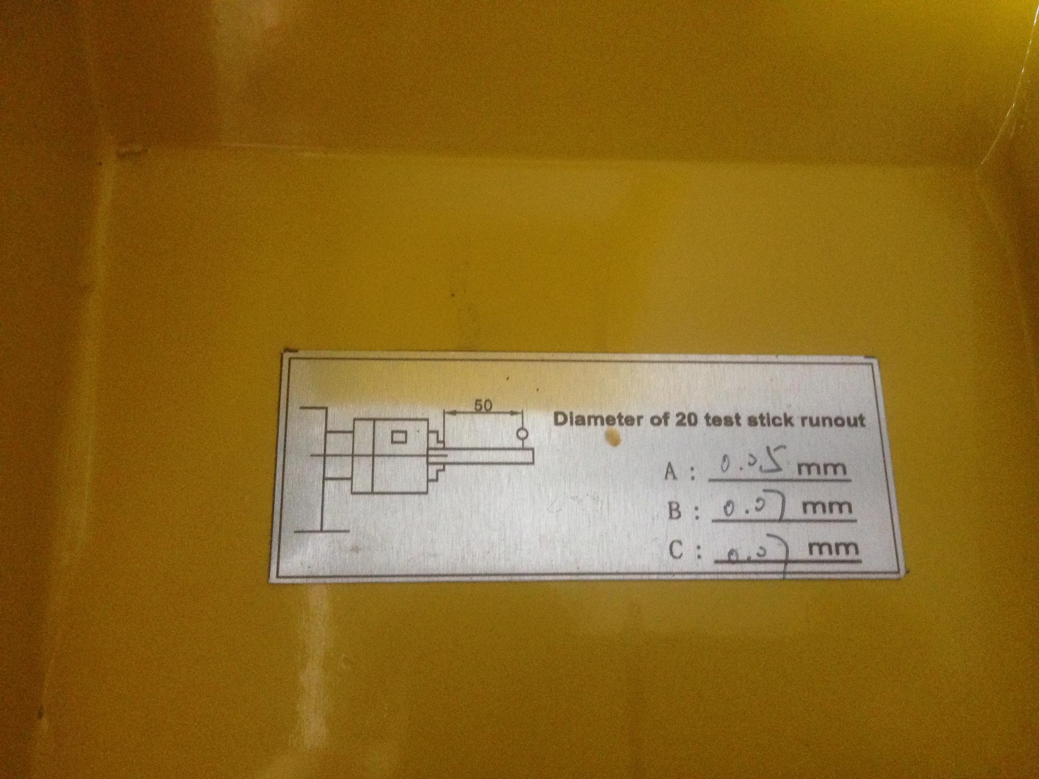

    Declared run-out not too bad (will check if this is accurate later):

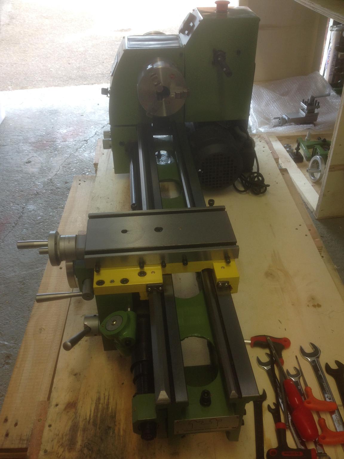

    Started stripping off some of the parts to make it lighter and give better access to fit the DROs:

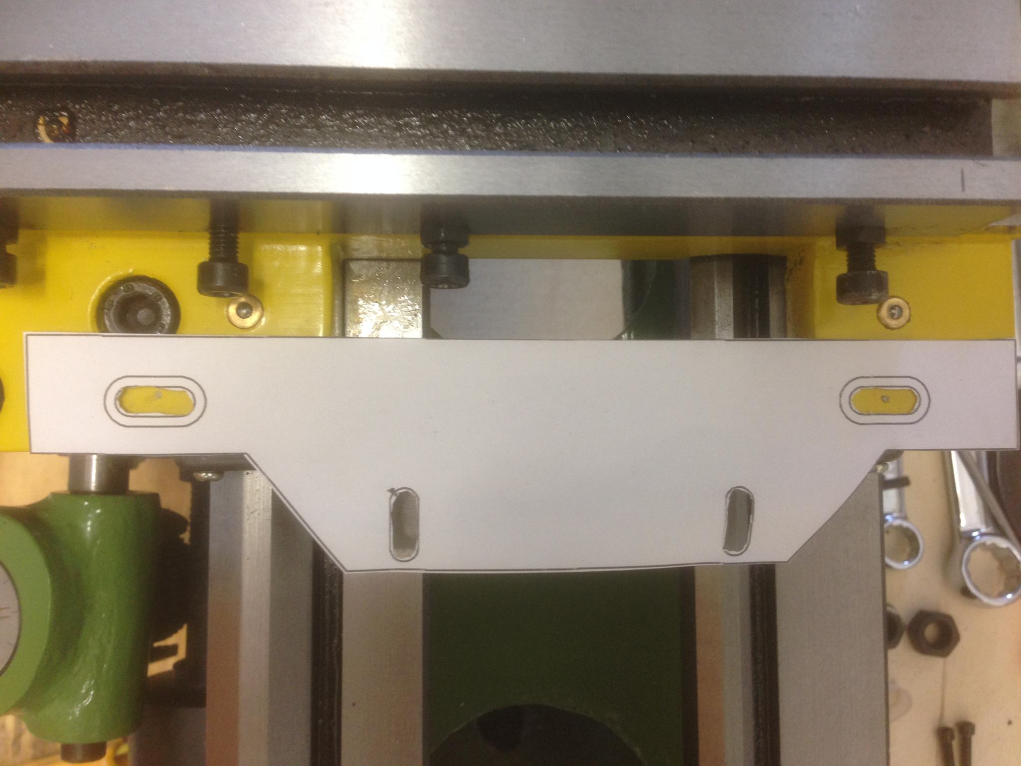

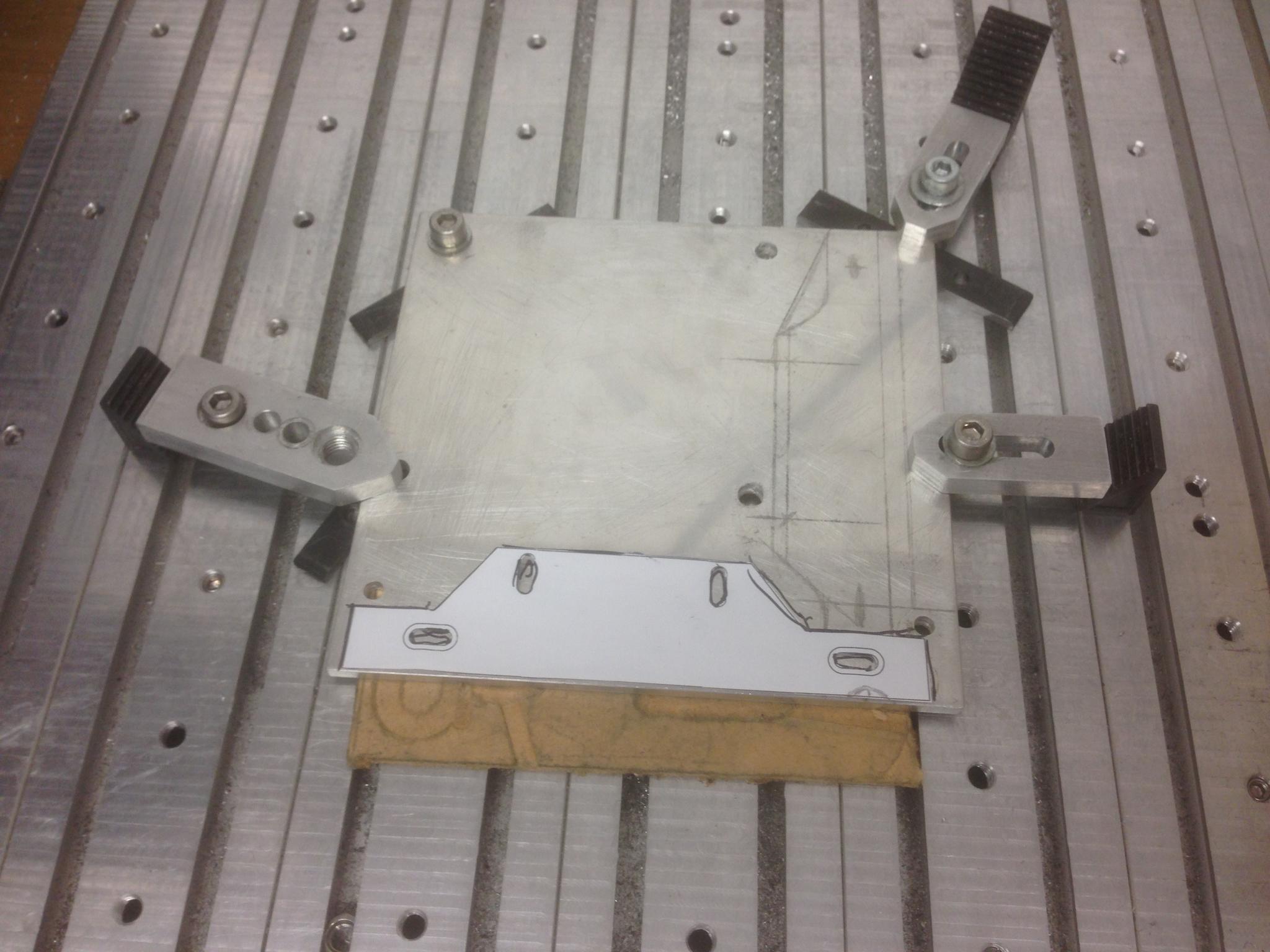

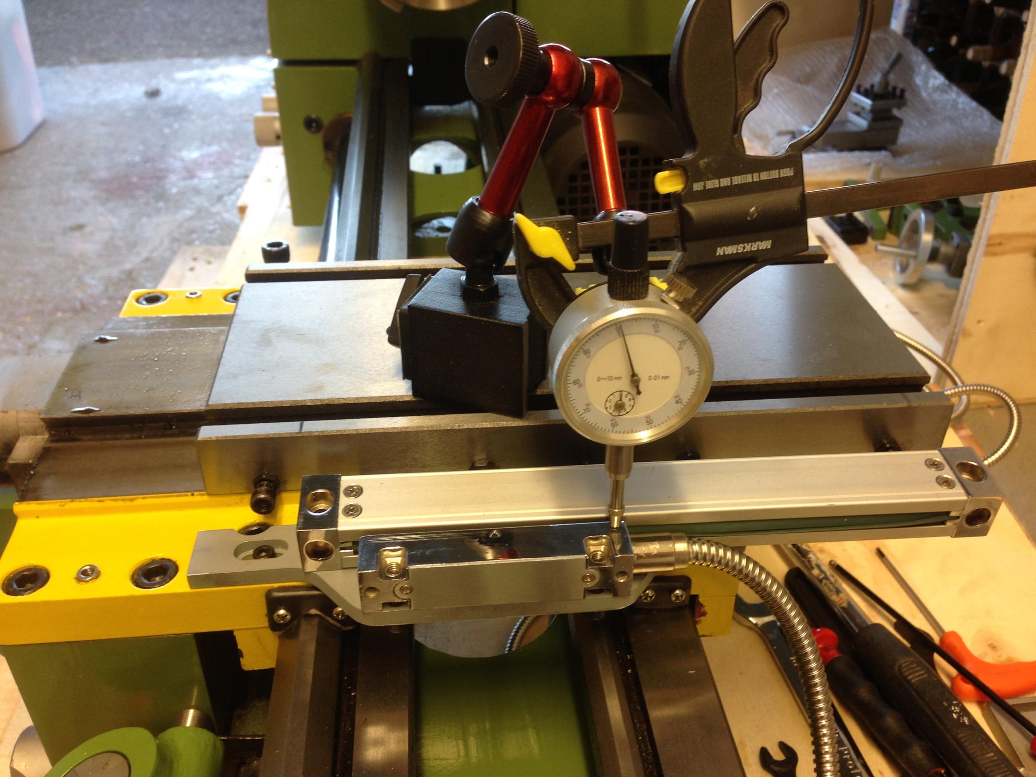

    Started on the cross-slide DRO. A bit worried that the one supplied for this machine is 100mm travel but the cross-slide travel is about 115mm. Admittedly it probably won't go right to the back of the machine but if in the future I forget it could damage the sensor. I'll ask Warco about it this week if I get a chance. May have to limit slide travel.
    I can't see any way to make the standard brackets which come with the DRO fit. The slide has to be stepped back to give access to the saddle lock cap head (and clear the gib lock bolts), be low enough to miss the top slide, and the read head has to be positioned so that it can travel the whole range. This puts it in the middle of no-where. So, made some measurements and did some CAD. Printed it out as a trial fit:

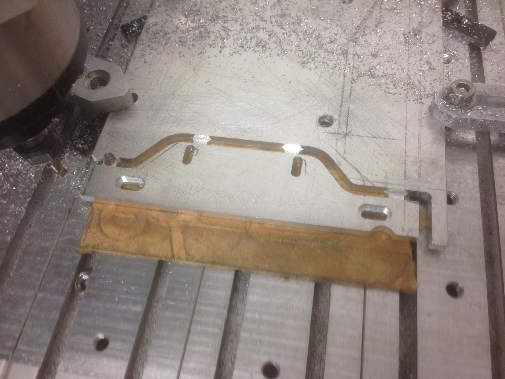

    Setting up some 6mm aluminium plate:
    Done:

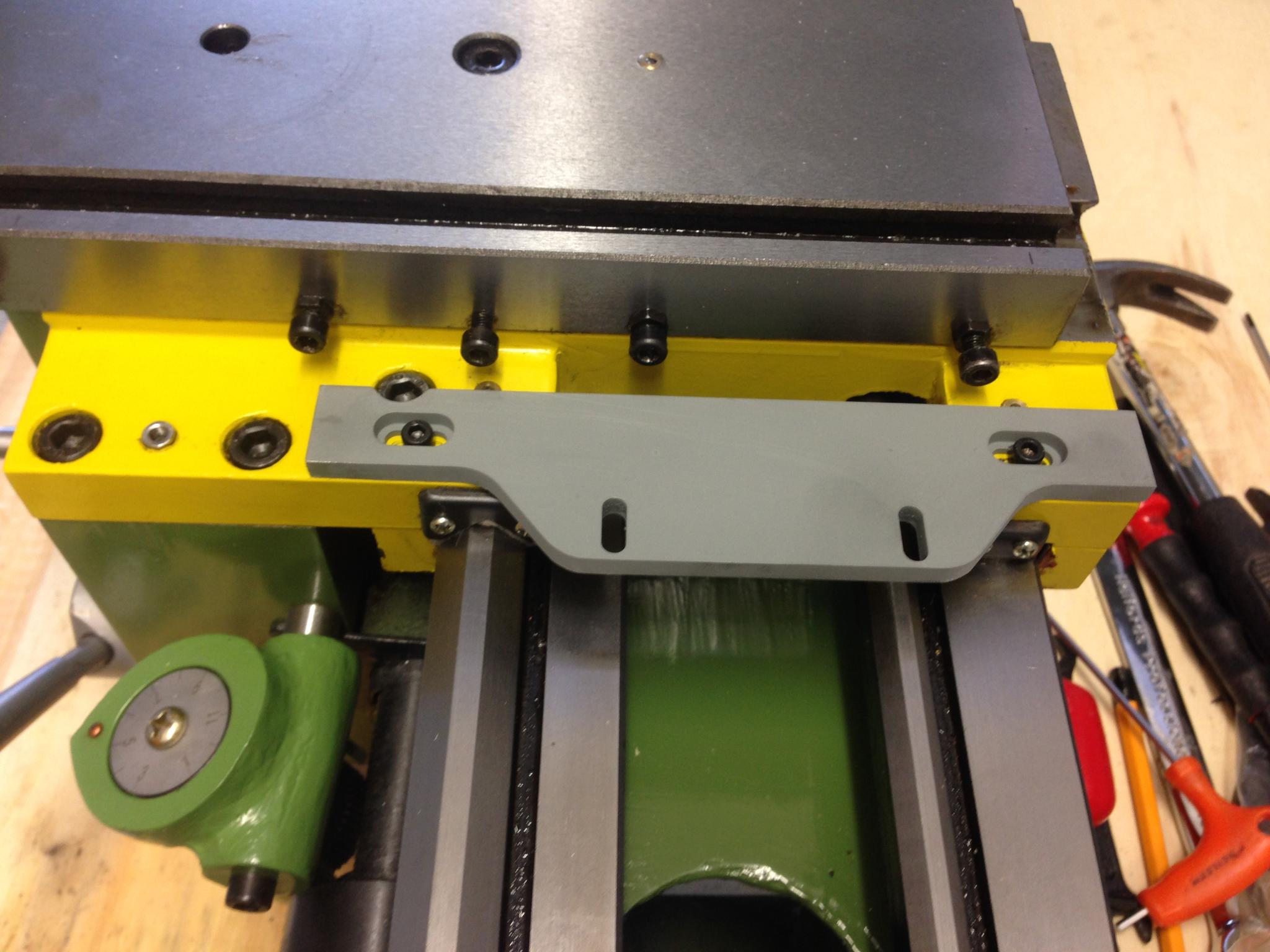

    Light coat of Zinc spray, drilled and tapped the carriage (M4) and offered it up:
    Starting to dial in the read head bracket. So far looks like it needs about 0.4mm shim on the left. Note that the main body is NOT attached to the slide yet, it's just loose on the reader. Once dialled in vertically I'll do the fore/aft dial in using the slots in my bracket.

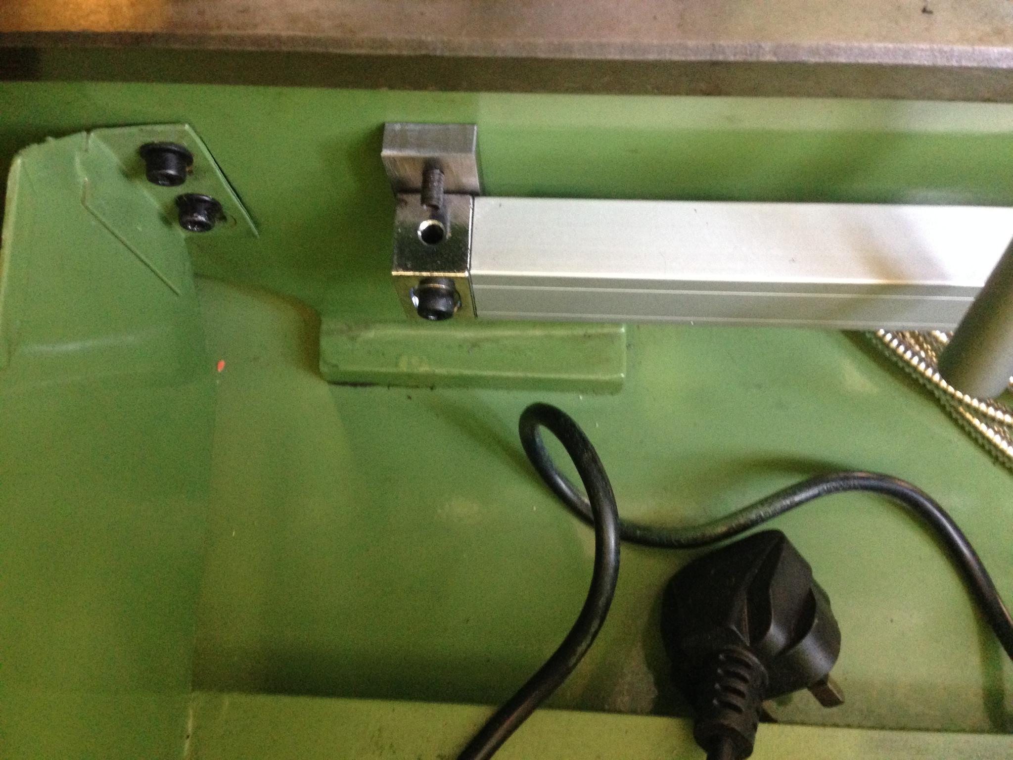

    This is in the same position as the Warco display model but I do need to be careful that the tailstock does not get slammed into the back of it during use. It will hit the 6mm bracket not the sensor itself but it is only secured with 2off M4 into soft cast iron so could do some damage. Maybe add a rubber bump stop on the tailstock front edge?

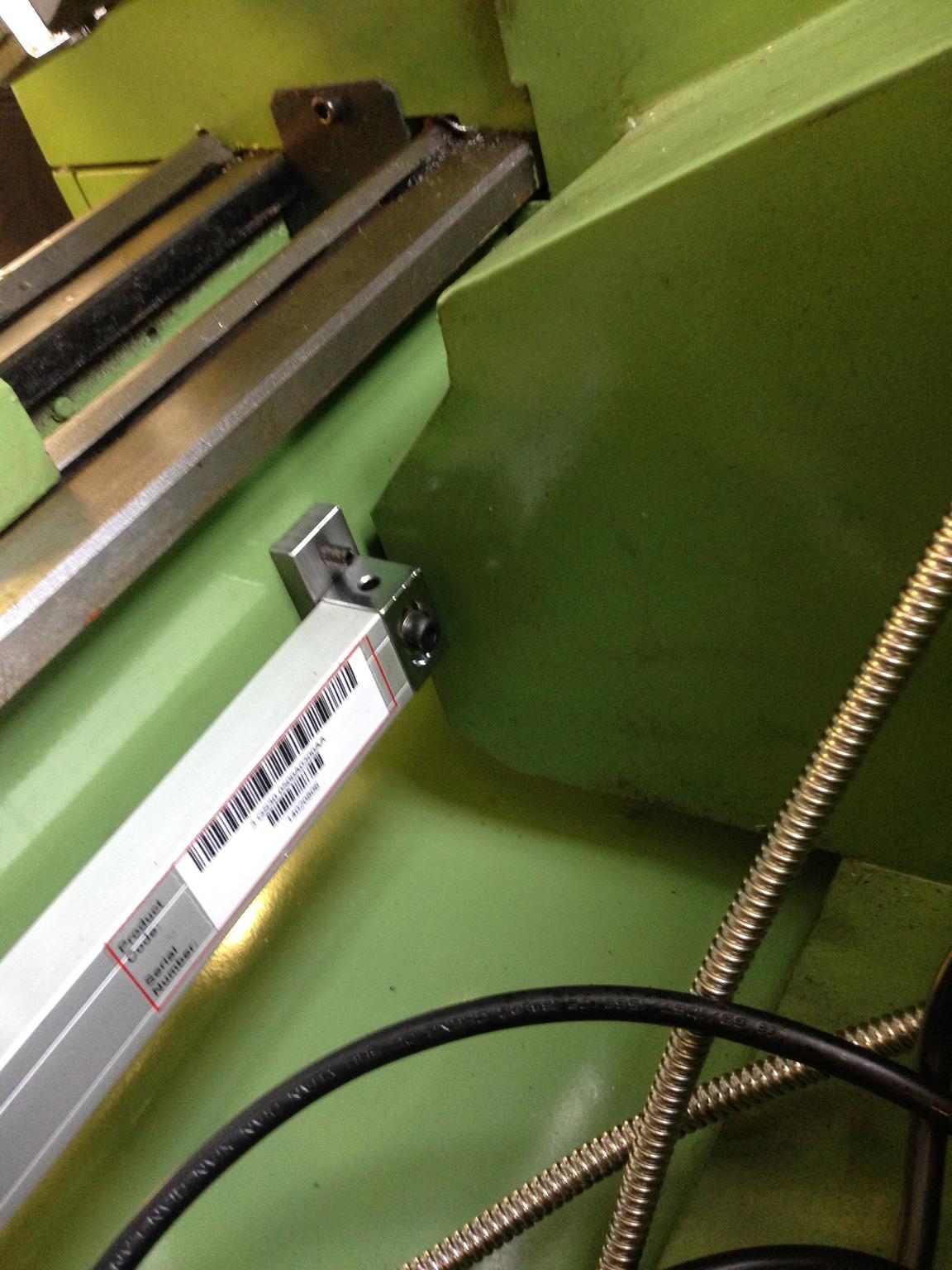

    Thinking ahead I had a look at the longer DRO for the Z axis. Since this mounts on a non-machined surface it needs to be levelled. I was disappointed that the kit did not come with levelling blocks so I'll have to make my own.

    I note from photo 3 that they are still printing "This Way Up" arrows on the wrong face of the box...
