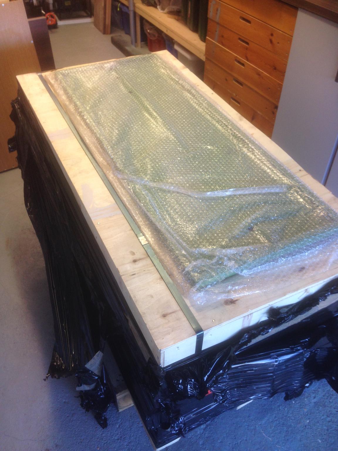

The lathe arrived this week - hurray!
It arrived in a big wrapped wooden box:

The drip tray was on top in bubble wrap:

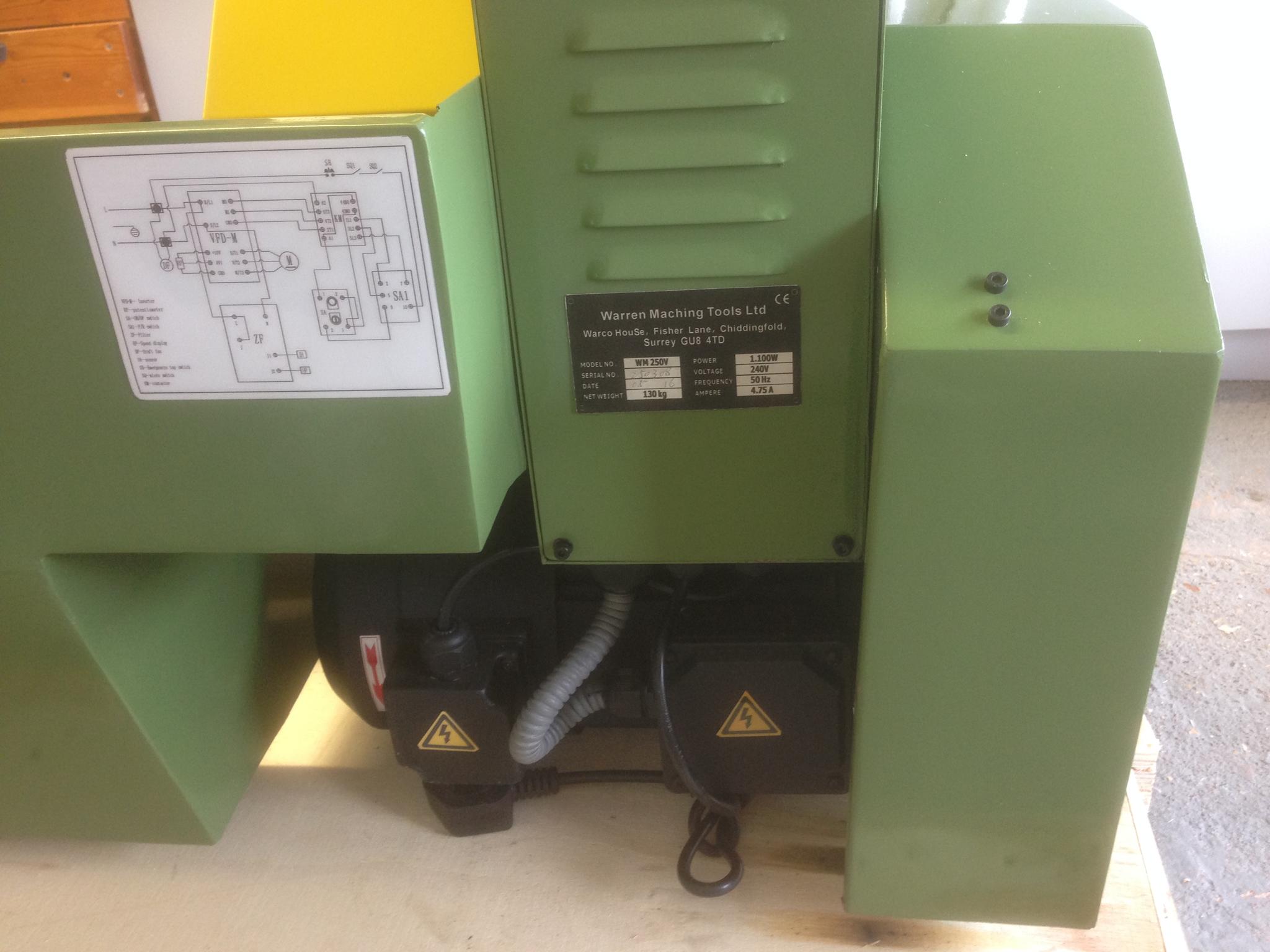

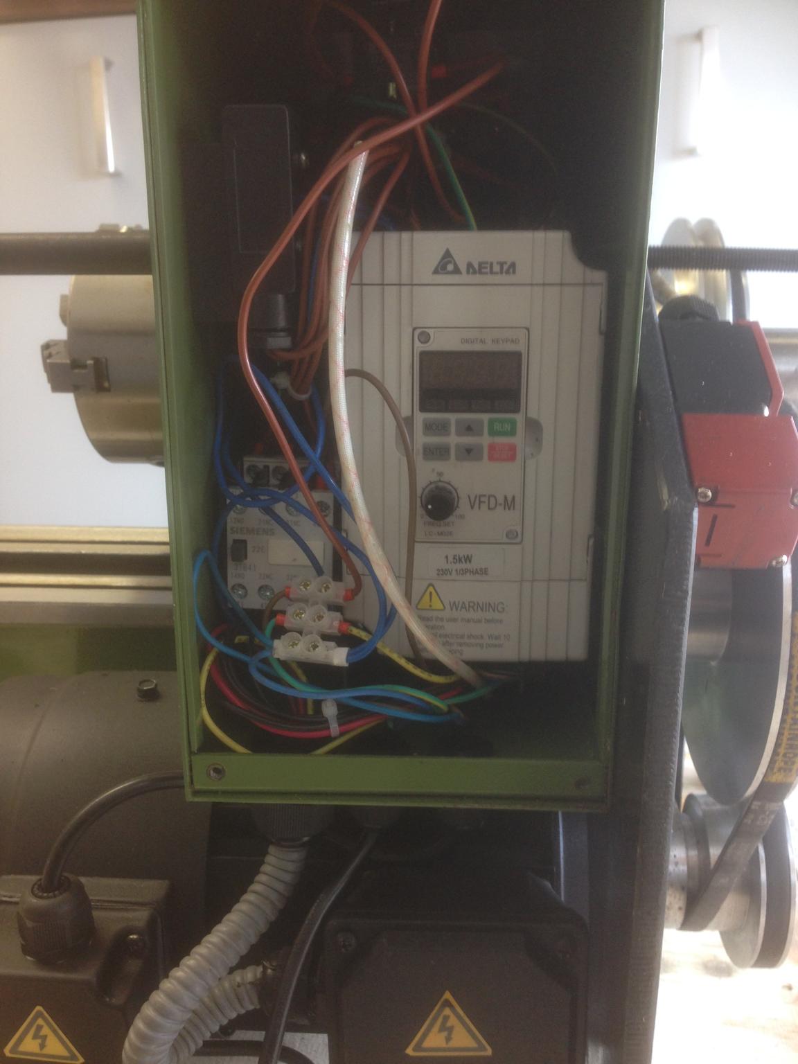

The invertor is behind this cover. A branded model, with a branded contactor, so bodes well:

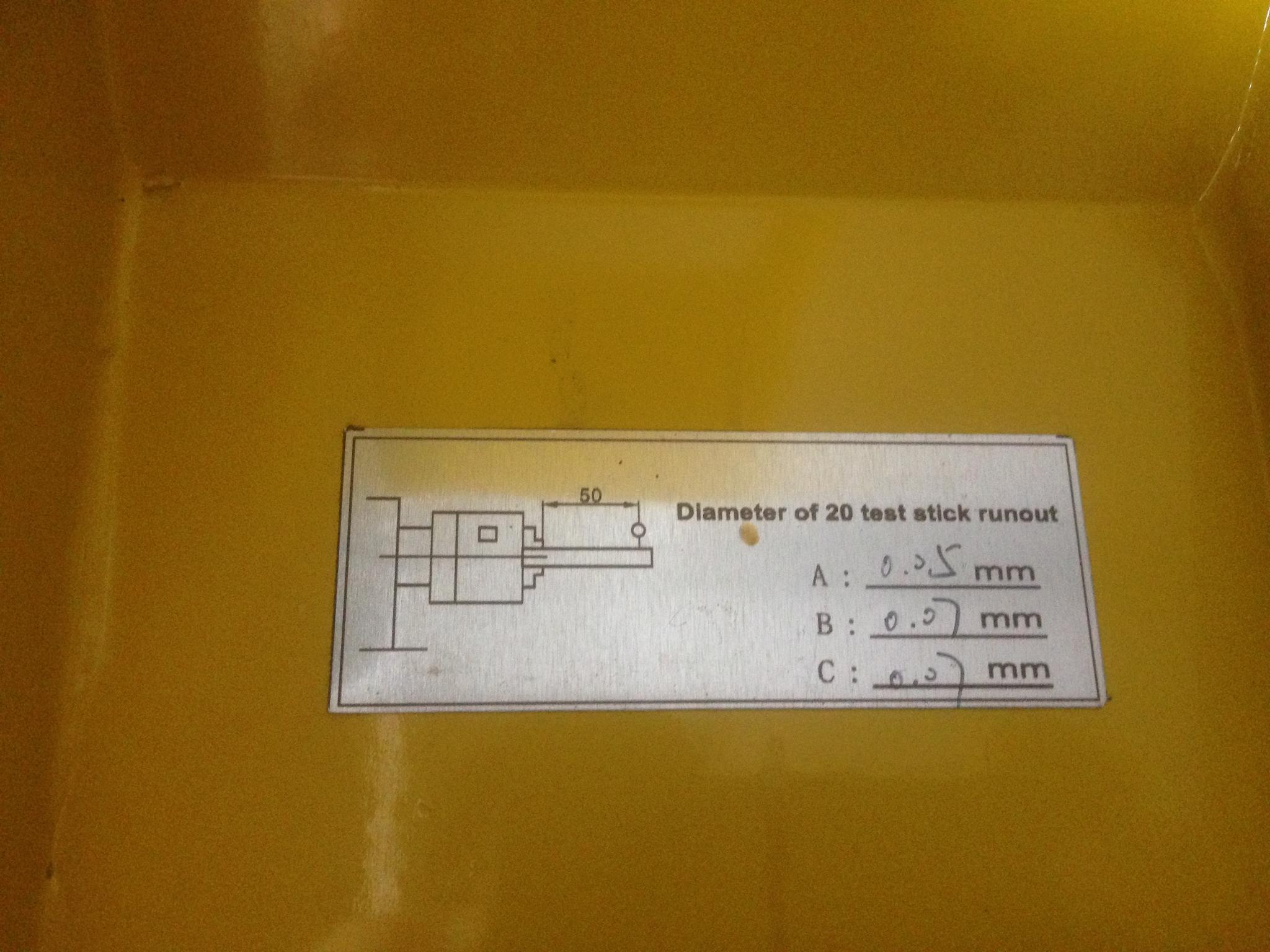

Declared run-out not too bad (will check if this is accurate later):
