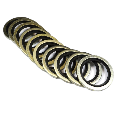

    Pretty sure it is dripping out the plug. The front face where the shafts exit is bone dry. Underneath there were lots of drips gathered around the plug. But I'll double check.
    Make a plug with a shoulder and use a Dowty Washer/Seal, job done! :D
    Regards,
    Nick
  4. #44
    You could try a copper or aluminium washer, or solder a steel washer on the shoulder and use an O ring.
  5. #45
    FFS, Dowty Seals cost pennies!
    Why would you bugger about with something else?
  6. #46
    Nice idea Nick - added to the to-do list.
    Found some M12 Dowty seals on e-bay £1.95 for 2. Need to check exact bolt size before ordering and I'll knock something up over Christmas hols.

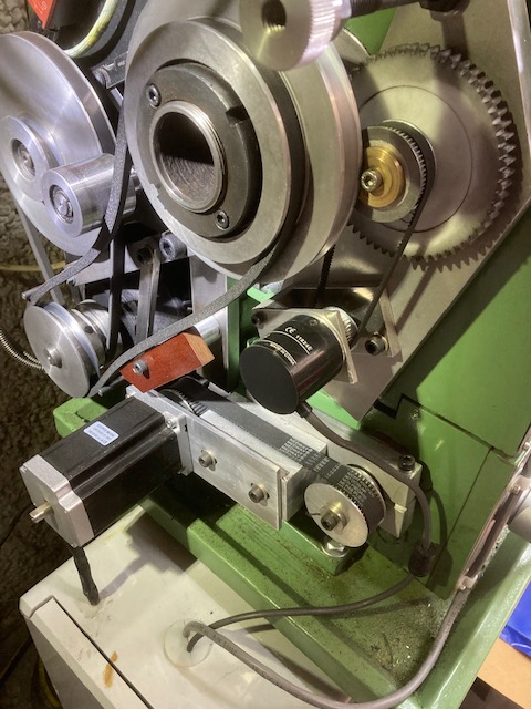

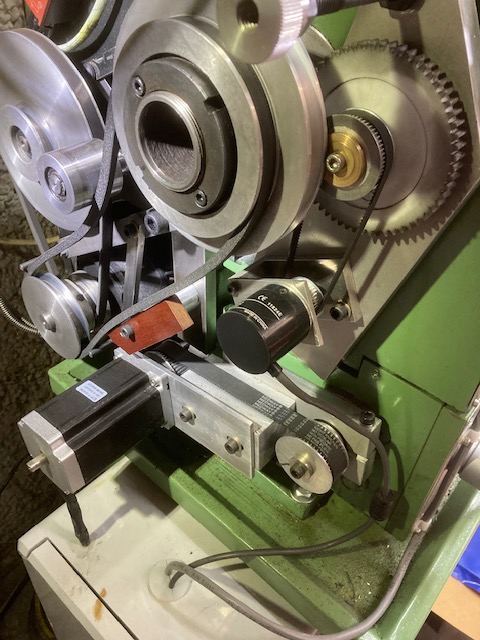

    Finally after a 6 month wait the microprocessor has arrived from TI. Time to get going on this Electronic Leadscrew Project!
    Big thank you to James Clough for all the R&D and working it all out.
  10. #50
ID:	31241 Hi, the attached image shows my electronic lead screw project on a Warco WM290V lathe.
    Hi everyone , I'm a new member just saying hello.
    Tony
    I have put a short video on YouTube regarding my ELS
    I have added a YouTube video showing my Warco 290V fitted with ELS
    Tony
    I am using a Nema 23 motor approximately 140mm long
