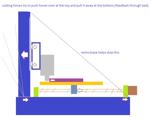

    Hi Robin, Lachlan,
    Maybe this helps explain it. If you remember the days of 'free-body-diagrams' - the bed is part of the system. See picture which shows all the forces acting.
    You can hopefully see how the extra brace can help. This is where myself and Jazz are coming from.
    I think Wal created something like this (although smaller) and grappled with different layouts to make sure the 'tower' was stiff enough.
    Can it work without the brace - of course. Is it much better with it ? - yes, significantly, and for little effort.

    HI EVERYONE,
    Was surprised and happy to see so many responses. Thankyou! I think the triangular bracing of the gantry is a must for this build it makes sense as a gantry triangulated is so much stronger than a gantry just flapping in the breeze so to speak. I have some 50x50x4 box steel surplus, would that steel cut the mustard for this frame build?

    But the diagram doesn't show the rails being screwed to the bed and the blocks being screwed to the gantry.
    The nut should be under the gantry and the screw moving with the bed.
    That puts the linear bearings permanently underneath the cutting head.
    Looks a bit odd, but if you draw it you will see enormous benefits.
    Hi Robin,
    Yes, I totally get what you are saying. Putting the bearings on the bed and the rails on the moving part makes good sense but it is maximising stiffness in the vertical Z direction. It is similar to the debate around conventional Z axis where it is often better to put the rail on the moving part for the same reason.
    However, the bracing on the tower is primarily to address stiffness in the X direction. I've re-drawn the sketch to show the moving rails and FIXED bearings but the forcing (for X direction) is still the same and suggests bracing of the tower is beneficial.

    There is also some Z direction stiffness from the bracing due to moment created by the offset of the tool from the tower in X which is independent of the rail / bearing arrangement.
