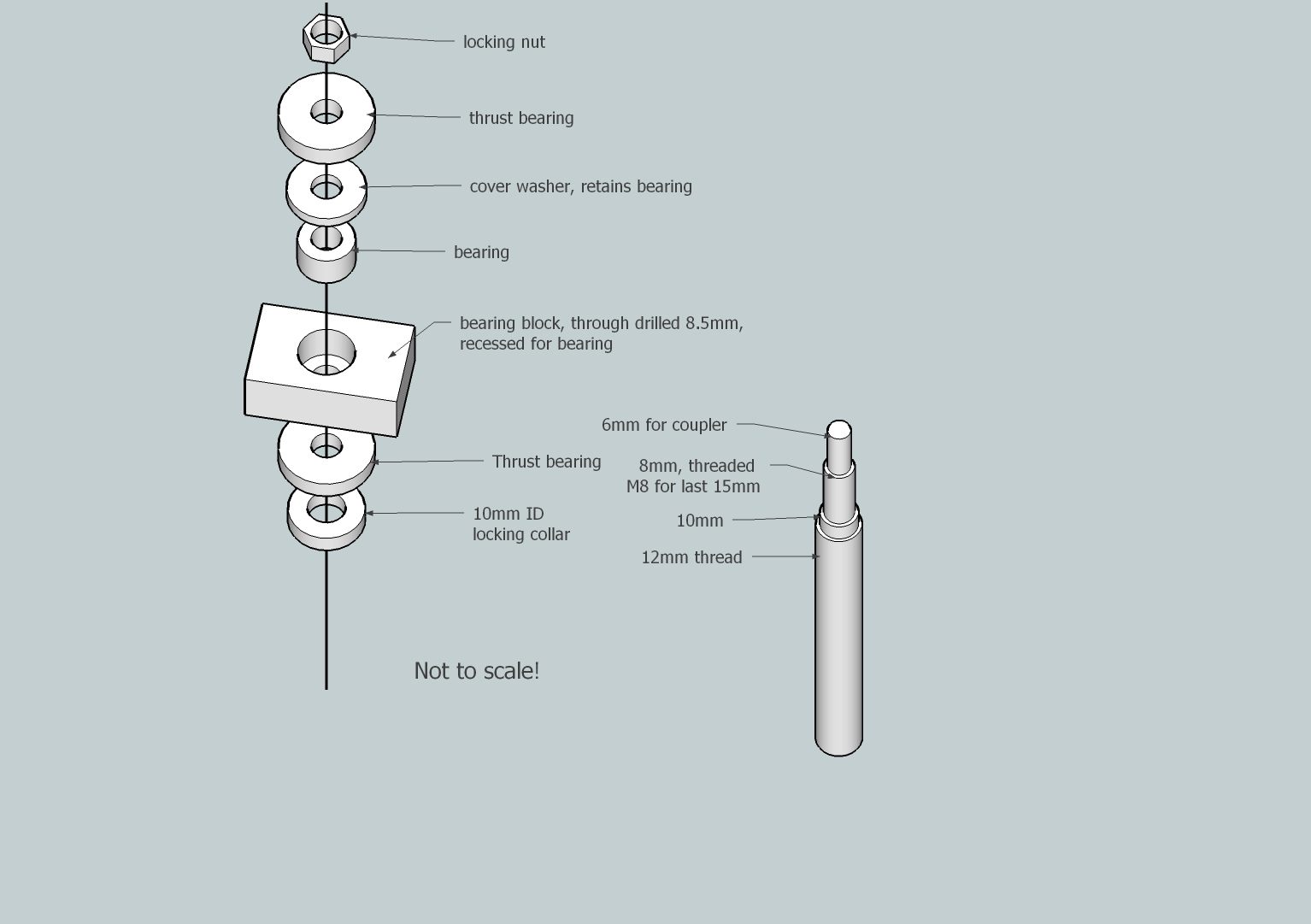

    the reason i am looking at this controller is that i have read that it is quite easy to blow a stepper driver, particularly when you dont know what you are doing. with this board that only means you need the driver board and not the whole thing as is the case with single board units.

  5. Quote Originally Posted by wires View Post
    i like that TR12x3. the price aint bad either, i might just go for that. it seems i will have to get the ends turned down to fit bearings and coupler. i will have to find someone local to get that done, might know a guy.
    You can turn them down with the help of an electric drill, a file and some emery paper and a couple of 12mm ID ball races in some MDF pillow blocks. Support the TR12x3 in the pillow block bearings, suitably spaced, the one at the business end leaving say 50mm showing. Chuck the far end in the drill and whizz it at 1000rpm, then use the file to shape the end to a near fit and finish with the emery paper, doing trial fits on the appropriate bearings or measuring as you go...
    You might find the use of a grinder to take the hardening off the surface helps, a dremel or similar is an alternative to a file and can be quicker...
    At least one member has used this technique successfully...
    Of course if you know a man with a lathe...
    i have been trying to think how i could do that myself, that sounds simple enough. i have a bench grinder and vernier calipers.
    i do know a friend of a friend who works in a tool making workshop, might see if i can call in a favour when the time comes.
    being a noob i am not sure what a pillow block is. do you mean a small square of mdf with a hole for the bearing? you then make a hole larger than needed in the machine chassis so that the pillow block can be moved to line it up perfectly?
    also, if i am going to get some thrust bearings i need to understand them a little. my understanding of thrust bearings is that they handle the load laterally along the length of the screw but they have no ability to handle side to side loads. do i need a ball bearing and a thrust bearing in each pillow block or am i missing something?

  7. Quote Originally Posted by wires View Post
    ...being a noob i am not sure what a pillow block is. do you mean a small square of mdf with a hole for the bearing? you then make a hole larger than needed in the machine chassis so that the pillow block can be moved to line it up perfectly?
    A pillow block is just a bearing mounted in a carrier, usuall cast or pressesd steel with ears to bolt down with. you can buy them ready-made or, for this purpose, two 12mm id races mounted at equal height in some blocks of MDF screwed to an MDF base will suffice... its only to provide some support for the leadscrew while its being worked on so moderate accuracy only needed...
    For the actual machine you need a bearing block which retains the leadscrew radially (ball race) and axially (2 x thrust bearing), alternately you'd use 2 x angular contact bearings but these are hard to find in small sizes. See the pic for a guideline
    ah i see. so if it is supported by thrust bearings either side of a ball bearing on the drive side of the screw there is no need for a thrust bearing on the other end, just another ball bearing. i think if i am going to go that complex on the machining of the ends of the screw i will just get someone with a lathe to do it right.
    thanks for clearing that up for me, i was wondering how exactly i would do that. one more thing decided
