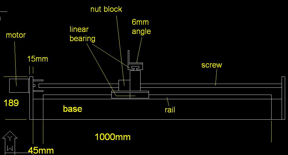

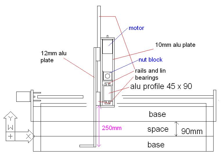

    right just made some stuff up on autocad,
    im not sure how heavy the z axis will be tho as it uses a lot of 10mm plate.
    Any thoughts?
    thanks

    thats easy... work out the total surface area of the 10mm plate used in square millimetres (just work it for each piece then add them all together), multiply the result by the plate thickness (10) and multiply by 0.00275 will give the weight in kg. (weight of aluminium is 2750kg per cubic metre)
    Hi Kev.
    just 1 observation. Are you only using one rail on the y axis? if so then the 250mm travel + the distance to the rail + the length of the cutting tool will put quite a bit of force on it!
    Good luck with the build.

    Hi Kev.
    hi, no i was thinking of using one rail on the top and one one of the bottom, tho im going to redesign the z axis so that the motor is not so high up, possibly mount it on the other side of the alu profile, offset the weight a bit. im also thinking of keeping the linear bearings fixed and letting the rails move up and down on the z axis instead, this should keep 250mm of 12mm aluminium sheet fairly rigid.
    Its hard designing things , might just order lots of bits and make it up as i go haha
    Sorry didnt notice the label tag was dog legged through the lower one.
    Good idea to fix the blocks and let the rails move up and down on the z axis. Are they 4 way equal loading? Thats how I'm going to do it on mine. I would allow for a least a 1/3 of the rail to be held in the blocks. So for a 250mm travel you would need 375mm rails.
    If its just for sign making then do you need so much travel? Why dont you just use the stand idea but have different size collars to rise it up in increments. Some people have also used multiple mounting heights on the z axis plate to allow for the cutting tool, might be worth looking at.
    Yes but isnt that the fun part.
    Yes i think the bearings are 4 way equal loading, they are adjustable as well, theres a close up picture of one in my gallery.
    It is supposed to be for sign making and would actually only require about 10mm of z travel but i want to cut big things inside of it lol, i might not go for 250mm of z travel i think i will test it first, see how much flex there is.
    I have ordered some 45x45mm box section and some more rails so i think i might try the make it up approach until i come up with some good ideas.
