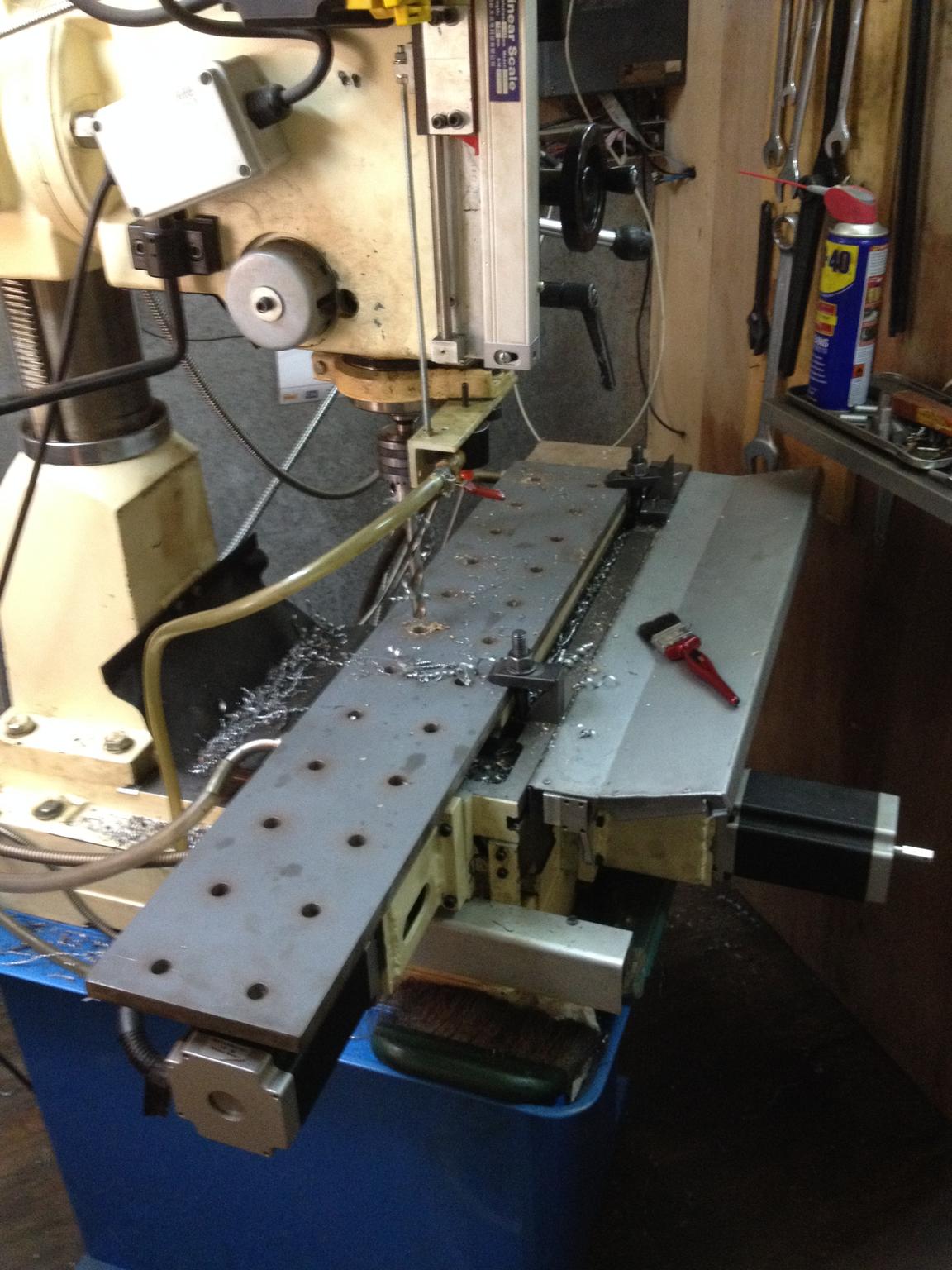

    Thought I might share my journey of modifying my RF40. I bought this machine from Axminster tools and shipped it to the UAE where I am currently working. The machine had to fit into a 20ft shipping container which was converted into a workshop - so I was limited on the size of machine I could use. It soon became apparent that this mill has many limitations - which I have slowly been whittling away at.

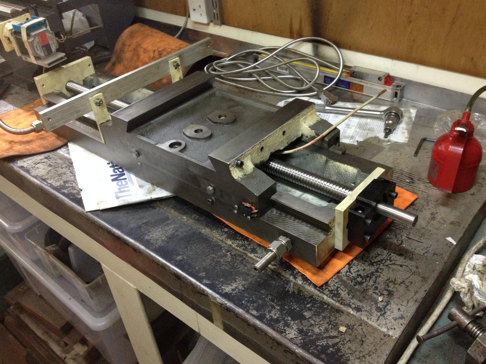

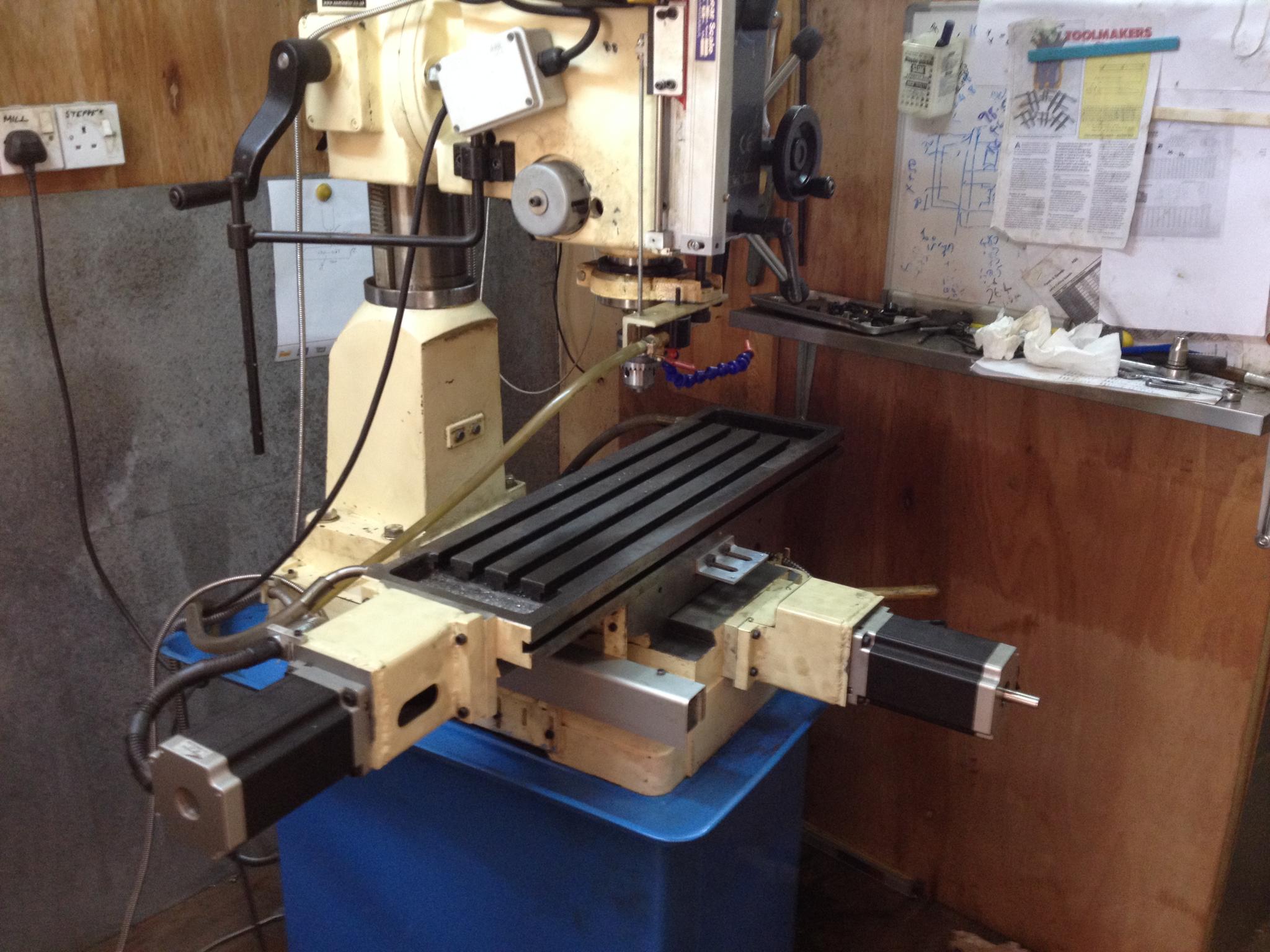

    The backlash on the leadscrews was so large that using the dials on the axes was no good for anything requiring precision. The first modification was to install linear scales (bought from China on ebay).
    It wasn't long after that I decided to fit stepper motors (also bought from China on ebay). I used a kflop CNC controller which helped to reduce the issues with the leadscrew backlash using feedback from the linear scales.
    The first photo shows the mill in this configuration (sorry - I'm rubbish and remembering to take photos).

    The Z axis drove the drill downfeed via the rack and pinion mechanism built into the mill. This was hopeless under CNC control due to the backlash in the mechanism. More of that later....

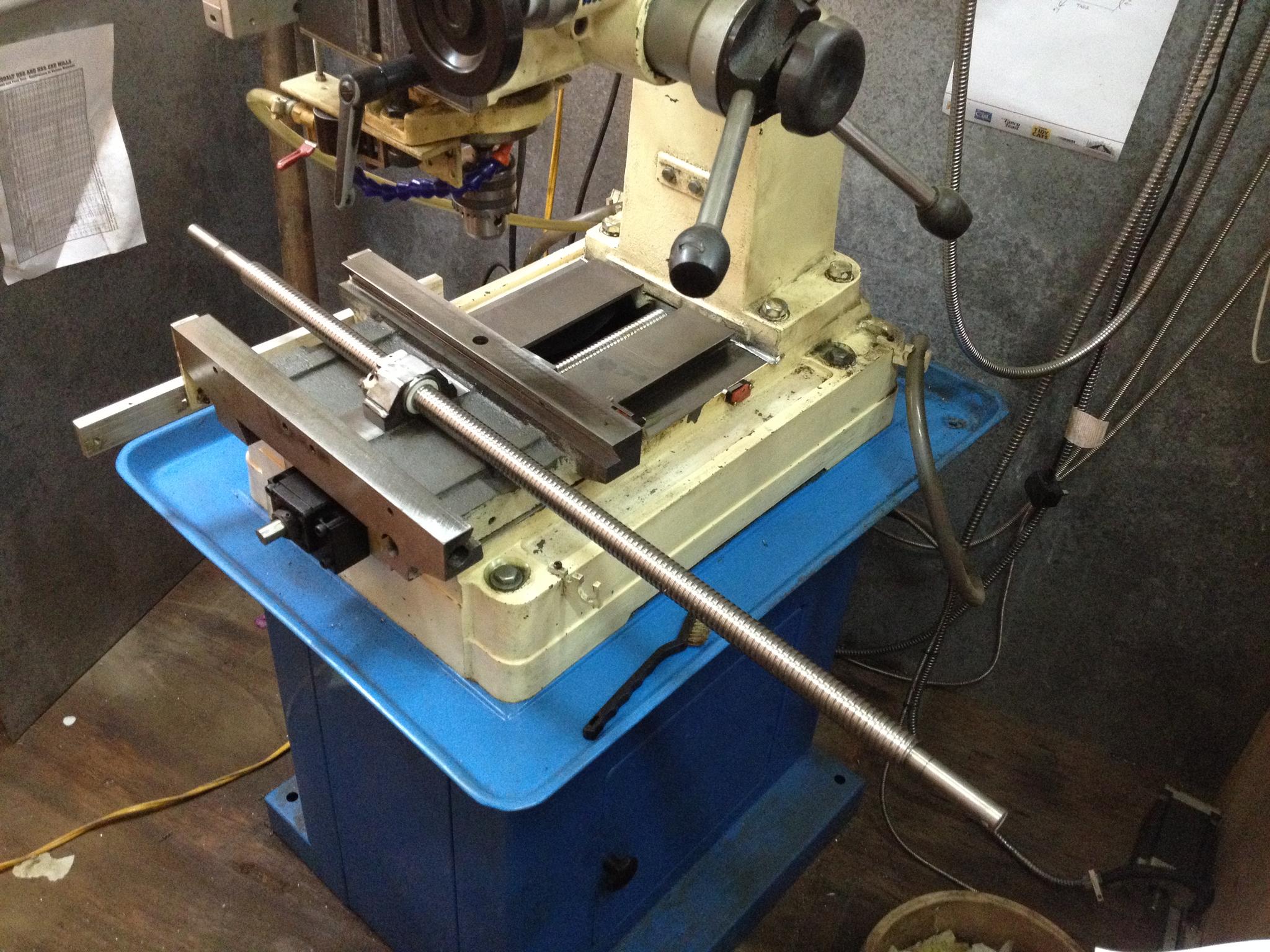

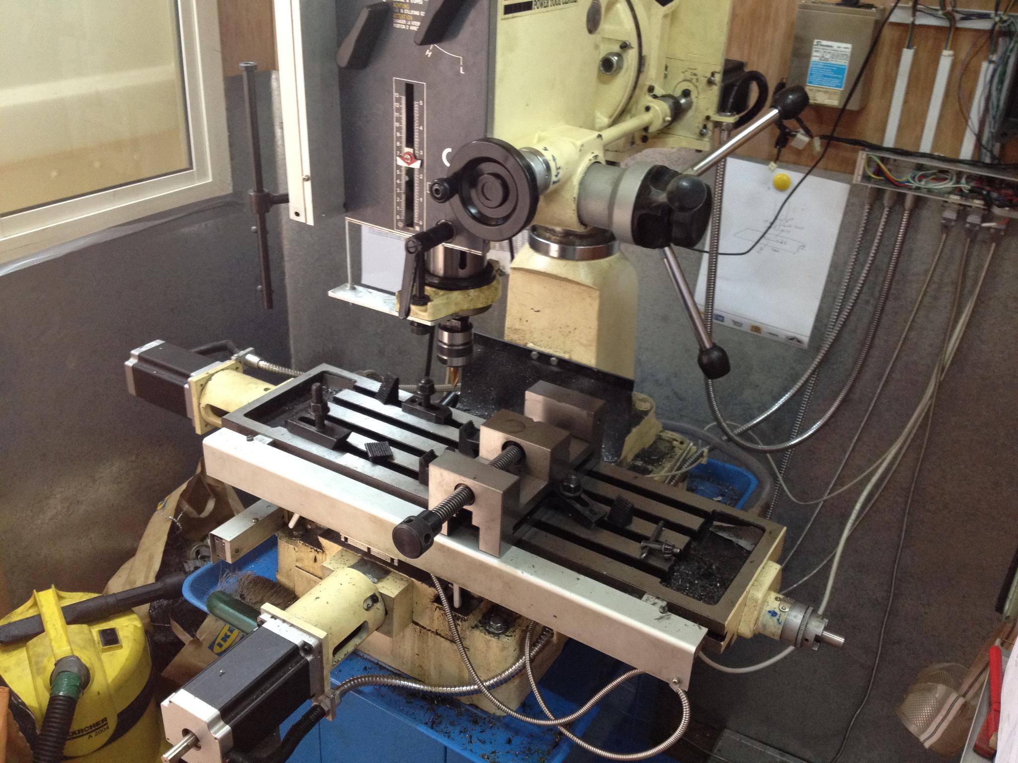

    In the end I gave up with the ACME leadscrews and poor quality bearing blocks (which contributed to the backlash) and fitted ball screws to X and Y axes (also from China on ebay)

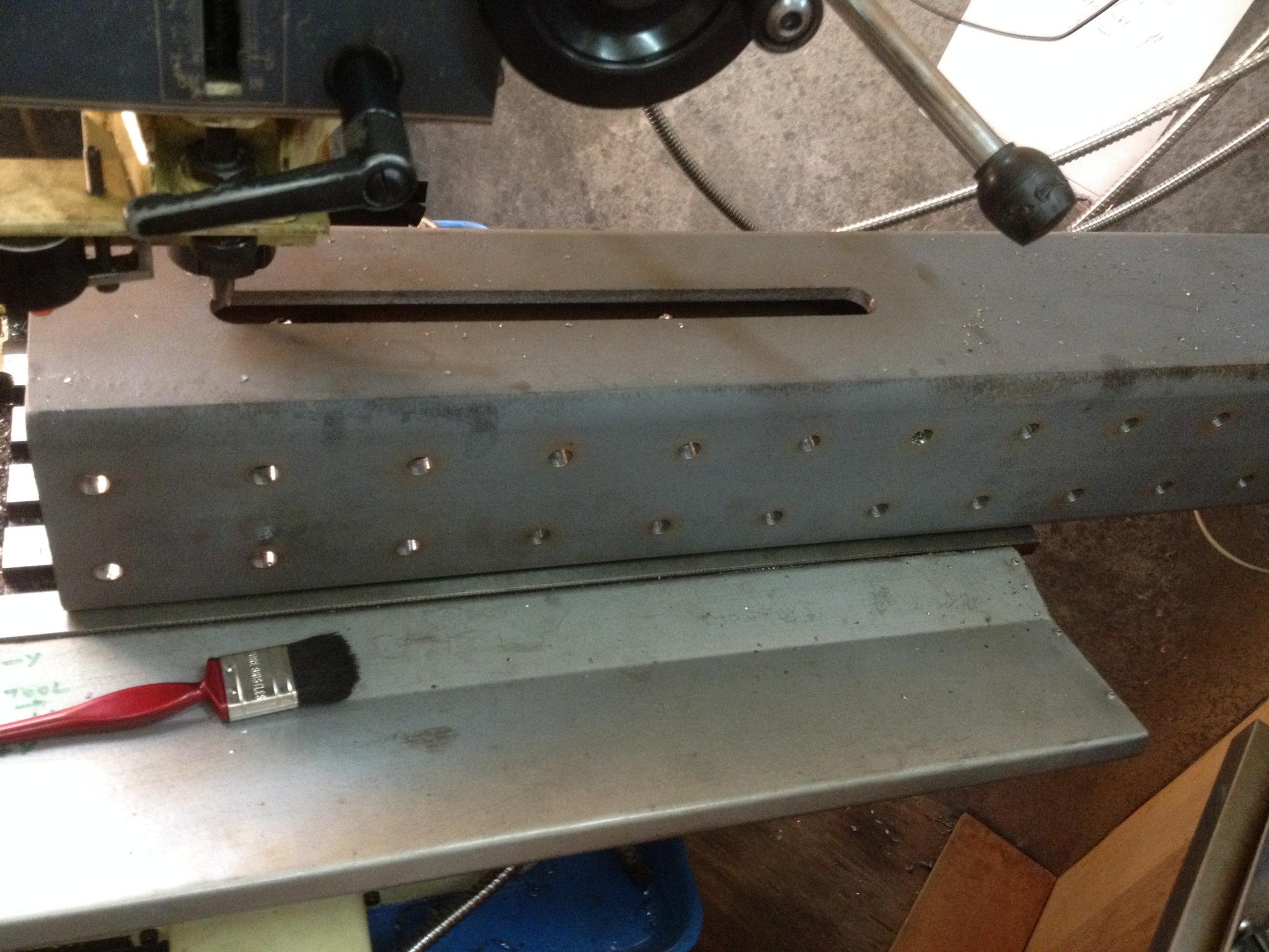

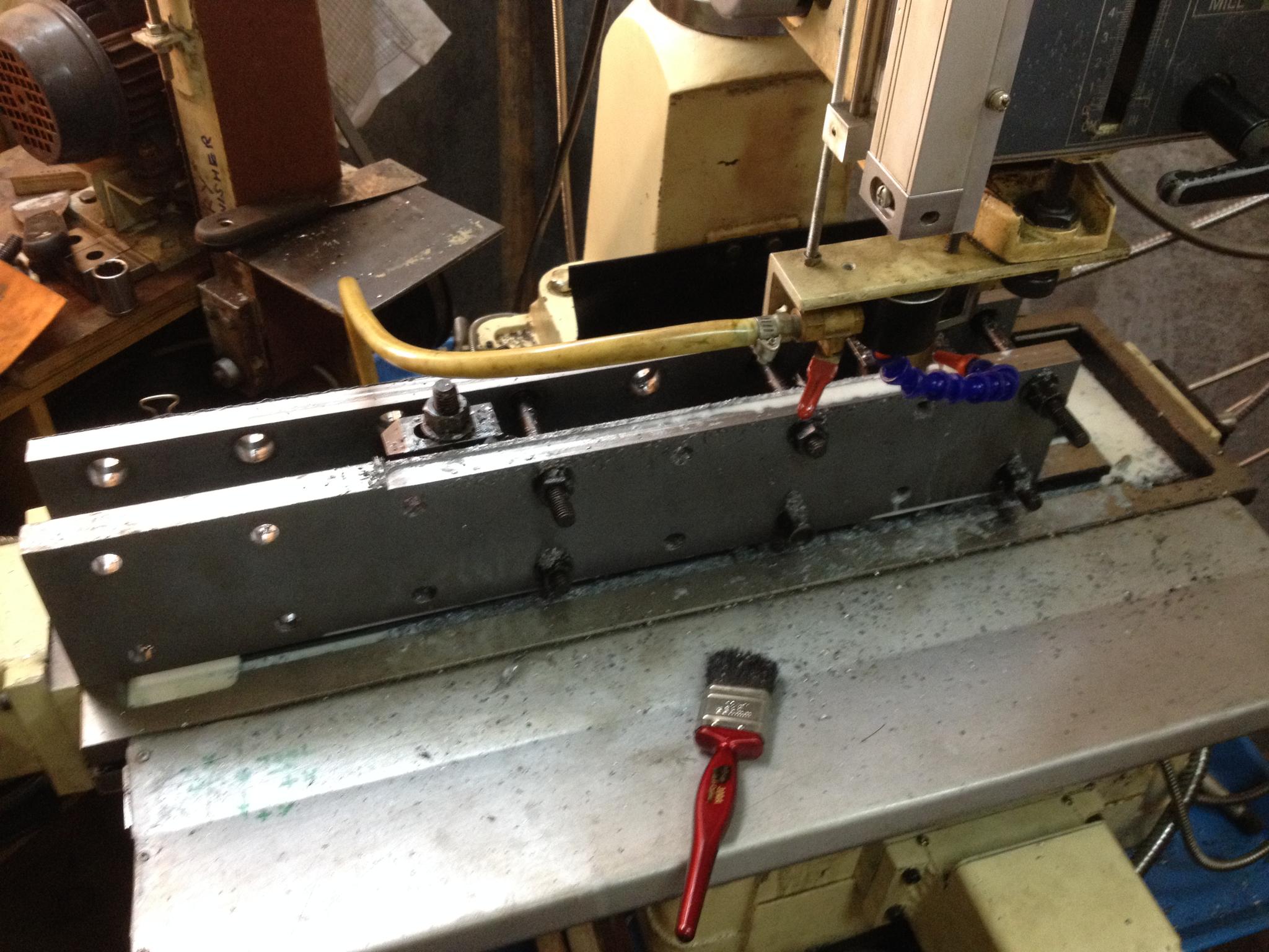

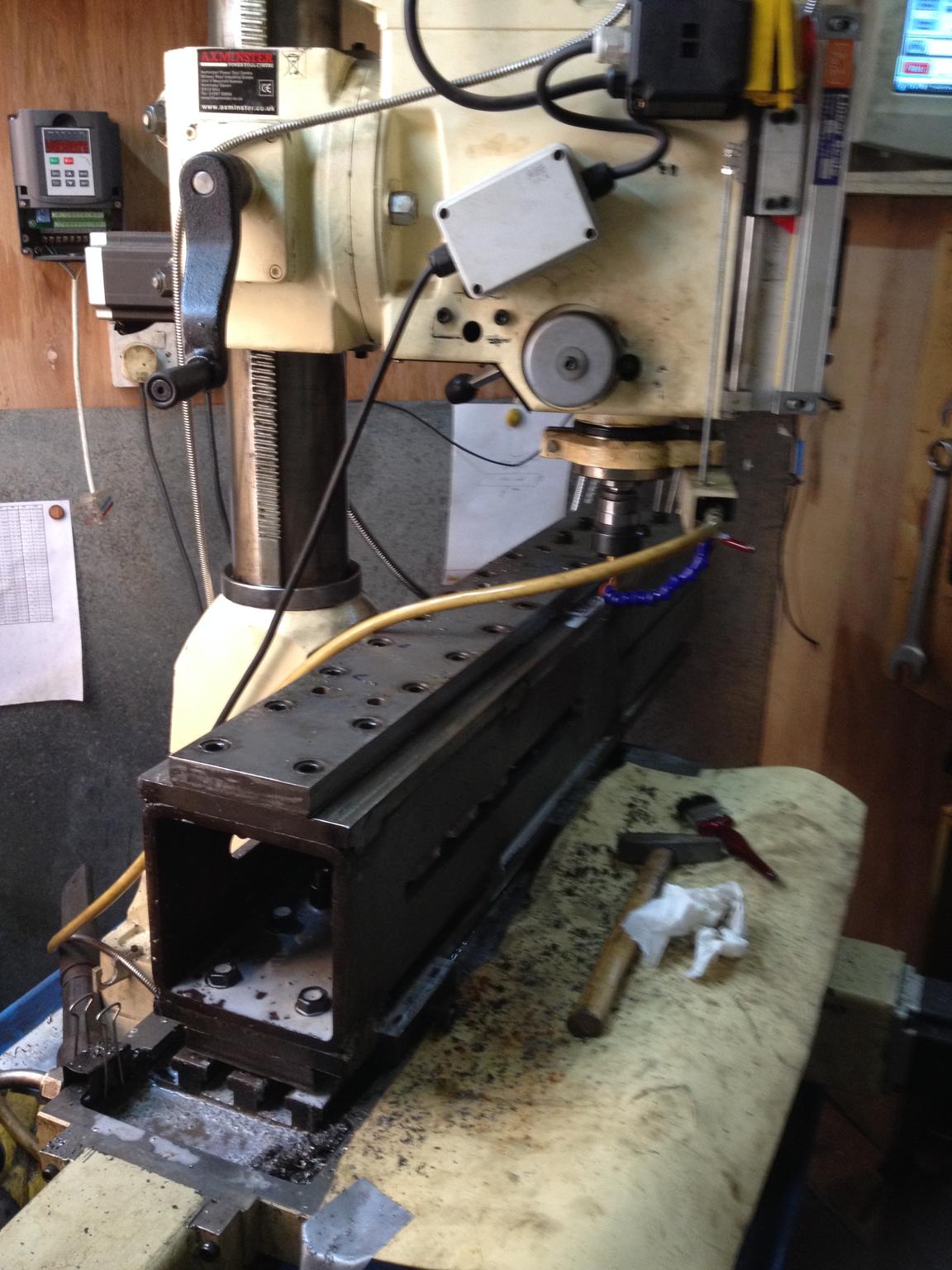

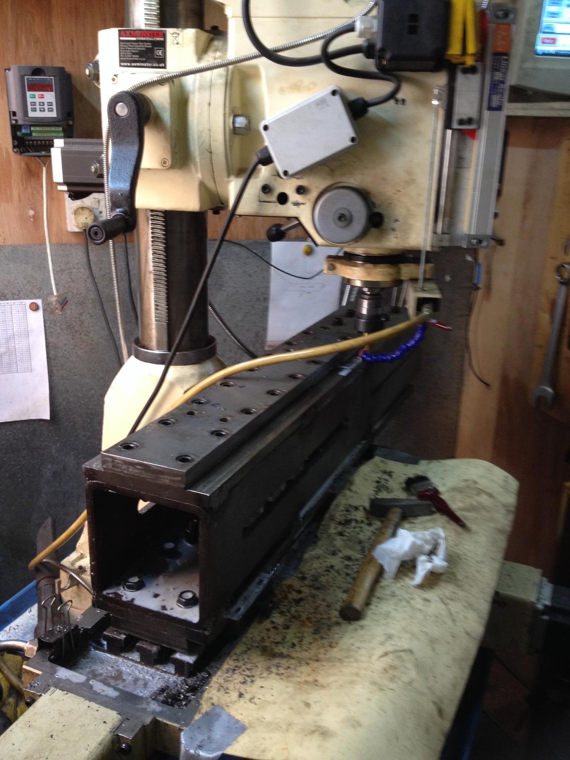

    Now I am dealing with the real issue with the RF 40 mill - the round column. As anyone that owns one of these machines knows - every time you move the head you lose your Zero.
    So here are a few photos of manufacturing a new boxway column for the mill.

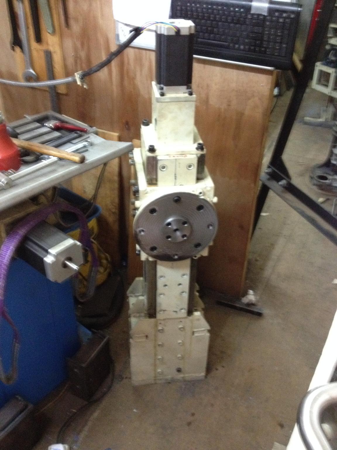

    Here's an update on the completed project:
Name:	2015-12-19 15.23.31.jpg

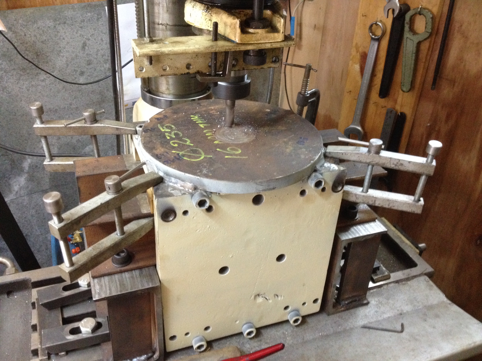

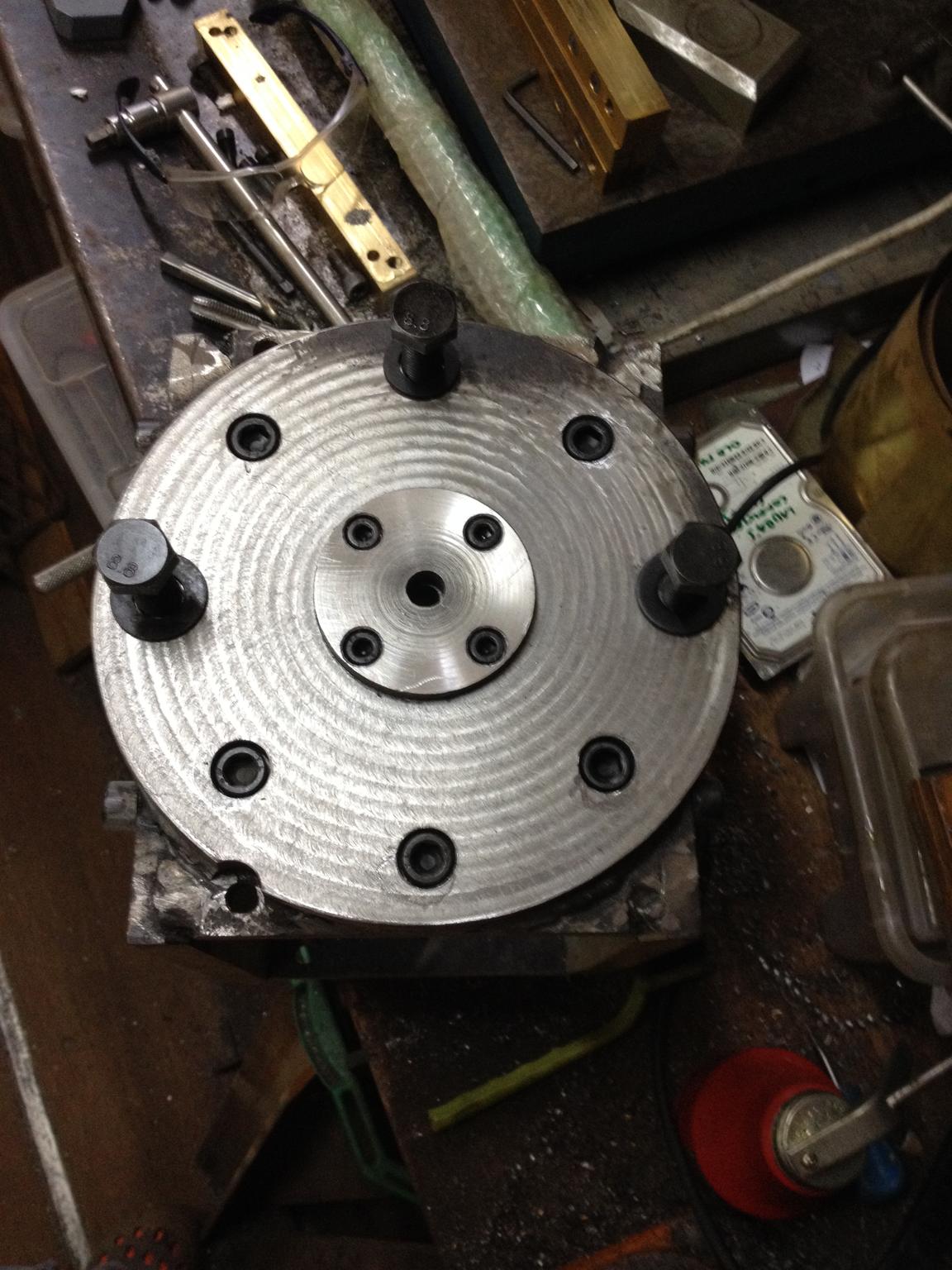

    Machining the Z Axis Carriage - This is the part where the milling head mounts onto.
Name:	Photo Jan 08, 10 18 13.jpg
    The completed carriage.

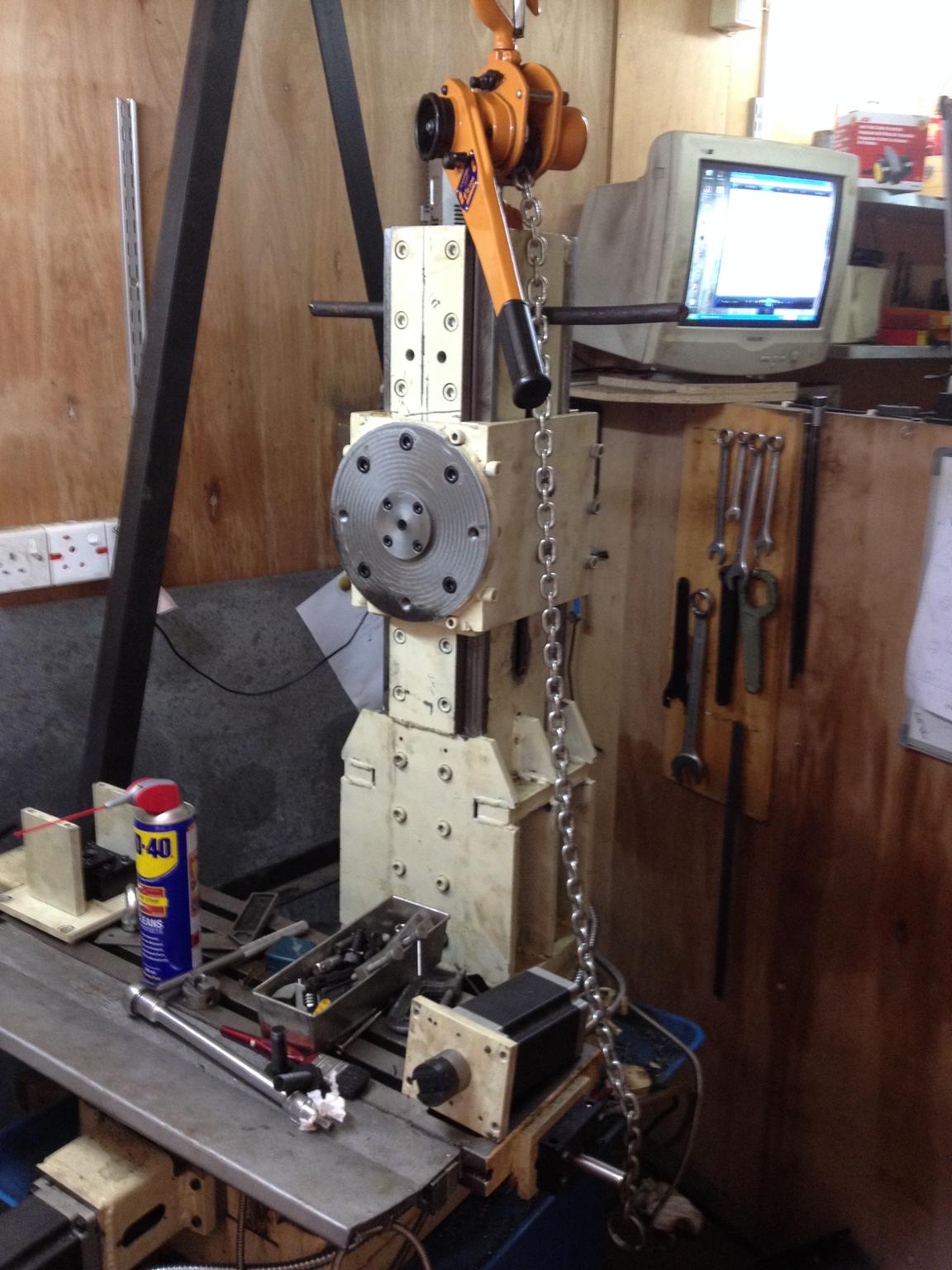

    Trial assembly of the carriage onto the column with the stepper motor on top
Name:	Photo Jan 22, 11 07 09.jpg
    Lifting the column onto the mill.
Name:	Photo Jan 22, 12 57 26.jpg

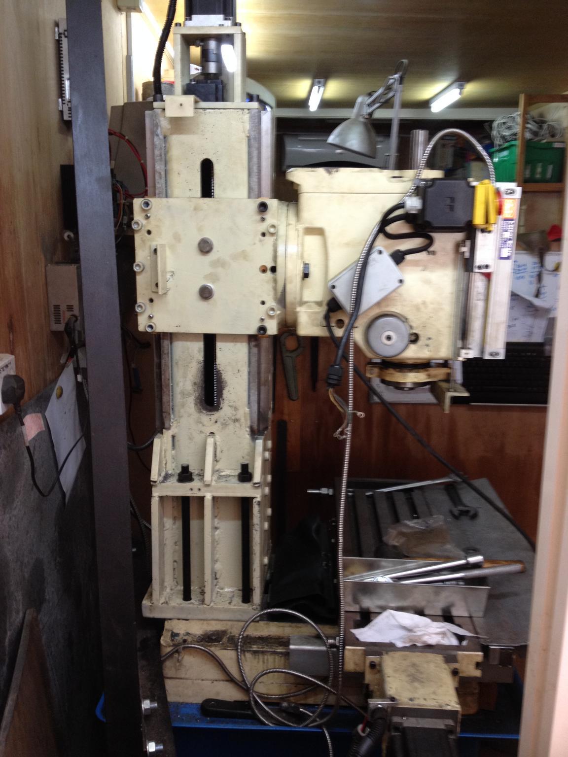

    The completed column mounted on the mill - with the milling head installed.
    I found that this installation is much more rigid than the round column. The stepper motor moves the milling head up and down smoothly using the ballscrew concealed inside the column (I was slightly worried that the motor would not be strong enough - but this works fine). I can now take bigger cuts at higher speed and with less vibration. It is so much easier to step drill a hole - because you can just keep raising the head as the drills get longer, with no fear of losing your position.
    I will send some more photos later of the machine working in full 3 axis CNC mode.

    First, thanks for doing this, it gives me some different views.
    So, if I'm following, you completely discarded the round column, built a new square column, and mounted the head to that. Is that correct ?
    What did you use for the main Z drive ? Guessing a pretty massive ballscrew..
