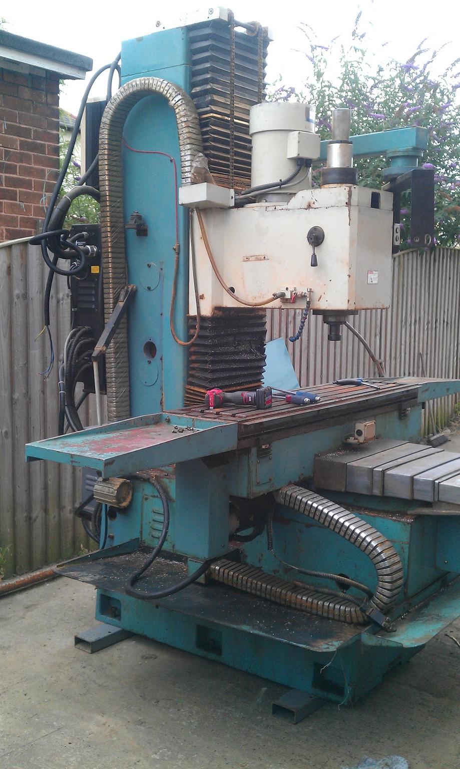

    Fitting to this.! . . . Replacing Brushed DC servos.

    Nice is it yours, looks like a big boy and a nice project to work on...

    It's mine for now but could be somebody else's when it's finished and fully Converted. I may put a Build thread up actually.
