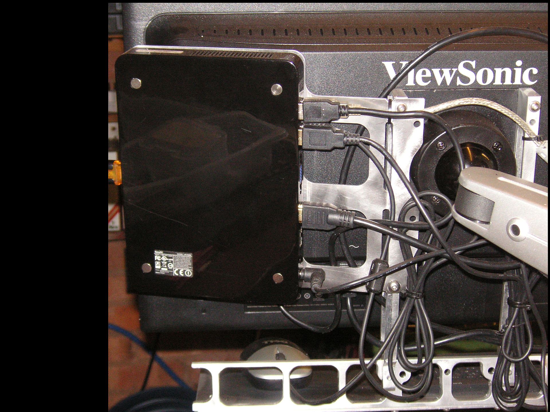

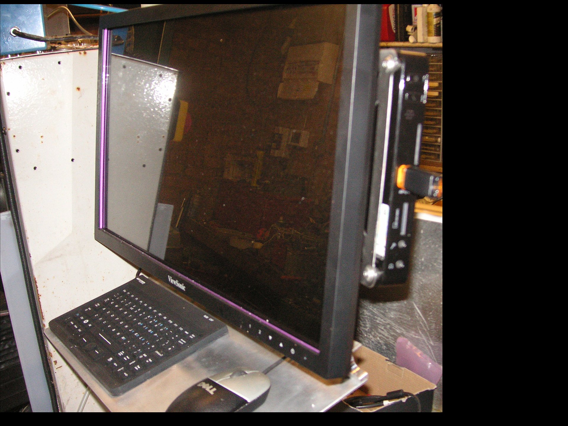

    I wanted a dedicated PC so I went for a Tiny Fox which is small enough to mount on the back of the monitor
