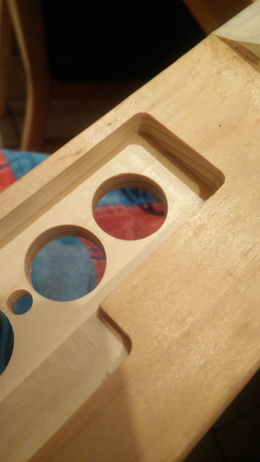

    Big thank you for all your help.
    Got the top down cutter, had a go with it today, amazing difference, its now doing exactly what I want it to do.
    Nice clean edges from top to bottom, no tearing, all good.
    Thanks again.
    Kind regards
    Richard

    A downcut cutter will give you a clean top edge. I have found that they do not work well alone, however. Because they have a "down" spiral, they do not clear chips at all. In fact, they force the chips to the bottom of the pocket. This can so jam the cutter that it breaks. (Guess how I know). I have found that I get the best results if I do an initial pass about 0.02" (0.5mm) undersize with a conventional (up-cutting) cutter, then make a final pass to finished size with a down-cutting cutter.
  9. #19
    The cheapest way to get a reasonable finish is to use a straight flute cutter - like this https://www.toolstation.com/router-b...mperial/p46293 I have some in my Odds n Sods cutters box - they're OK ish but good value for occaisional use.
  10. #20
    I suspect experiences differ in this area and it also depends on exactly what you are cutting. I'm in the middle of cutting some small, intricate shapes from 5mm and 6mm "aviation-grade" ply. Close-grained softwood with multiple thin plies. I'm using a 2mm up-cut single-flute cutter and I get good results with virtually no whiskering on the top surface. I do use the same trick as I do when cutting steel on the same machine - the final pass is full-depth with a very small step-over and this takes off the burr/whiskers. Both Vectric and Fusion 360 CAM make this easy to do.
    For pocketing in wood which tends to splinter more, I wonder if an up-cut tool for roughing followed by a down-cut for finishing would work? Not necessarily something to use in a commercial workshop but for one-off jobs at home, maybe? Or you pay a small fortune for compression cutters which combine down- and up-cut flutes in one cutter.
