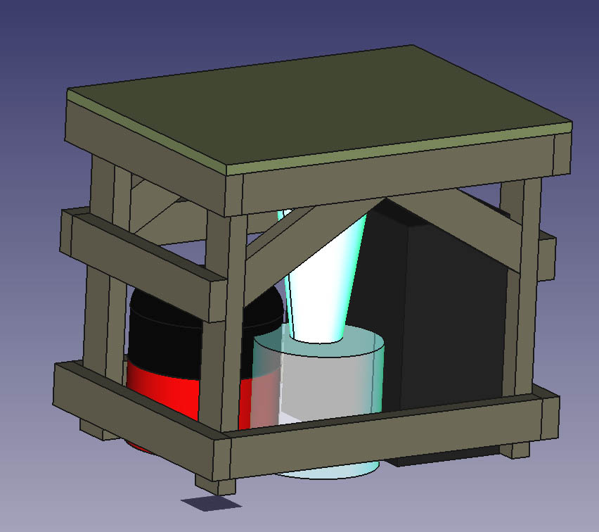

  6. #26
    Your Lidl one is this one perhaps? My main issue I have with larger compressors is the space.. I'm trying to fit most things under the table I'm going to build for it..
    Here's a quick little mock up I did using this air compressor but still having trouble fitting everything.

    Wickes doesn't have dimensions on their site.. so not sure on what size it is so have the original Henry in there still..
    There is a work bench next to this with space underneath (up to 190mm height) which I'm planning to put the PC under.. and if there was a compressor quite flat then it could also go under there, but they don't appear to come in the form factor that could fit under..
