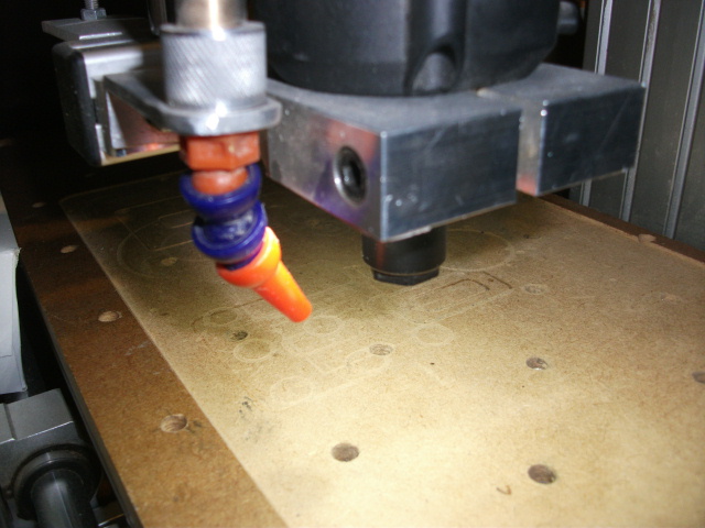

    JTF is cheap WTF ! <£50. That compressor should blast the chips right out of the frying pan ! I am never happy about running that type of compressor continuously. Maybe if you cut the airflow down enough to remove the swarf, but keep it as low as possible, so the compressor isn't working flat out, could work OK without burning out the motor.
    My little (A4) machine is a lot less industrial, the ACO388D pump blows directly on the work from as little distance as possible as I have a nozzle fixed to the spindle mount. The air feed tube is 8mm i.d. smooth walled to keep the air flow resistance down. It keeps the chips off the cutter and I use the blower gun on the airbrush compressor to blast it occaisionally.

    I plan to use a solenoid valve to pulse air when I do the steel welded machine.

    I use these bits for ali http://www.sorotec.de/shop/Cutting-T...s/2-Flute-ALU/ (if the page comes up in german there is an option to change to english). They are open geometry to allow chips to clear. You can probably get them direct from China, but I haven't particularly looked.
    On my small machine (which I must get working again) I have a larger version, 70W, of that pump* and it clears the cutting area OK, but I also use an air blow gun on a LIDL airbrush compressor. I just use WD40 to help cutting.
    *3 years ago, I paid £35 for it from an eBay shop, called something like PondLife and you can still get them around that price It is the Hailea ACO388D.
    I also have a smaller air pump but I don't know the wattage, I will try it with the mister nozzle and see if it is powerful enough (I suspect not). It was not good enough for chip clearing.
