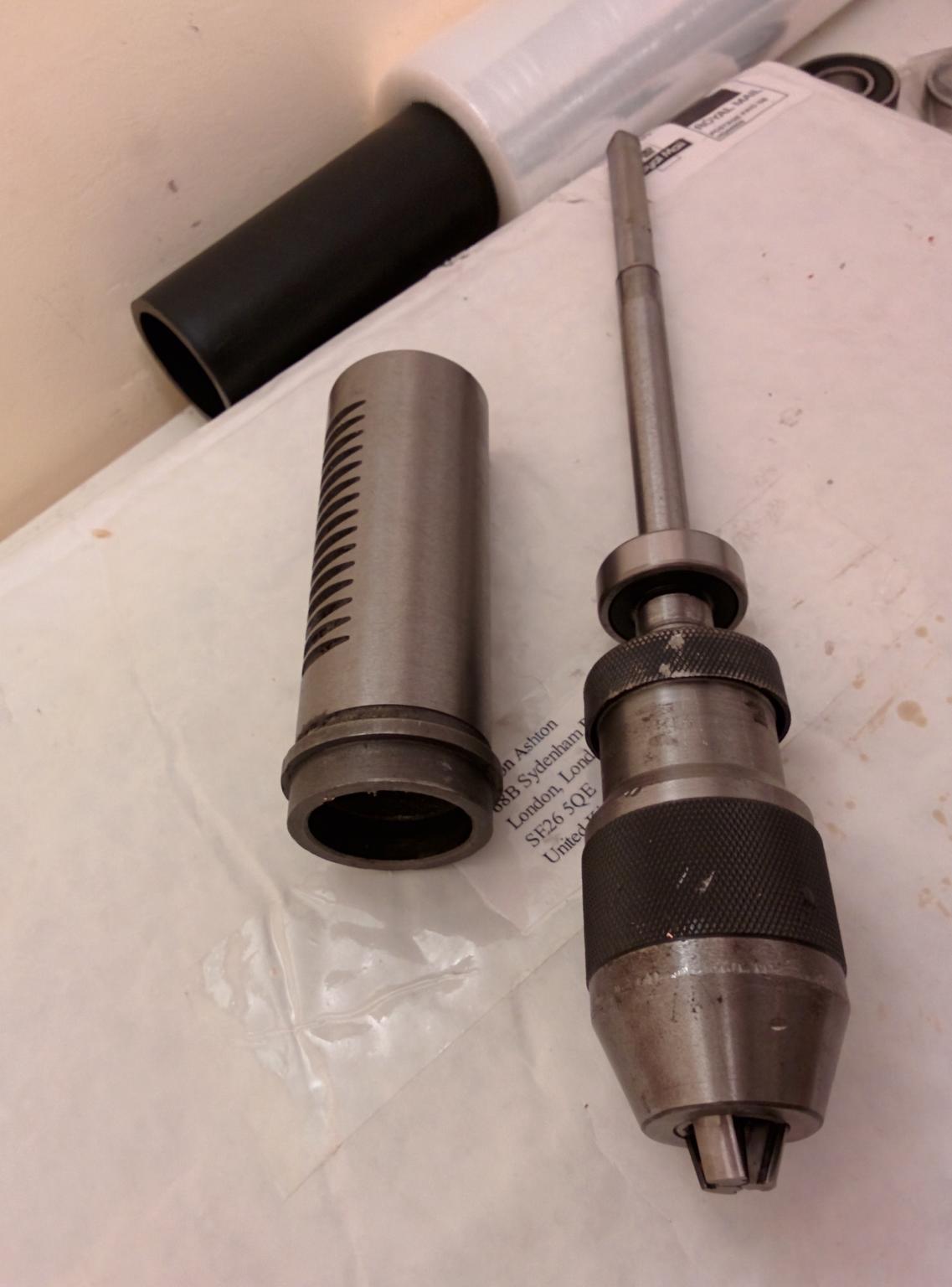

    My pillar drill was worn out so I pulled all the bearings off and ordered new ones. However I note the bearings were really bloody tightly on there originally so I won't be able to put them back without using my bearing puller. Now I can do that for some of them but not all; one is right down the end of a long rod and the puller won't reach it.
    I was wondering if they are put on with heat so the inner race of the bearing expands. What kind of temp could I heat the bearing to without worrying about melting the grease? 50C? It's a 6201-2RSH SKF bearing with plastic covers.
    Is this the method they probably used when building the drill in the first place, or did they just use a lot of force?

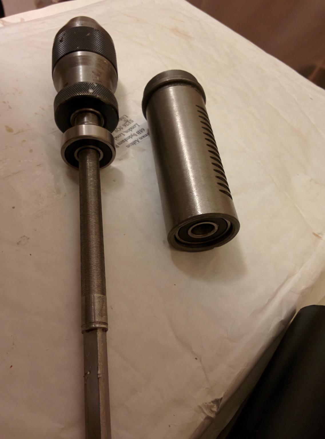

    Thanks for the reply. I actually just tapped them onto the shaft. It wasn't as difficult as I thought it would be.
    However... once assembled it has a clunky notch feeling as it rotates, just as it did with the old bearings! I thought 'shit I mashed one of the new bearings' so I took it apart again. Not assembled, each bearing feels smooth but assembled it has a clunky feeling as though the outer race has an indent and bumps as each ball rolls over. What's going on here!?
    Incidentally, the old bearings feel smooth once removed from the drill.
    This is the assembly. The central rod is held inside the outer sheath by two 6201 bearings.

    A design note here on the selection of bearings. For machine tools it is preferable to use shielded bearings to sealed. Rubber seals add friction and heat to the assembly that you could do without. Shields do not contact the inner race so they do not add too much friction and allow oil to seep through to the balls.
    What you are experiencing with the assembly being notchy is probably out or roundness in the housing or some misalignment on the shaft itself.
    Should not be difficult to figure out and save a few bob repairing it.

    I took it apart again and checked the shaft and found it was good and true. So I re-assembled and it ran smoothly. I must have bodged something first time!
    Drill back together and it runs quieter and less wobbly now. Sadly still a little bit of runout which I think is from the chuck arbour. Good enough for now and I'm not sure how to remove the chuck as the morse taper is directly on the end of the spindle, meaning I have no way to press the chuck away from the spindle shaft. I don't think it was meant to be removed. It's only a cheap Axminster WD13S (about £90 I think).
