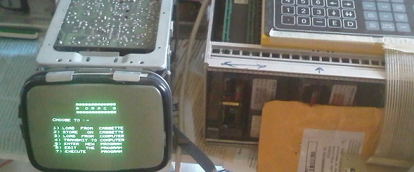

    Hi all!
    ...Trying to enter new program on my ORAC lathe I press (5) to move cursor to <enter new program> line and the cursor blinks under selection(5).
    Now if I press (E)ENTER nothing happens. I mean, I am not getting the buzzer tone which verifies that that button was pressed and thus I can not go to the first page of any program as this button(E) looks innactive. Same happens with all 4 data entry buttons located at the same horizontal row. Strange thing here, all manual mode keys respond, and stepper motors spin.
    It could be a keyboard interface problem but at this moment I have no idea of where to look at. Could be a faulty IC in the PC1690 (interface board)or may be an accidentally erased EPROM. Who knows.
    If anybody in this nice community here ever encountered a similar situation and managed to fix this problem please give me an idea of what to do.
