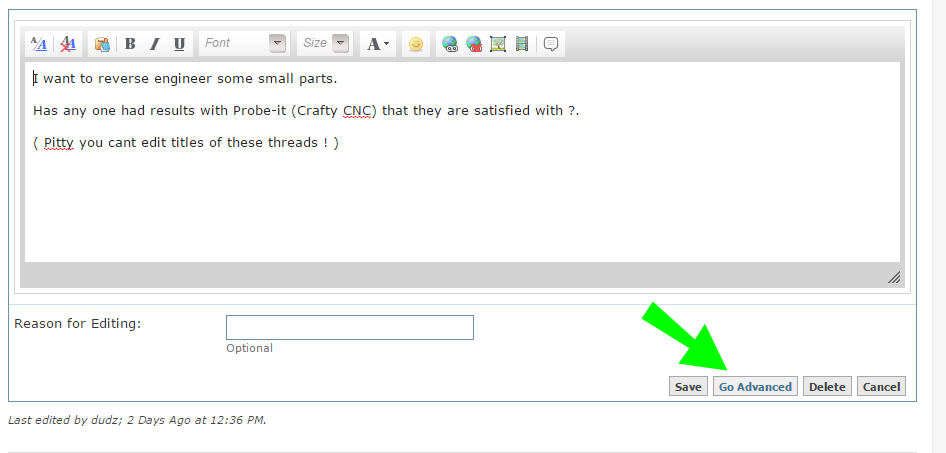

    Quote Originally Posted by dudz View Post
    Thanks Lee
    No problem :)
    I've had a look into this, members do have the right permissions available to edit a Thread Title, however there is a time limit on this of 24 hours.
    Looking at your thread and post times I can see you edited the post well within this time frame, so I'm guessing that you chose the "quick edit" option when you did the edit.
    For next time, if you use the "Go Advanced" button, visible to you after clicking the "quick edit" link for a post, you should see the option to edit the thread title directly above the "message body" part of the page, both are located in the "Your Message" section.
    Please see screen shots attached.
    .Me
