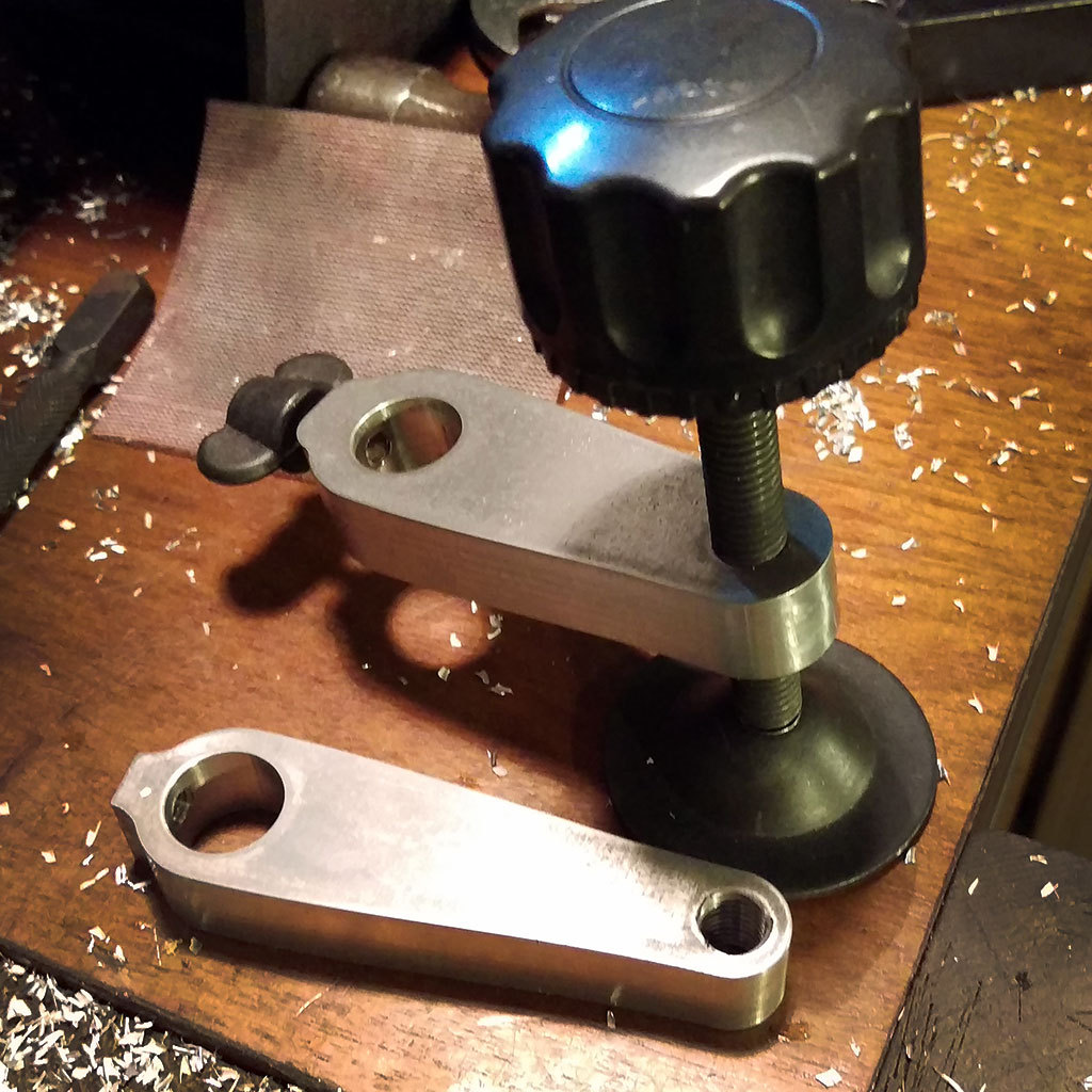

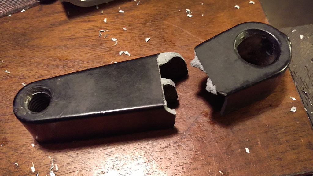

    I had to make myself a new arm after overtightening the OE (Makita - )

    Ah well, a nice afternoon project, original parts used where possible... (The stubby one was machined at the wrong dimensions - somehow I managed to screw up the saved vector and didn't bother checking sizes before cutting - luckily had two pieces of ideally sized scrap lying about...)

    Wal nice job there. Really satisfying to make your own custom parts. Sketch it in the morning, be using it in the afternoon!
