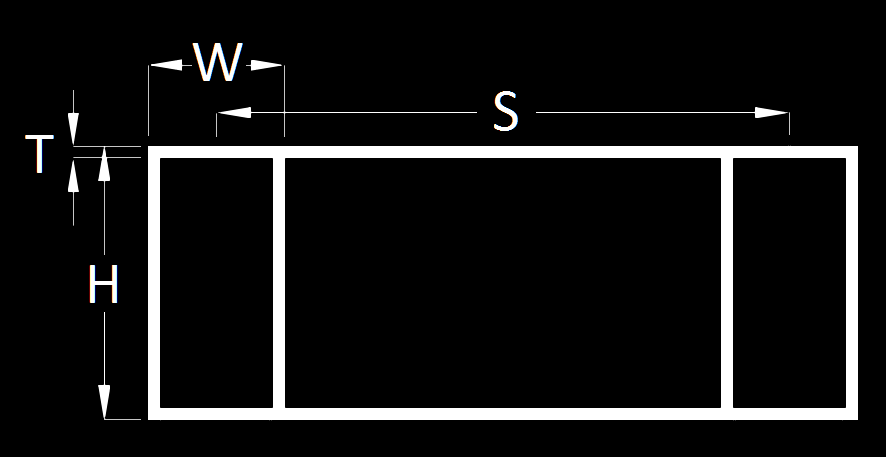

    I'm thinking of designing the gantry like this, cross section

    The Z axis would probably run down the middle.
    Anyone know how to work out the deflection? I'm thinking If you had a load of 100kg at 1m thats equal to 333kg with a separation of 300mm. Then calculate the bending deflection of one beam with 333kg, then multiply that by 3 to get the deflection at 1m.
    To be clear I was thinking the frame would be 100x100x5 and the gantry 200x100x8 but only because those where readily available sizes. If I have to special order some bigger then so be it.

    In terms of your calculations the bending stiffness calc is straightforward (load one beam then half the deflection for 2) but that only accounts for the Z axis weight and the plunge stiffness. For the sections you are talking about (200x100x8) etc this will no problem for simple bending. However, where you will come unstuck is having enough torsional stiffness when cutting in X (gantry moving forward or back), especially at 1m extension. I don't think hand calcs would be possible on a double beam in torsion so you need an FEA program if you want to work it out. I notice Fusion360 has FEA built in and this is 'free' so worth a look. This will give you deflections once you have learned how to use the CAD part of the software.

    As I see it the gantry and Z are like a T in cross section, which means its a simple bending calculation. I'm getting around 0.025mm deflection at 1 meter with 200x100x8 seperated 400mm center to center.
