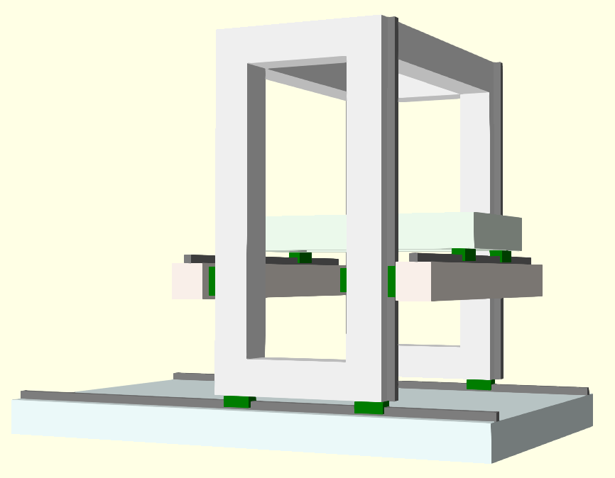

    Just easier to draw it hanging out the front so you can see where it is
  2. #42
    I may have misread this but the two rails under the bed seem to give total support to the outside edges and none in the centre? As most of the cutting will actually tend towards the centre do you think this is a good idea?
    I have never quite figured out the optimum separation but there must be one
  3. #43
    Mmm as pictured the bed would be made of 100x100 square hollow section so shouldn't flex too much. However liear rail is cheap so wouldn't hurt to add one in the middle.
    Just doing the numbers, using 100x100x5 shs @ 14.7kg per meter. The traveling 0 shape fixed but moving gantry design reqires 4.2m of tube per 100mm width. So for a 200mm wide traveling 0 it would weigh 120kg, heavy but just managable .
    The very tall normal machine of the same size would need 15m of tube which would weigh 220kg.
  4. #44
    Flex is not the real issue, right now the name of the game is minimising the overhangs -smileyface
  5. #45
    Had another idea and amazingly I found a CAD program I actually like, it's a miracle! It's not for everyone in fact it's probably some people' worst nightmare but it's right up my ally. Instead of using your mouse to click where you want something you type it out in a sort of programming language.
    http://www.openscad.org/
    This design is sort of in between a fixed and moving gantry. As a result the bed is lighter than a moving gantry design and the gantry is lighter than a fixed gantry design. What do you think?

    If your interested in this cad program you can recreate my drawing with this code

    Hello everyone
    Wonder if I can get your opinions on this?
    I think making this out of 100x100x5 tube would be too weak. It would weigh 100kg so making it thicker isn't really an option. I think 150x100x3 would flop around and generally not be very rigid. So that pretty much leaves me with the option of making it in two halfs and bolting it together. Something like this
    This drawing is of 100x100x10 with 20mm connecting bits, or 25mm. Each half would weigh 77kg without connecting bits, near 100kg with them.
    I'm thinking bolting it together like this, red circles are bolts.
    Each connector would be welded at one end to C shapes and bolted at the other. Then they would be bolted to each other.
    I don't think it would be solidly connected enough though. I think the 0.1mm better deflection gained from using the 10mm wall tube instead of 5mm would be lost in the less than solid connection between the two.
    I think it would probably be fine if the cutting force is straight front to back or side to side but if it's at all diagonal then there would be all sorts of twisting and skewing forces that would ruin accuracy and rigidity.
    I'm just struggling to find a way to make the thing really rigid enough and still light enough for two people to carry when disassembled.
    Any ideas or thoughts? Thanks
