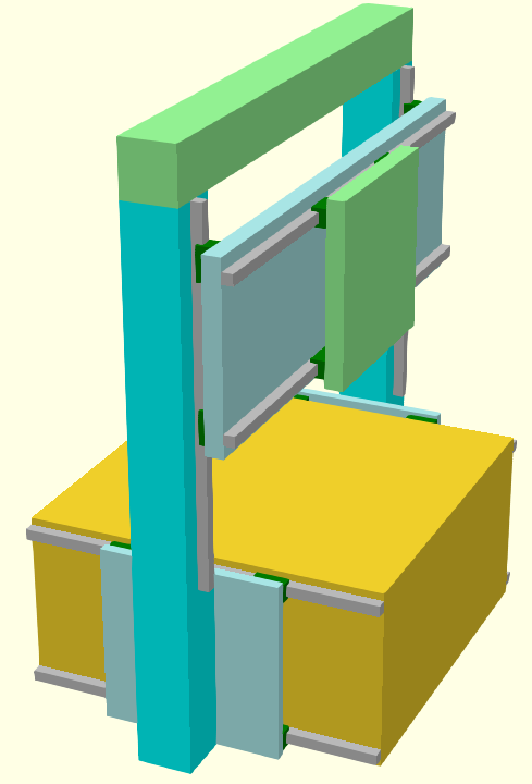

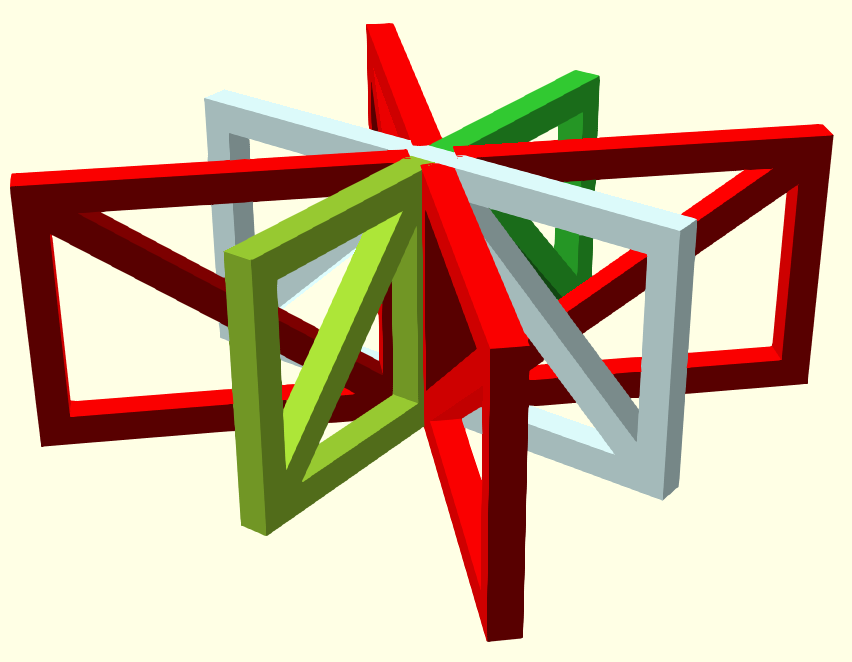

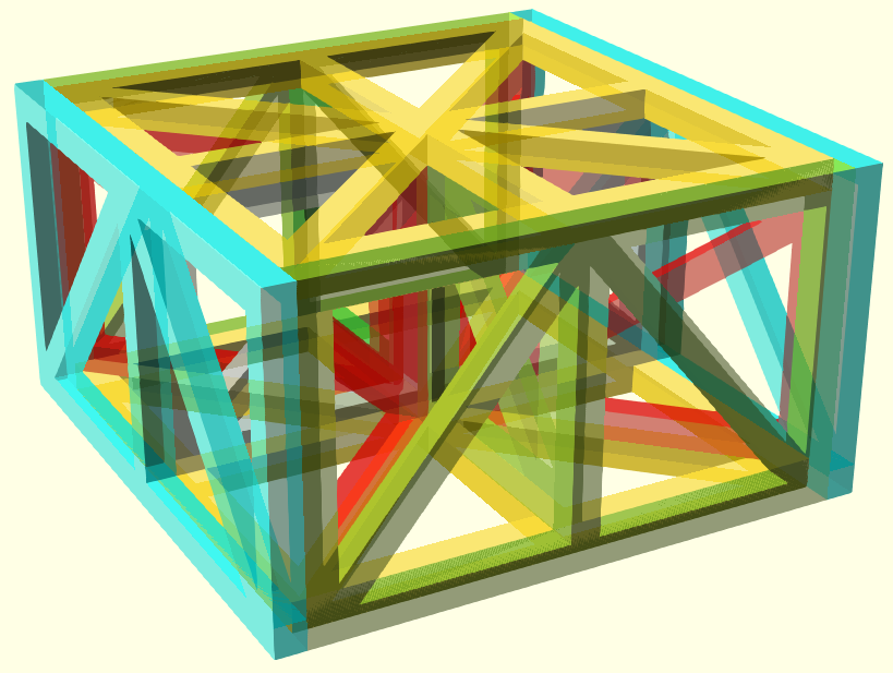

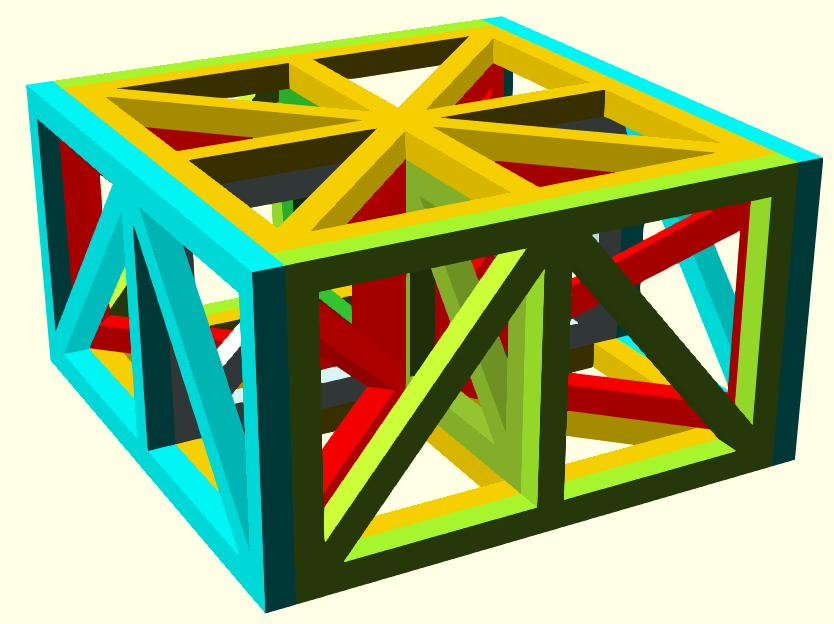

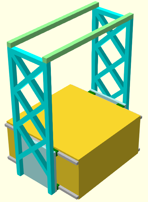

    Hello again, refining my ideas. Trying to get the thing in around 300kg total. It means using 50mm thin wall tube in some places. Trying to get the base about 100kg, the uprights about 100kg and the gantry about 100kg. I had some exact weights calculated but drawing it out again I realized I could make it 100mm narrower overall so that will be a decent weight reduction in the base atleast.
    I'm thinking the base might look something like this. 50mmx3 square tube apart from where the rails connect would be 50x5. Anything thats all one colour is a welded 'frame', anything thats a different colour would be bolted together.

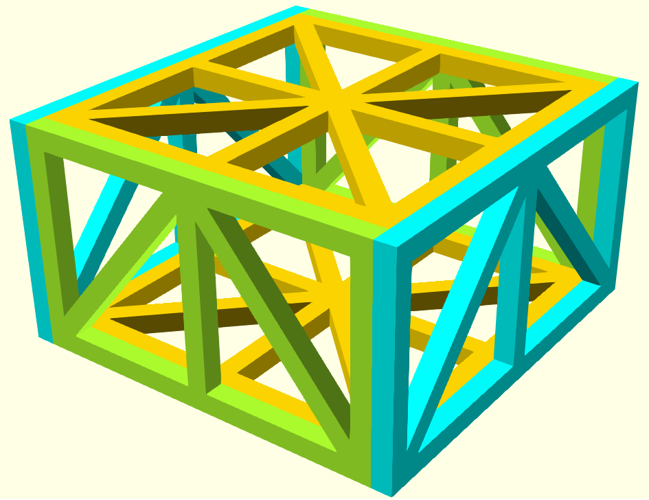

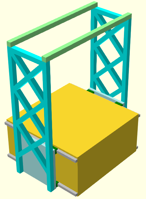

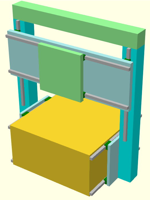

    And the rest would look something like this.

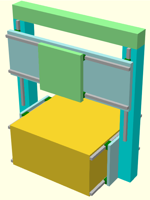

    or more like this
    The footprint would be 1m x 1m and the working area would be 500mm x 500mm, which is fine.
    What do you think?
