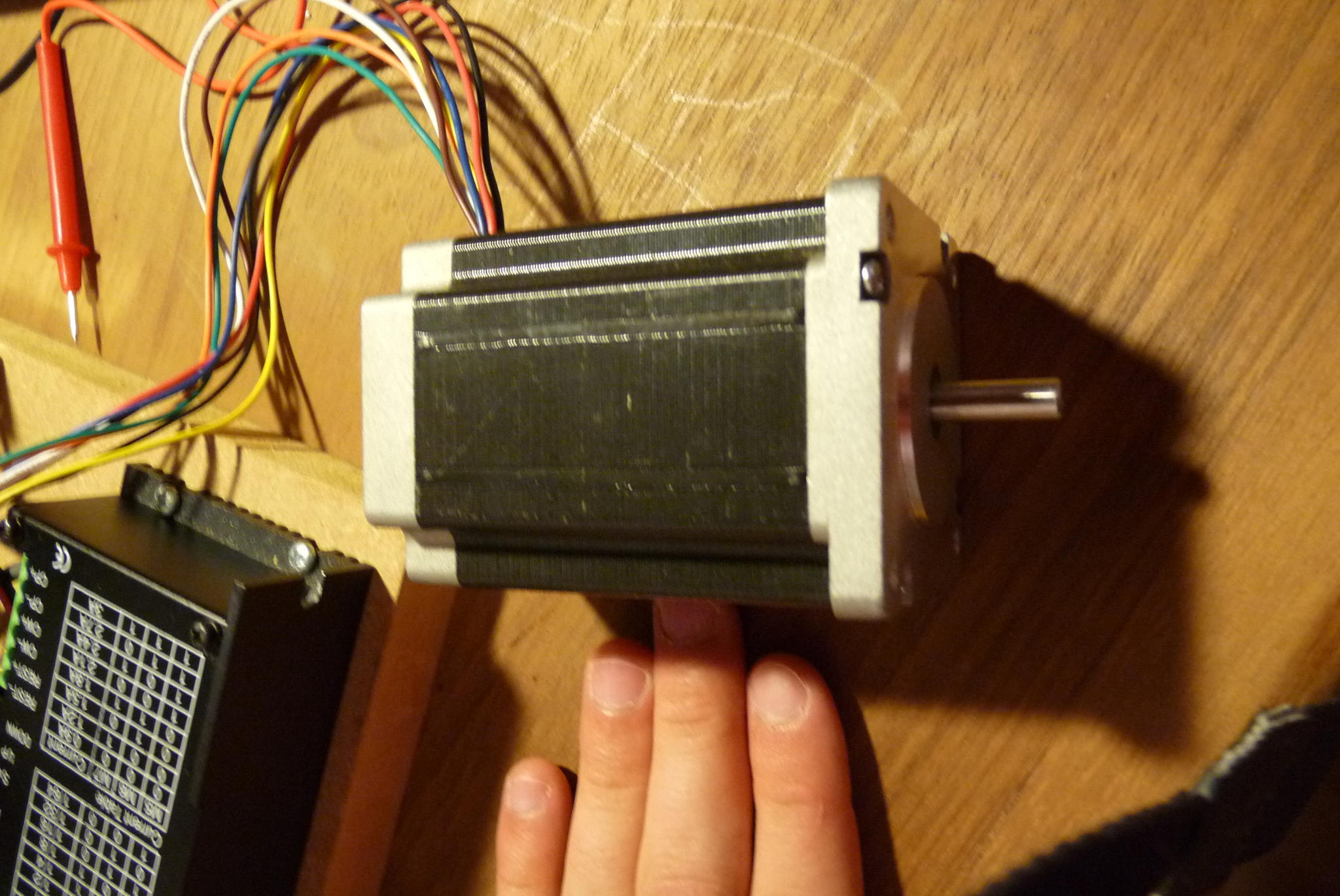

    Hi guys, thanks so much for the replies. Here is the information you have requested, plus several pictures of my drivers, bob, and wiring, and also other essential information. The wiring diagram is at the end of this post.
    Break out board:
    5 axis break out board V5 from buildyourcnc.com:
    I wired it and set up mach3 using the instructions at:
    http://www.buildyourtools.com/phpBB3...php?f=8&t=2128
    Stepper motors:
    • 60BYGH303-13 (8 leads) from buildyourcnc.com:
      https://buildyourcnc.com/Documents/P...-13)%20(1).pdf
      To be noted:
      - I have them wired bipolar parallel
      - honestly, nice looking motors, quality seems to be there, I doubt they could be broken, at least not all three at the same time.
    • 57BYGH8930 (4 leads: GREEN, BLUE, YELLOW, RED) from AliExpress.
      To be noted:
      - No data sheet provided
      - The leads don't match Nema 23 standards, but I found the wiring on some other Chinese motor with the same color code... It said: GREEN=A-; RED=A+; BLUE=B-; YELLOW=B+.
      - Here is the link to the original AliExpress item, but this probably won't be of any help:
      http://www.aliexpress.com/item/NEMA2...028971350.html
      - I think I was out of my mind when I bought this guy... but oh well, now that I have it I better use it :)

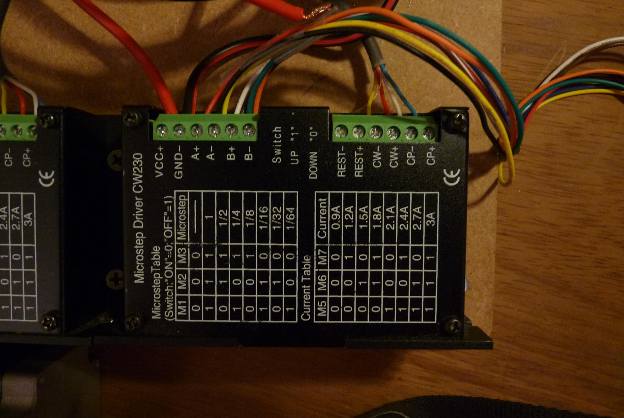

    Stepper drivers:
    • CW230, also from buildyourcnc.com:
      To be noted:
      - No information on what switch 4 and 8 are for....
      - It has CW+/- and CP+/- instead of common DIR/STEP pins
      - I wired it using the instructions at:
      Switches are set to 2.4A and 1/8 mcs:
      SW1=0 (down)
      SW2=0 (down)
      SW3=1 (up)
      SW4=0 (down)
      SW5=1 (up)
      SW6=0 (down)
      SW7=1 (up)
      SW8=0 (down)

    It's hard to tell from the pics but the 8 wire motor looks like it's got 2 red wires going to A+.? You should have
    A+ = Red & Blue
    A - = Black & yellow
    B+ = wht & brn
    B - = Org & Grn
    If correct then I have known some cheapp drives do strange things like this when the pulse is on the wrong side. So try changing the active state in Mach3 and see if it makes a difference.
    Also what are you using for a parallel port cable.? It must be a straight thru cable not an old printer cable.!

    Have you measured the resistance between each pair of cables ie between red/blue black/yellow etc they should read all the same + or - a very small amount.
    Also as Dean has said re the printer cable make sure it is a straight through cable ie pin 1 to pin1, pin 2 to pin2 etc. AS when you say you have used it before was it on a printer? Not all printer cables are straight through.
