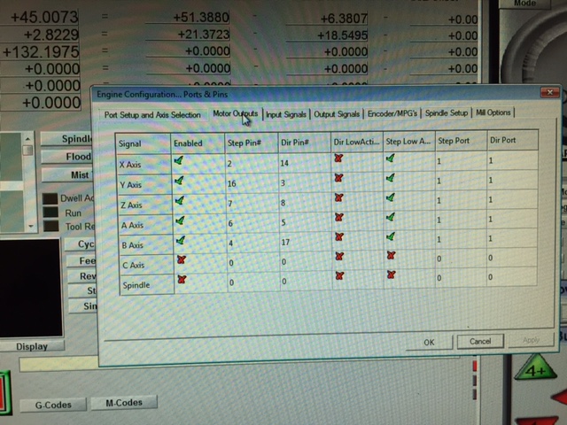

    I'm having a problem with my Z Axis motor tuning . The settings are listed below. It goes in both directions when I use either of the Z+ or Z- tabs. Have any Ideas on what I'm doing wrong?
    The wiring has been checked and double checked. I'm running the jog rate at 45% and it keeps going in one direction and then reverses the direction. If I run it at 100% it does nothing.
    I listed the settings below
    I'm using M542 drivers.
    Motors
    * Manufacturer Part Number: 23HS45-4204S
    * Motor Type: Bipolar Stepper
    * Step Angle: 1.8 deg.
    * Holding Torque: 3.0Nm(425oz.in)
    * Rated Current/phase: 4.2A
    * Phase Resistance: 0.9ohms
    * Inductance: 3.8mH+/-20%(1KHz)
    BOB http://www.ebay.com/itm/Upgrade-Usb-...item2a4eceaf9b
