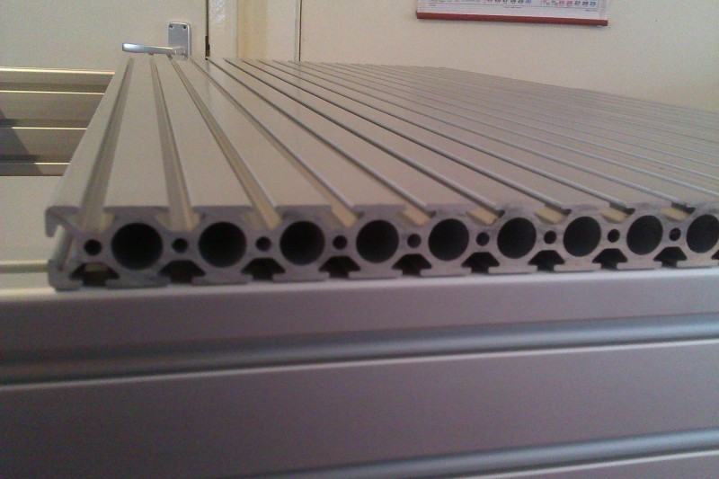

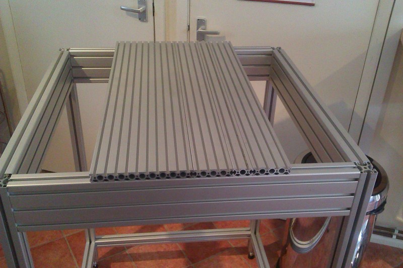

    Hi Jazz, completely unrelated to this specific thread but you seemed to be the man to ask. In short I need to source some low profile machine bed extrusion ideally the same stuff as used by Hobgoblin on his 3 axis CNC mill Project: http://www.mycncuk.com/threads/4992-...C-Mill-Project

    I presume this is stuff is from China? I really need to source some ASAP for a rush prototype project. This stuff would be almost Ideal unless something thinner is available. Is there a manufacturer, or website you could give me a link to?

    If you have a look on aliexpress there are sellers with 20x20 and so on available :).

    Try this company they sell 160x16 which is nice sive for bed. Thou I see it's saying Sold out but will probably re-stock soon.!
    http://www.motedis.co.uk/shop/Slot-p...91_999993.html

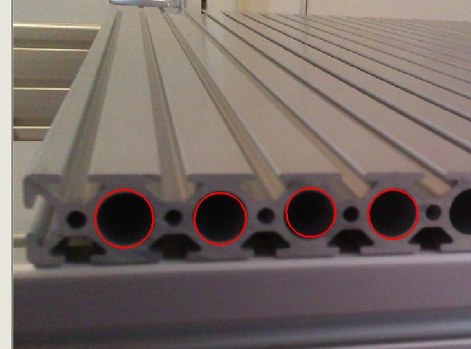

    thanks for the responses guys but as well as the relatively flat slim profile its the nature of the circular voids in this particular exrtusion that I'm most interested in
    I have to produce a prototype of some high voltage electronics which will eventually have 4 off 1750mm long bespoke extruded ally cooling units. but before committing to those manufacturing costs we need to prove and test the theory with something similar in ally, and this extrusion with its circular voids would really work well. So do you know the specific supplier of this stuff or does anyone have contact details for Hobgoblin as he doesn't seem to be active on the forum at the moment. You can Email me externally at [email protected] or alternatively pass that address onto Hobgoblin and ask him to get in contact

    Ah ok np, I can't give you his email address but I can forward yours onto him and link to here, you should also be able to send him a PM or use the option to email him instead, that's a web based email sending form but once sent it's no different to any other client and should end up in his local inbox .
