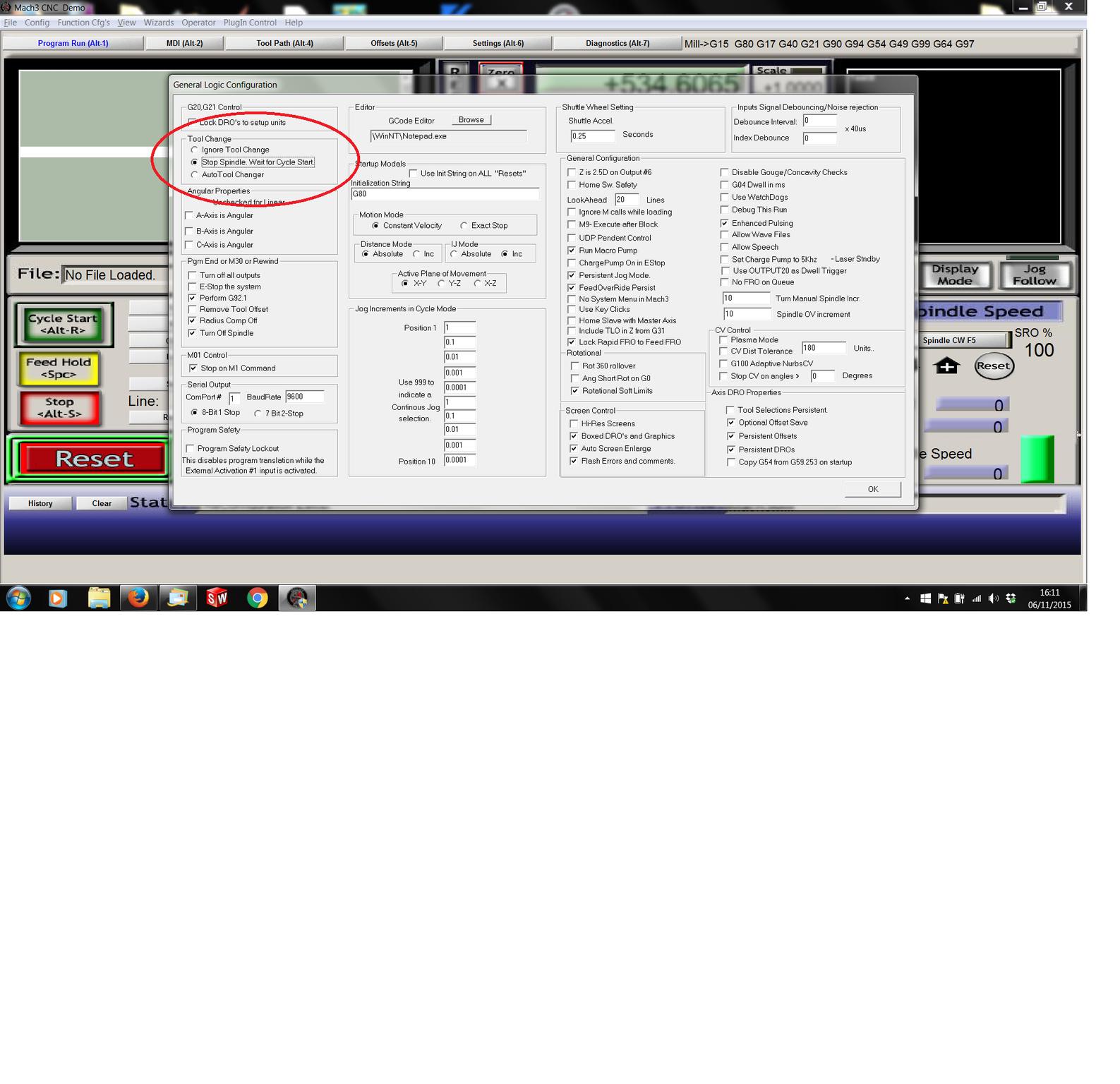

    What code do you put in to do that? I put in M6 and it didn't flinch, just ran straight past it?!
    Well then your problem is that you haven't turned on tool changes in General Config. See pic.

    If the file your using is made up of two or more operations, whether that be 2 milling op's or Drill and then mill etc and each operation uses a different tool number then M6 will stop at the new tool and wait for cycle start.
    If like in your case your using same tool for both Op's then still give a separate T number to the second tool and it will do what you want and you won't have to mess around inserting M codes etc. (You have to do this to trick your Cam Post processor into inserting M6 other wise it will see same tool number for both tools and leave M6 out because it thinks you don't need to change tools)

    I've had a look into it and as you say you need to specify the different tools first i.e. T1=1, T2=2 and then It'll wait...if you just put M6 in there like an idiot that I am then of course it won't do anything as it doesn't see a different tool......
    No if you insert it your self manually then it should still stop because Mach's STANDARD M6 macro doesn't Know or care about the tool number it just stops and waits for cycle start. Then enters the next tool number has the current tool in Mach's Tool DRO.
    It doesn't do any checks to see if the current tool is same has the next tool so if you insert M6 before the next tool then even if that tool has the same number it will stop and wait. Then it enters this same number again, obviously on screen it looks like nothing changed because it's same number but it did still do the change.
    It's the Cam post processor that leaves the M6 out if tools have the same number. So if it's missing M6 then it's because the tool change is turned off in General Config.
