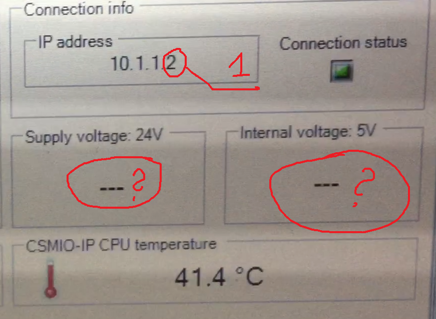

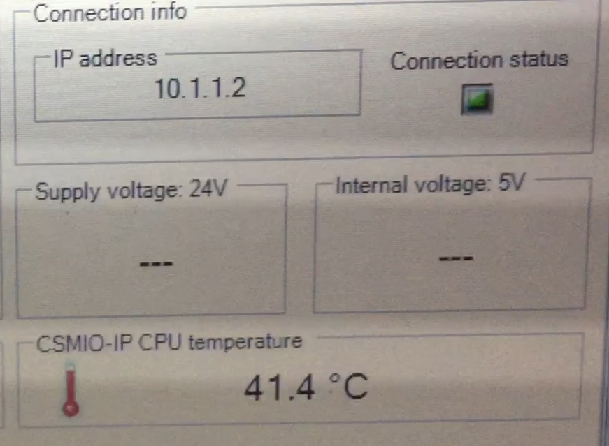

    Hi Guys
    Got question regard that module.
    So far I only done bench test with basic circuit including:
    Panasonic CF-19 Toughbook - win7 64bit
    CSMiO-IP-M
    Motors Nema 24Hs39-3008D 4.2A 8 wires in Bi-Polar Parraller
    Driver DM 542A Longs (1/4 steps, 1/2 holding current)
    42VDC PSU - torus trafo.
    1. Why voltage doesn't appear in 5V and 24V box?
    2. Motor stalls above 1.5m/min (5mm ballscrew pitch, gear ratio motor20/18screw, 1/4 miocrostep - about 177 steps/rev)
    I had the same thing with nema 23 motors on bench but in machine they reach 5.1m/min - scratching my head why?
    Max motor speed 1500mm/min (free spinning)
  7. #35
    Resonance is why they stall on the bench but work fine on machine. With cheap Analog drives like those from Longs then it's worse than with better quality drives and much worse than Digital drives.
    If those drives where Digital then on machine you'd reach 7-8mtr/min and have much smoother performance.
    If your only getting 1.5Mtr/min on machine and sure all your tuning/setup is correct then I'd start looking for some serious binding.?
    How did you wire the Motors parallel or Series.?
    Why the Voltage isn't displaying I'm not sure it could be the plug-in or PC. Make sure your running Mach3 as Admin.

    Thanks Dean
    Those drive meant to be digital 'DM' but they are fake (they do not have autotuning like Leadshine) dodgy ebay seller:(
    Only getting 1.5m/min on bench, on Machine 5.1m worst axis, 7m easy on Z, all with genuine digital drive.
    Motor wired as described - Bi-Polar Parraller (8 cables)
    Mach runs as Admin, tried both laptop same result - seen video without those reading
