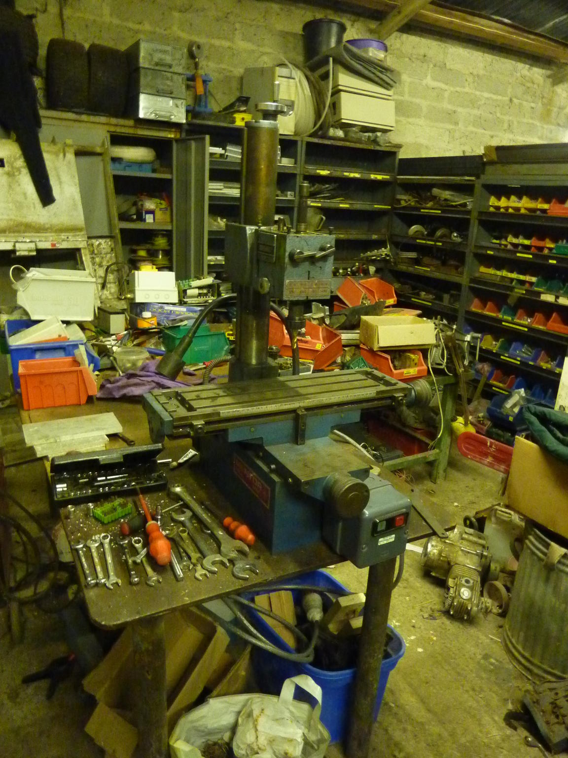

    So after a long time away from anything hobby related I have finally got around to some shed time.
    having learned from my drill conversion saga I hopefully have done it properly now and just bought a descent mill to convert to cnc. It is actually an EME mentor mill MM1 base with a Maximat7 mill head. 4 speed gear box and 0.25kW 415V 3 phase motor.

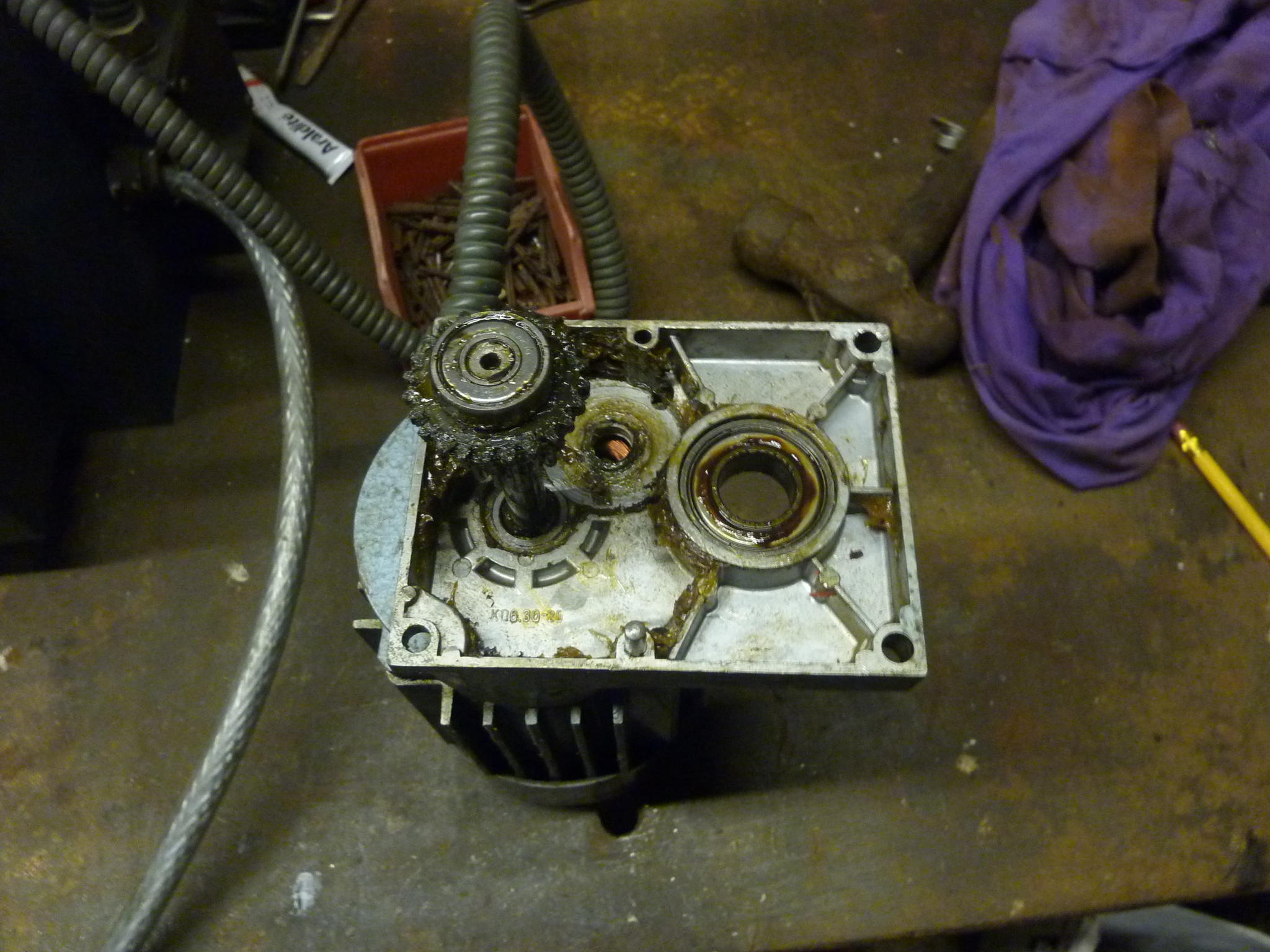

    The main problem is that the motor is 415v and the plastic gears in the gearbox are shot. In light of this I think the best option is use a DC motor from a treadmill and convert it to belt drive giving full speed control and 2hp.
    The existing motor is part of the top plate and also holds the bearing for the final drive cog. To fit a different motor would mean making a new plate. Not having a working mill does pose the problem of how to make this.

    Any takers for quoting to make this part? subjec to proper dims and drawings etc.

    I'm rebuilding the head off my Arboga at the moment where the gearbox sits on top. i had to dump this to build a direct drive. I would just mount the mount up off the top plate you have already and remove all the gubbins from your box. This way you would just need a couple of pieces of Bar to raise the motor in the air to accommodate the pulleys.
    Same as Ross.
    Saw the top plate off the motor, job done and everything fits and is in line.

    Thanks Swarfing and John. I always seem to miss the easy solutions, although I was hoping to make all mods reversible. Didnt want to hack up something that I might be able to sell. Are 415v motors for these machines worth anything?
    I'll have another look and see if the end plate will come off without destroying the motor, that would be the best out come.
    Thanks again
    If it wires 230 - 240v delta then just wack a vfd on it and away you go :-)
