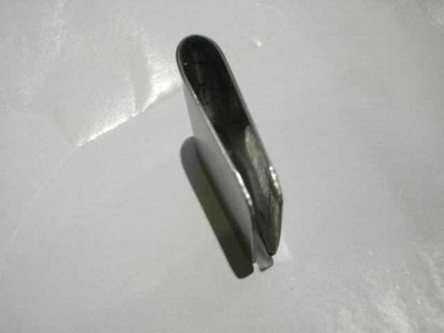

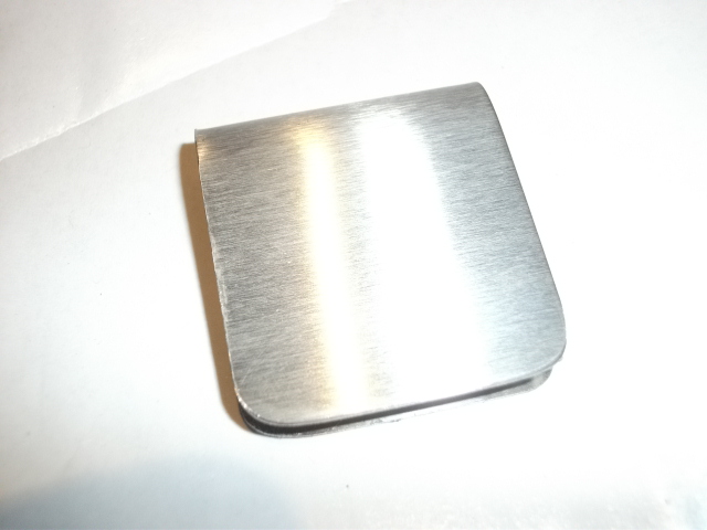

    Hi Irving,
    I have just cut and bent this. it is 7mm inside (but springs inwards to 5mm at open end) 40mm x 34mm at the moment. I need to deburr and finish. If it is too long let me know. Otherwise I need a quantity on this order and a despatch address as a PM.
    There is the option of a black neoprene (?) foam 1mm thick if you want it lined with it. I can also offer cork and neoprene gasket if that would be better.
    Cheers,
    Rob
  10. Rob,That's brilliant, thank you. I need two identical ones. It has to fit over 6mm glass so 7mm with something internal like a thin neoprene sheet would be fine, as long as it stays put. 1mm neoprene might be a little thick though. Being pedantic, the only thing I'm not sure about is how tight that will sit against the edge of the glass, the commercially available, but too small, ones look squarer in profile
    Is it magnetic? Or will I n<script id="gpt-impl-0.25115873216392326" src="http://partner.googleadservices.com/gpt/pubads_impl_75.js"></script>eed to glue some thin steel sheet to the back?
    PM on its way.
