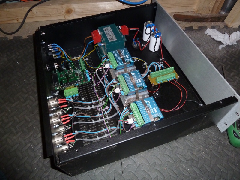

    I am in the process of making my control box. It is made of:
    - 4 x AM882
    - cheap 5 axis BOB
    - DIY linear PSU
    - VFD
    It all fits nicely inside an old computer box I've got. I am currently looking for an easy way to connect it all together. I have done a few researches and saw one control box where I really like the wiring: http://www.monkeyfx.co.uk/pictures/c...roller2-sm.jpg
    So, I have a few questions:
    General questions:
    What kind of crimp terminals would you recommend ? Where is the best place to find the ?
    I have read on here that I can use 0.75mm2 cable. Is that alright ? Can 1mm2 do the job ?
    Drivers to BOB:
    Flexible PC wire (gotten from old PSUs), ferrule at both ends, and a male-female connector in the middle for easy wiring plug / unplug. The hard thing is that all PUL+, DIR+ and STEP+ are going to 5V+. There is only one 5V+ screw terminal on the BOB, so that's 3 to 1 wire per driver, and a total of 12 wires going into one screw terminal block.. there's just no way this is going to work.
    Motors to control box:
    GX16 4 pin connectors.
    Limit switches to control box:
    GX16 2 pin connectors
    PSU to drivers:
    On this picture (http://www.monkeyfx.co.uk/pictures/c...roller2-sm.jpg) there is a sort of multiplexer terminal block. I don't know the correct technical term, but I think you see what I mean. Where can I get those ? Or what would be a good way to get a 2 to 8 pin terminal block ?
    VFD to BOB:
    Crimp terminals, single wire pin to pin.
    Could you share your experience building control boxes and DOs and DON'Ts ?
    Thanks a lot !

    Drivers to BOB:
    Flexible PC wire (gotten from old PSUs), ferrule at both ends, and a male-female connector in the middle for easy wiring plug / unplug. The hard thing is that all PUL-, DIR- and STEP- are going to enable. There is only one enable pin on the BOB, so that's 3 to 1 wire per driver, and a total of 112 wires going into one screw terminal block.. there's just no way this is going to work.
    Where do you get this info from? Have you a link to the BOB? Have you drawn a schematic of what you are trying to achieve ?
    Do a search on the forum for control boxes.
    Here is the BOB manual. It seems to me that there is only one enable pin. Otherwise you have to use the 4 pin serial connectors, which I have no idea where to get the matching males..

    Ok I don't see anywhere in the BOB manual that you connect all the pul, dir and step to the enable pin. So not sure where you are reading this.
    Oh wait, that's right, sorry, I mean that all STEP+, DIR+, PUL+ are going to pin 5V+, which makes a total of 1 pin on BOB going to 12 terminals (3 on each driver). Excuse my mistake :) There are still 4 wires (on for each driver) going to 1 screw terminal, I don't think that can fit easily, looking at the size of the screw terminals.

    You link all the +ve on the driver as you only need one wire to carry the +ve to the driver as it shows on the BOB manual page 3 Hope this helps
    I see what you mean :) It does help ! I need wire splicers to split the 1 to 3 cable once close enough to the driver then, is that correct ?

    No just connect the +ve to the first terminal then with a short link connect that terminal to the second and then the same for the third.

    No power reduction will happen ? Weird, seems like a parallel connection to me, but that's where I am a total beginner :) Thanks for the advice !

    It is a parallel connection as it would be if you connected all the cables to one terminal. As regards power reduction the driver signals are only in mA say about 10 so you can use very small dia wires Cat 5 is ideal
