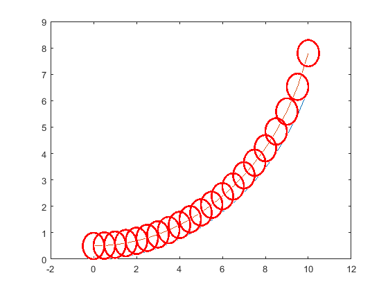

    To cut the correct concave profile, you need to cut along a diameter which is the tool diameter subtracted from the diameter of the surface you wish to cut. Having looked more carefully, I can confirm that Terry has done this (the line #1000=[#1040-#1030]), so barring other errors, he is not a muppet, at least in this case.
    I plotted a graph to demonstrate. The blue line represents the desired surface, red line is the toolpath (so an arc of radius [r_surface-r_tool]), and the red circles represent the tool. You can see it touches nicely at a tangent.

    So, sorry Rufe0, but in Jazz's words, you apparently are a muppet!
