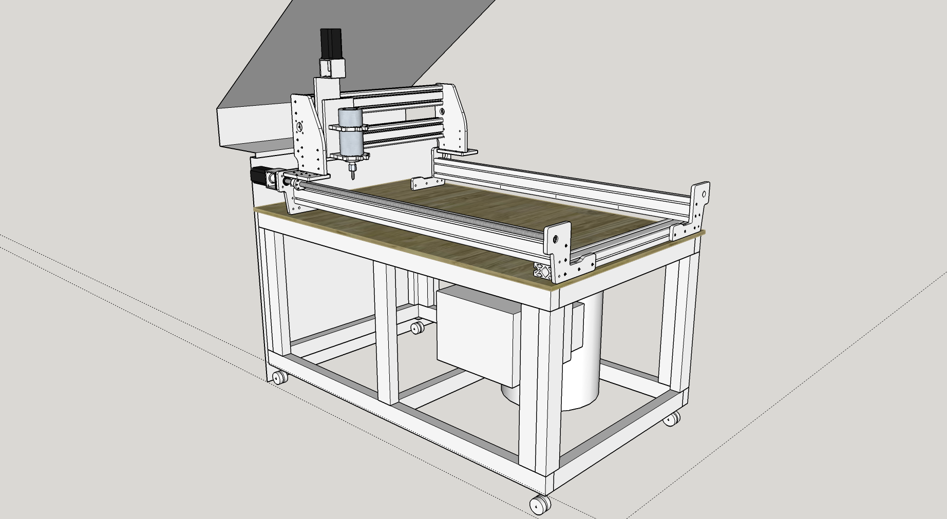

  9. #107
    Hey guys....
    Ended up redesigning my room to fit in my new machine.
    Then I decided that I needed a new floor and that the walls needed painting, so I've been doing that. Workshop is looking great now!
    All the electronics parts are now in and the decoration is nearly complete.
    So hopefully get back on it in the next week or so.
    Here is a picture of the stand I am going to build, for my machine to sit on showing control box and dust extractor under the table.
    The machine has to be on wheels as it blocks a hatch door into my loft. I will need to be able to move the machine out the way for access.
    I have got a sloping ceiling, so I had to work out how high i could make the stand.
    Would like it a bit higher really, but this should be just about ok.
    Will post lots of pics of my build as I get into it.

  10. #108
    Guys..
    Just a thought. Would you say it's a definite no-no to run the shielded VFD to spindle cable in the same drag chain as the rest of the shielded cables to steppers / sensors ?
    It would be real ugly to have this cable floating around or to have two drag chains.
    Martin
  11. #109
    In an ideal world you run power down one side and signals down the other. There are lots on this forum happily running everything together. If your power cables and signal cables are all shielded then it should be fine.
    Neil...
    Build log...here
  12. #110
    Yes it's fine and if it's water cooled Spindle just try to put the water pipes between signal and power cables. Provided you have correct grounds then you shoudln't have any troubles.
