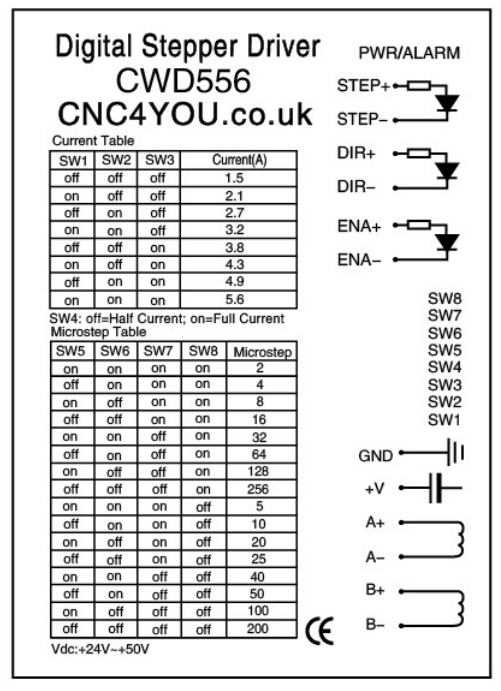

    Quote Originally Posted by mturneruk View Post
    Could this mean the drivers are at at fault in some way. Something to do with all those dip switches possibly ?
    Overheating, protection kicking in or something?
    No guarantees, but I saw something very similar when I first set up my 3D printer. What's the max current setting on your drives? Yes, decode those DIP switches! Could be that if these are set too low, you are just not generating enough torque to move the spindle under cutting load.
  5. The Following User Says Thank You to Neale For This Useful Post:
  6. #165
    I hope your right.
    I have current set to 3.8 as recommended by CNC 4 You.
    e.g.
    SW1. Off
    SW2. Off
    SW3. On
    SW4 is set to off. (e.g. Half current mode).
Name:	stepper cwd556.png
    Edit : I am running 10 Microsteps.

    Just re-reading Jazz's post Number 132.
    The Amps should match or be close to the Motors rating as possible. Good drives will let you set exactly to match motors but If no exact match then set to next lowest. You'll just have lower than rated Torque but better than going higher and having more motor heating.
    Here is a link to the spec sheet for my motors.
    http://cnc4you.co.uk/resources/Stepp...1-03%204Nm.pdf
    It seems to suggest they are rated for 4 Amps (if I understand the spec correctly). Hence the 3.8Amp suggestion i guess.
    So where do i go from here i suppose is the question.

    Like I say this won't be load related because I've pushed cutter thru MDF without spindle running and motors not stalled before material is ripped from bed so with the small DOC and low Feed rate you have been using then it won't be load. Even with a very tired cutter it wouldn't cause this problem.!. . . Again thou easy checked just throw a new cutter in it.!!
    The amps are fine at 3.8A. 2000(10x) micro steps are fine so you have no issues there.
    It's not the drives protecting them selfs, they would just fault and blink at you showing what cause the fault.
