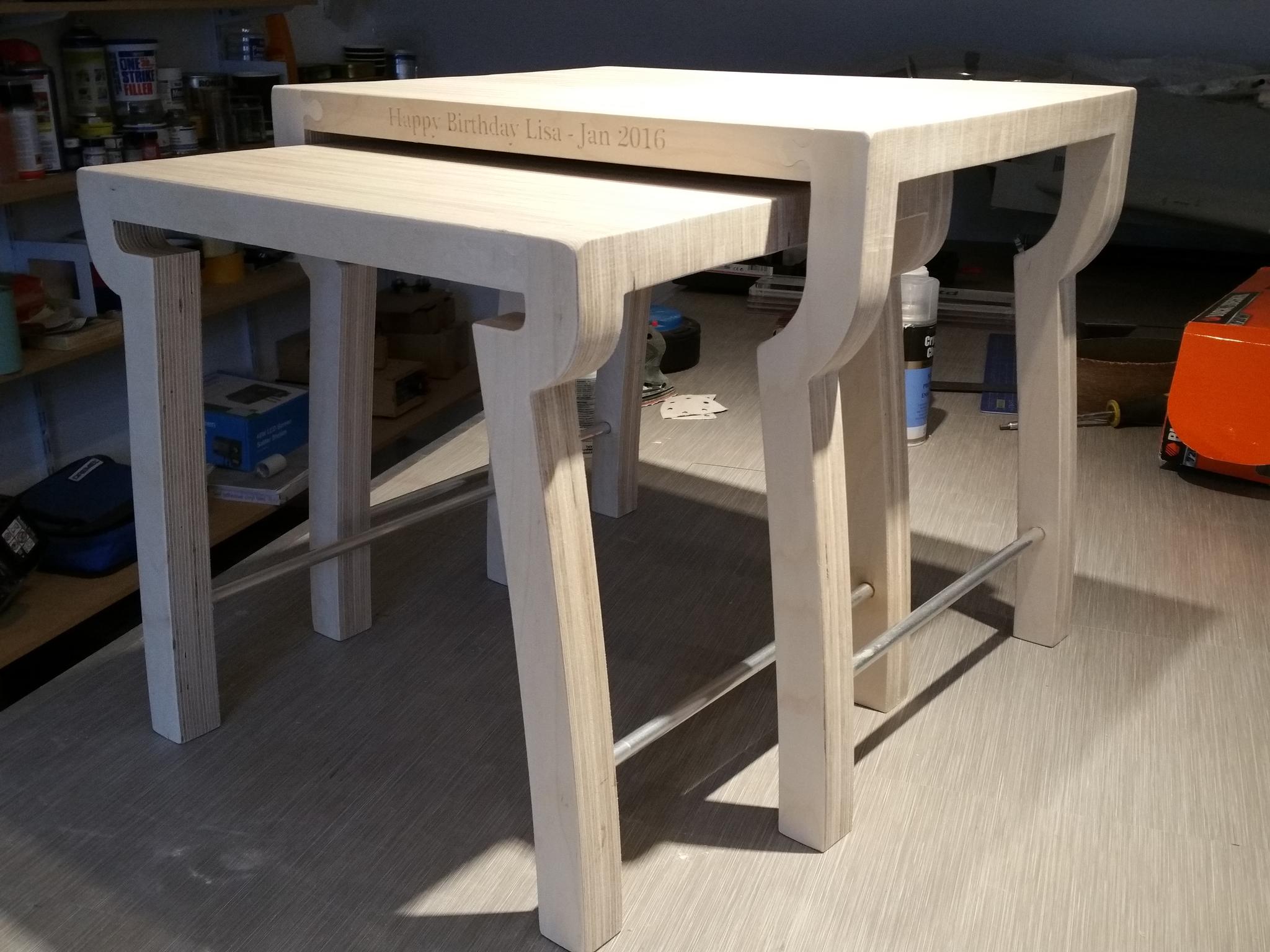

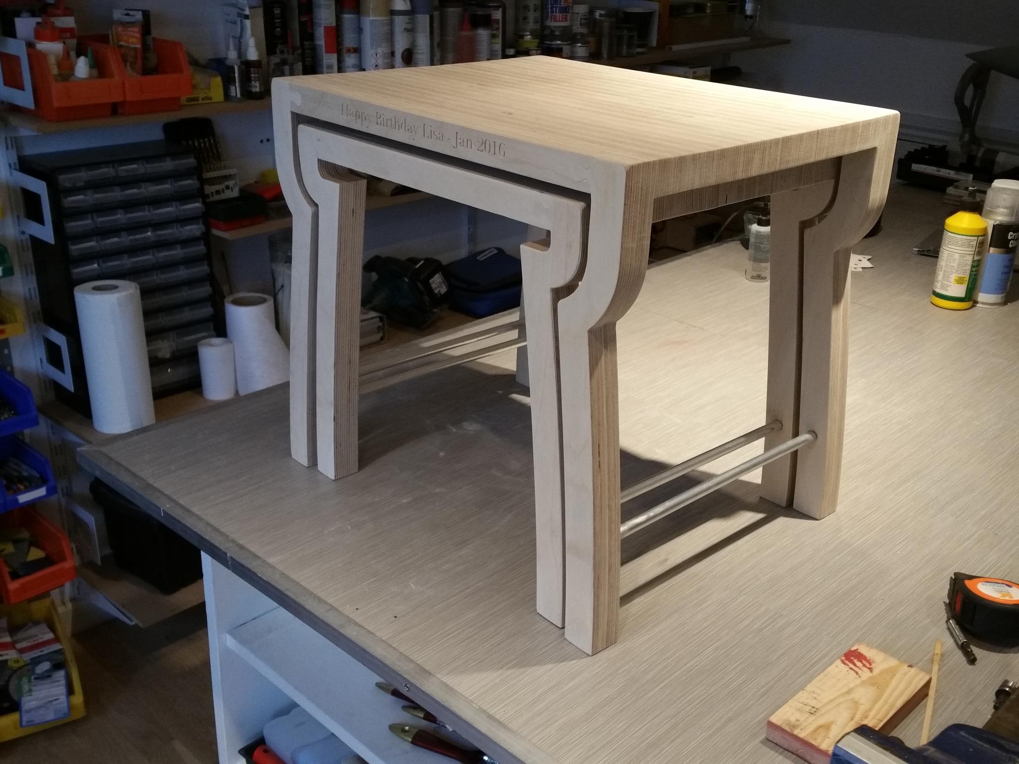

    Following a very kind visit from Komatias, he suggested that I may have a ground loop.
    So before I go off building a new box I am going to to try his suggestions, and see if I can't get rid of my Gremlins that way.
    However the machine is now working well enough to make these. My fist commission!
ID:	17329Click image for larger version.
    Thanks to all of you lovely people who helped me to get my machine going!
