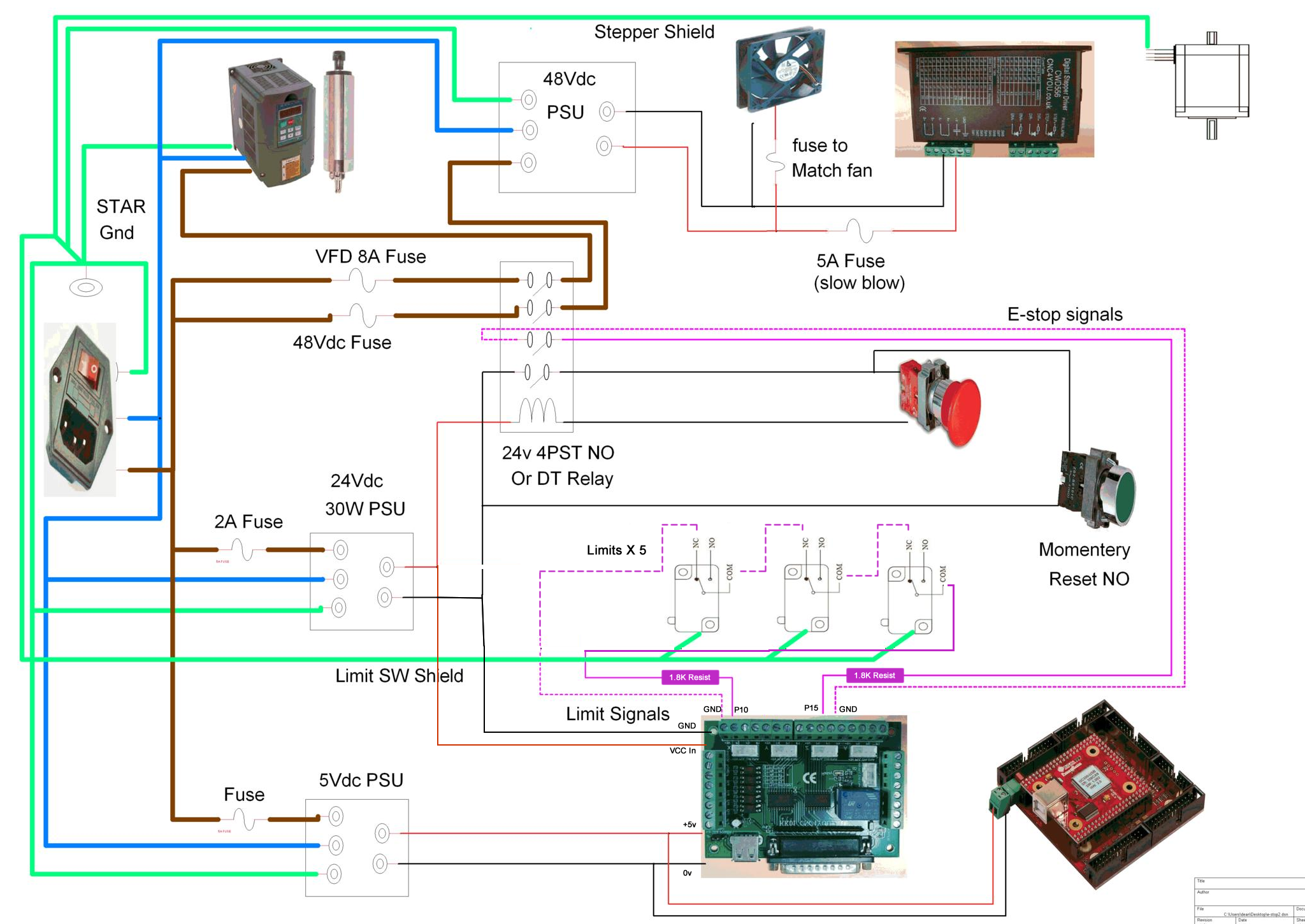

    Ok. So I slept on it.
    Your right Jazz. I didn't want to hear it. Sorry.
    Having a built a machine before and managed to all the wiring myself, which ran fine for 3 years I was not expecting to run into these complications / expenses.
    Also I have been fed some crap information from another source, which I thought I trusted. Not any more.
    I massively respect the fact that you went to the trouble of doing me a really good wiring diagram, and everyone on here has spent so much time answering my newb questions. Thanks chaps.
    So I am fully listening now, and I am signed up to your wiring diagram.
    Questions.
    1. On my previous machine I used a latching emergency stop. Could I use that instead of having the reset button as well?
    That is once you press it in, it stays in until you twist the emergency stop to release. Not trying to cut corners, just wondering if that does the same job ?
    2. Is there any reason why I cant use panel mount fuse holders e.g. http://uk.rs-online.com/web/p/panel-...lders/0563784/
    3. Does this relay look like it will do the job ?. This is an 8A.
    4. I was planning to use 5 limit switches, 3 of which were going to double up as homing switches. I was planning to put a limit at each end of the X / Y axis and one on the Z at the top end of travel.
    I get the fact that 24v may help to stop false triggers, and i understand what your saying about the time delay in the relay for homing.
    EDIT : Just thinking about it and I'm not sure why I need 100% accurate homing?. What sort of inaccuracy with the relay are we talking about do you think?
    I have never used soft limits and I never put jobs on that may go over the limit of the material / machine size. Plus I've got the limit switches on all extents of the travel should the worst happen.
    5. How do these PSU's look for what i need. They are fairly small and the same size which i like.
    5V 3A
    http://www.ete.co.uk/power-electroni...y-5v-3-0a.html
    24V 1A - 20Watts - You spec'd 30 Watts is 20 enough ?
    http://www.ete.co.uk/power-electroni...-24v-1-0a.html
    6. I will run 2 x 24v Fans with filters as you suggested. I have looked and an average 80mm 24v fan is about 0.2A.
    Does the 24v relay use much current, if not then i may be ok with that 20 Watt 24V PSU?
    If I can use those small power supplies then it may mean i don't have to scrap my case which would make me very happy. I will make that decision when i've got all the bits.
    Top shout. Thanks again.
    Martin

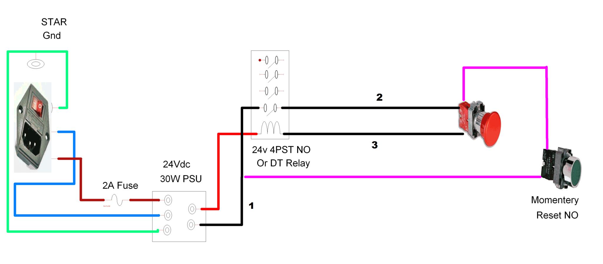

    #1 No can't use it like you think but yes you can use latching E-stop if you have one.
    The fact you asked this shows me you don't fully understand how this E-stop system works so I'll expalin by breaking the diagram down. (See Pic)
    You'll see 24V+ (red wire) going to one side of the relay coil. The other side of the coil needs a path back to 0V for the relay to turn on and close it's contacts to turn things on.
    So follow black wire #1 and you'll see it goes to first Contact of the relay. This contact is Open so the path back to 0v is broken and the relay can't turn on. So we need a way to provide temporary path to ground. This is where the Momentery Button comes in.
    The Pink wire is connected 0V and runs to the NO Momentery switch which when pressed allows 0V to the other side of the Relay contact and provided the E-stop button is Latched on then the path is complete and the Relay turns ON and the Contact closes providing another Path to 0V.
    Now when you release the Momentery button the relay stays latched ON using the new path until the path to 0V is broken again. IE Hitting OH Shite Button.
    This means we created a Latching circuit so When you release the E-stop button the Machine can't just set off. The Momentery button is the safety and will only let the Relay Latch on again provided the E-stop button is Set. On more advanced systems you'd have all sorts of other safety checks, like door switches etc but the principle is the same.

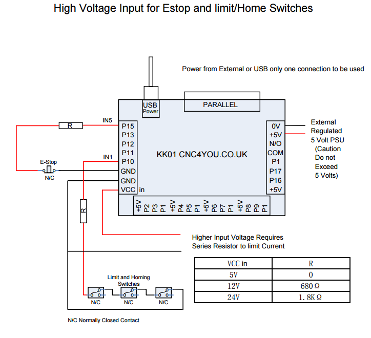

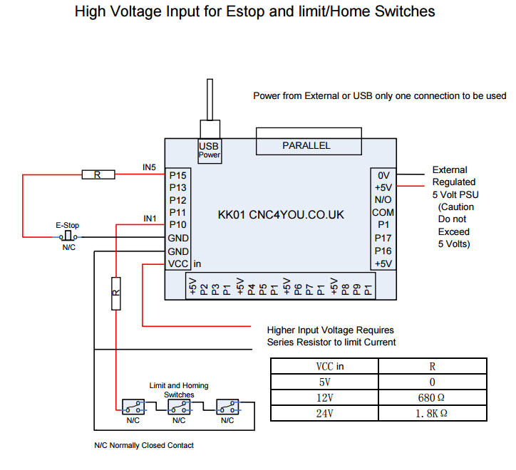

    Just been looking at the KK01 breakout board wiring diagram (below) from CNC4YOU and it says you can use 24v with it for the limit switches as long as you add some 1.8K resistors.
    Looks like i would have to add one in the Estop signal wire as well.

    I think that would mean that I can do away with that second relay. I have modified your wiring diagram with what I think I can do.
    See below. Make sense ?

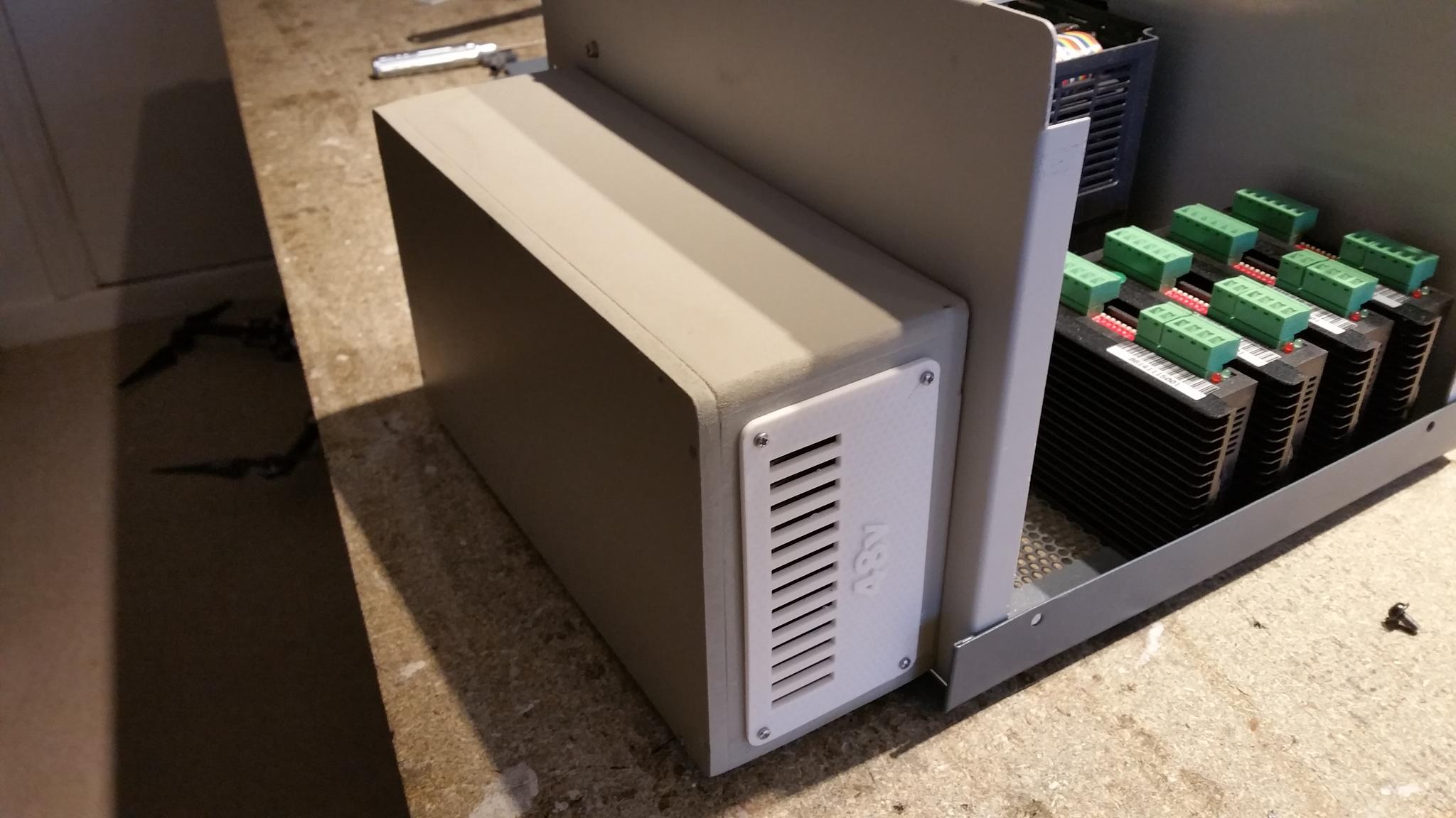

    I have made some more space in my enclosure. The 48V PSU now mounts on the outside of the enclosure back panel. I have made up a box with appropriate venting to enclose it. I even painted it the same colour. This will make a big difference to the space I have to play with inside.
    I decided it was "Out of the box thinking". LOL

    Actually this is getting more complicated.
    It looks like if you use that 24 volt input to the VCC in on the KK01 breakout board, you need to put resistors in the output to the drivers as well.
    Think your relay idea might be simpler after all.
    Would proximity switches be less prone to giving false readings?
    And avoid the need for the relay?
    And be more accurate ?
    It looks like they are powered separately from the signal line.
    Here's a link to the manual that shows the switch wiring.
    http://cnc4you.co.uk/resources/KK01.pdf
    Martin

    Martin The 24V line is only for the limits + estop. The driver signals are output from the BOB that will be 5V so no resistors needed.
    The Estop line to the bob is at 5V as it is isolated by the contacts of the relay (ie fed from the BOB through the relay contacts and back to the BOB) .
    If you go with sensors then you would not need the 24V SPST relay but then to be safe I would put a 1k resistor in the signal line ( usually black wire) to limit current.
    Have you thought about taking the VFD out of the box instead of the 48V PS.
  10. #59
    Yeah Clive. But it won't work so nicely.
    This way the whole thing stays all as one unit with the controls for the VFD on the front.
    I 3d printed the white cover, which when removed allows me to access the terminals without taking the box off completely.
