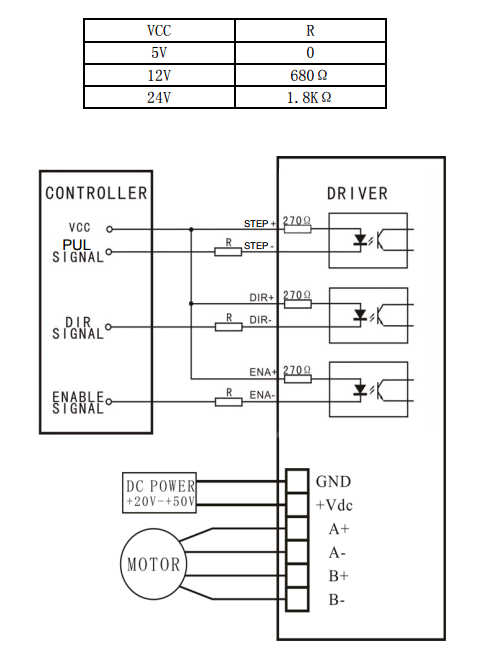

    What confused me was this diagram in the KK01 manual showing that I might need to put extra resistors in the driver wiring as well if I was running 24v through the KK01.
    That put me off.

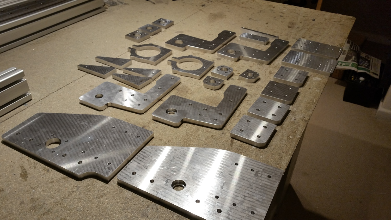

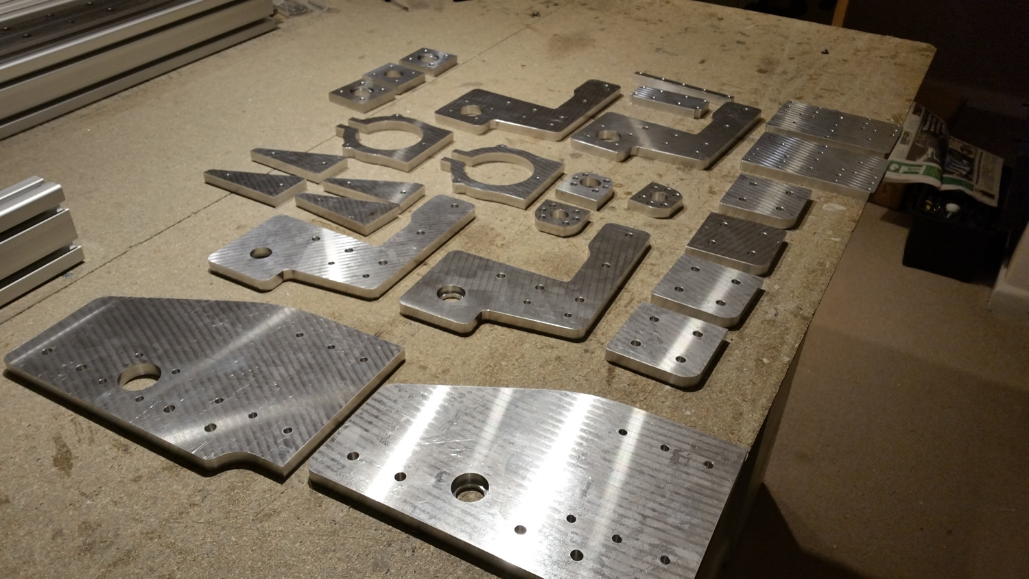

    Look what I got this afternoon - happy days!
    My cousin cut them for me in his engineering shop.
    The CNC mills he's got are serious.
    They are perfect the bearings have dropped in beautifully.
    So I can start building my machine now.
    Thanks Jazz for your excellent input.
    That put me off.
    Talkiing about Different things there.! Drives use OUTPUT signals meaning they recieve signals being OUTPUT from the BOB.
    INPUTS are expecting to see signals coming INTO the BOB. They are different and separate to each other.
    That put me off.
    The resistors are to limit the current going into the opto-isolators at the front end of the KK01. In crude terms, these opto-isolators are designed to accept 5V signals so with a higher voltage, you need to limit the input current to a safe value. It's a very straightforward and common thing to do. Those resistors will cost you about 3p each from your local Maplin so no exotic components needed!
    The KK01 needs 5V in any case; the 24V supply is just to feed the limit switches. As Jazz says, the KK01 will still give a 5V output to go to the drives.
