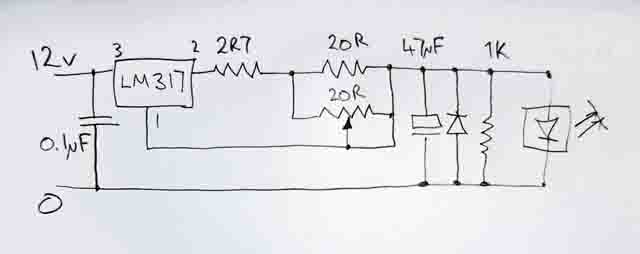

    The circuit I've used is *very* similar to the one you show - An LM317 rigged as a current regulator.

    The LEDs/LASER circuit draws 180mA (I've got it 'turned down' while I'm testing) whatever the BOB outputs. That's the same as it was drawing when I plugged the LED circuit straight into the 12v supply, without this FET switching malarkey.
    More background:
    The 12v supply is from a 'wall wart'. Transformer, 4 rectifying diodes and a capacitor.
    The LASER driver circuit that came with the LASER looks like this...
