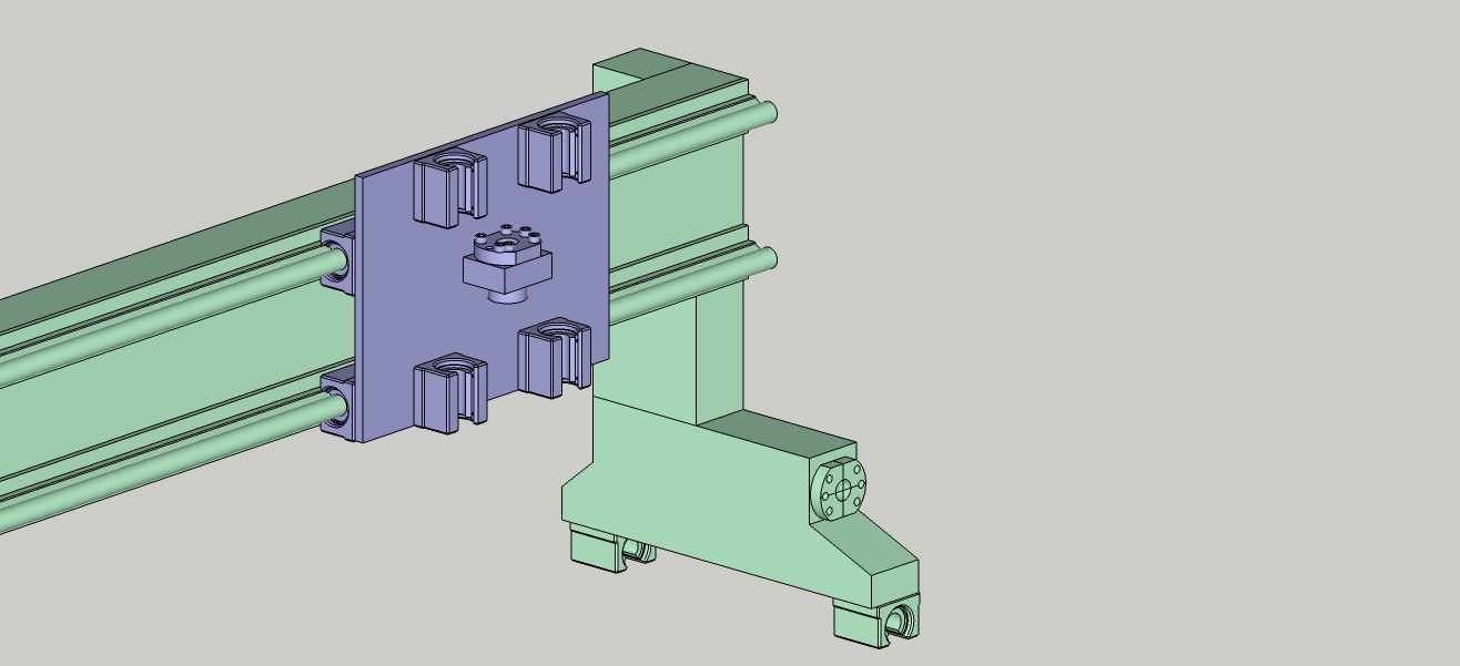

    hi , a bit off topic but can these rails be used on their side? Click image for larger version.

    Yes
