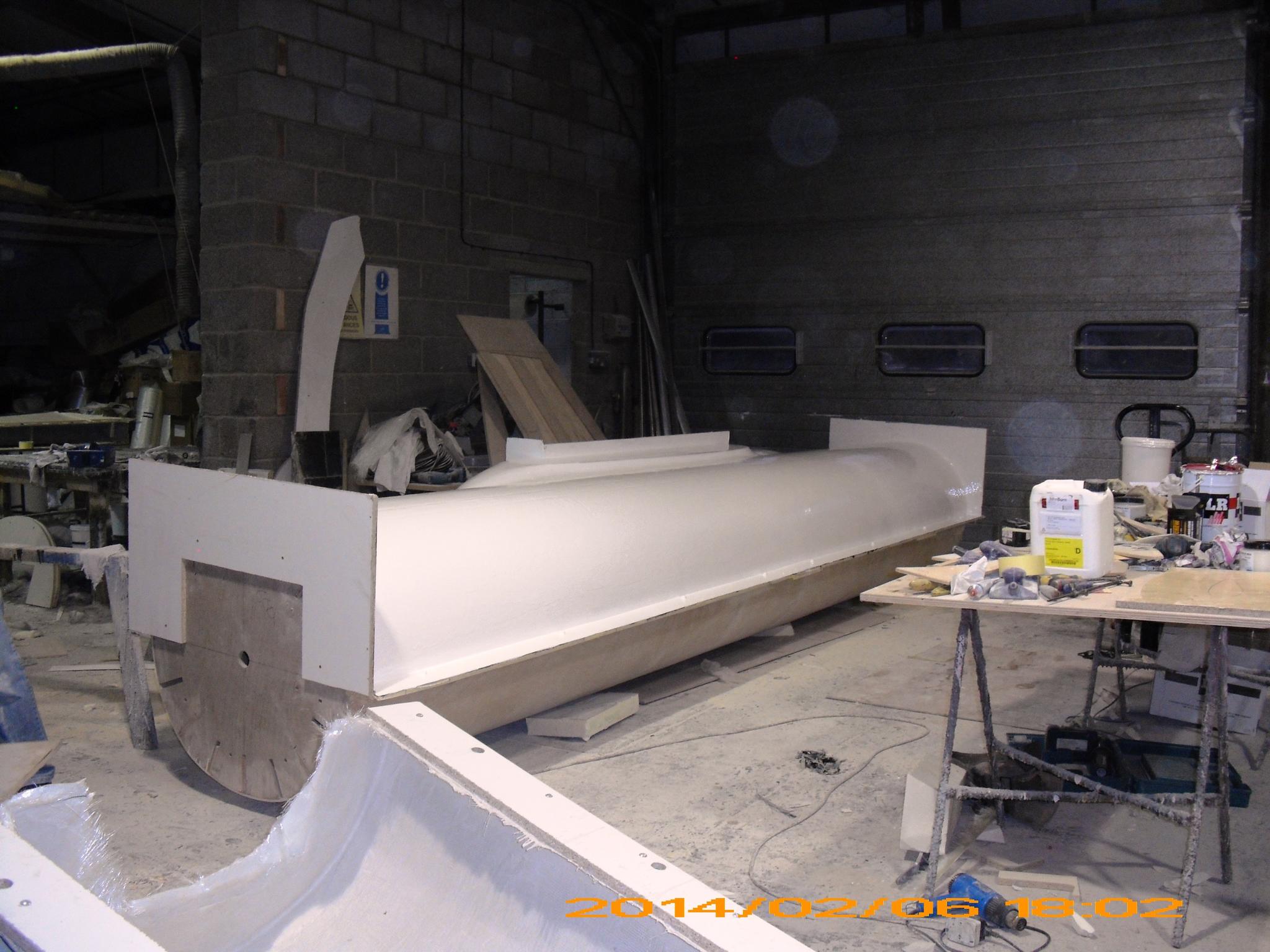

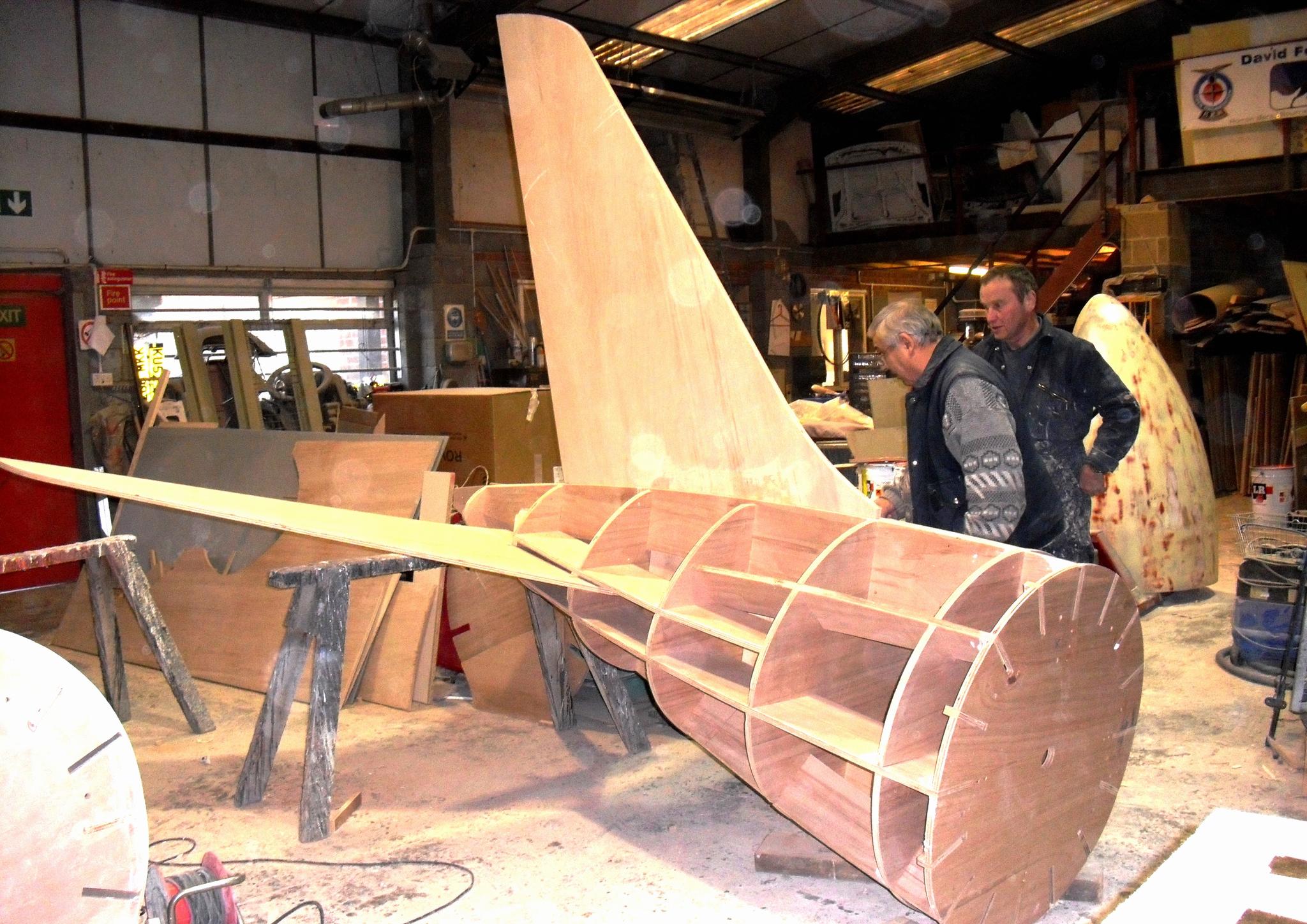

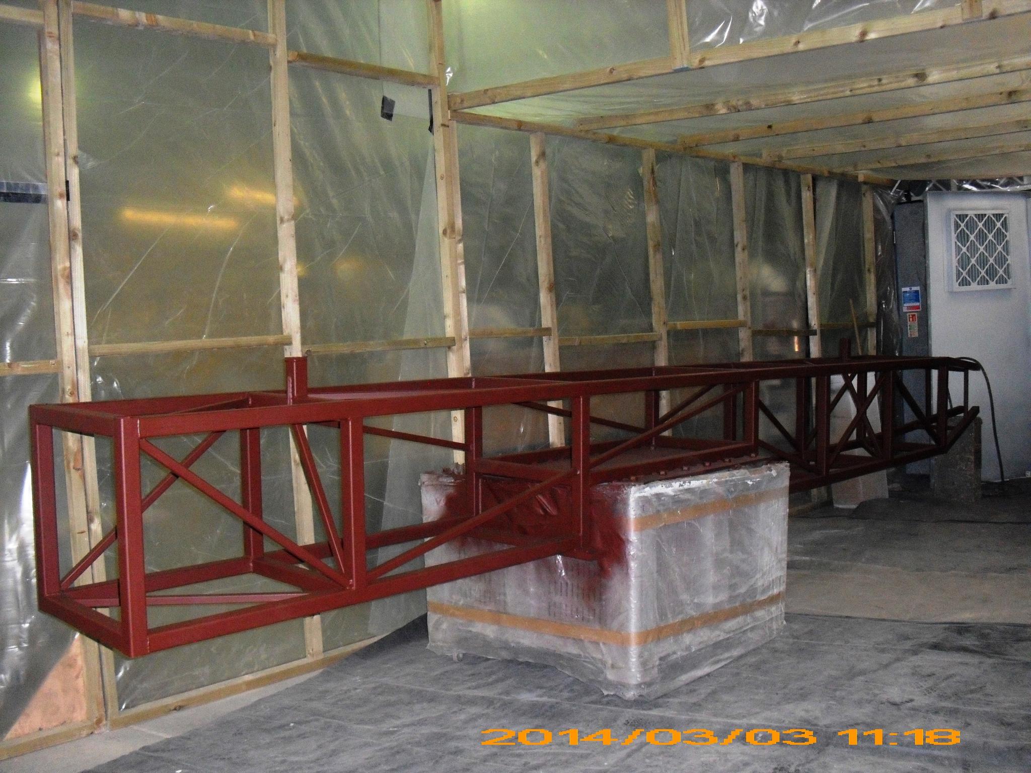

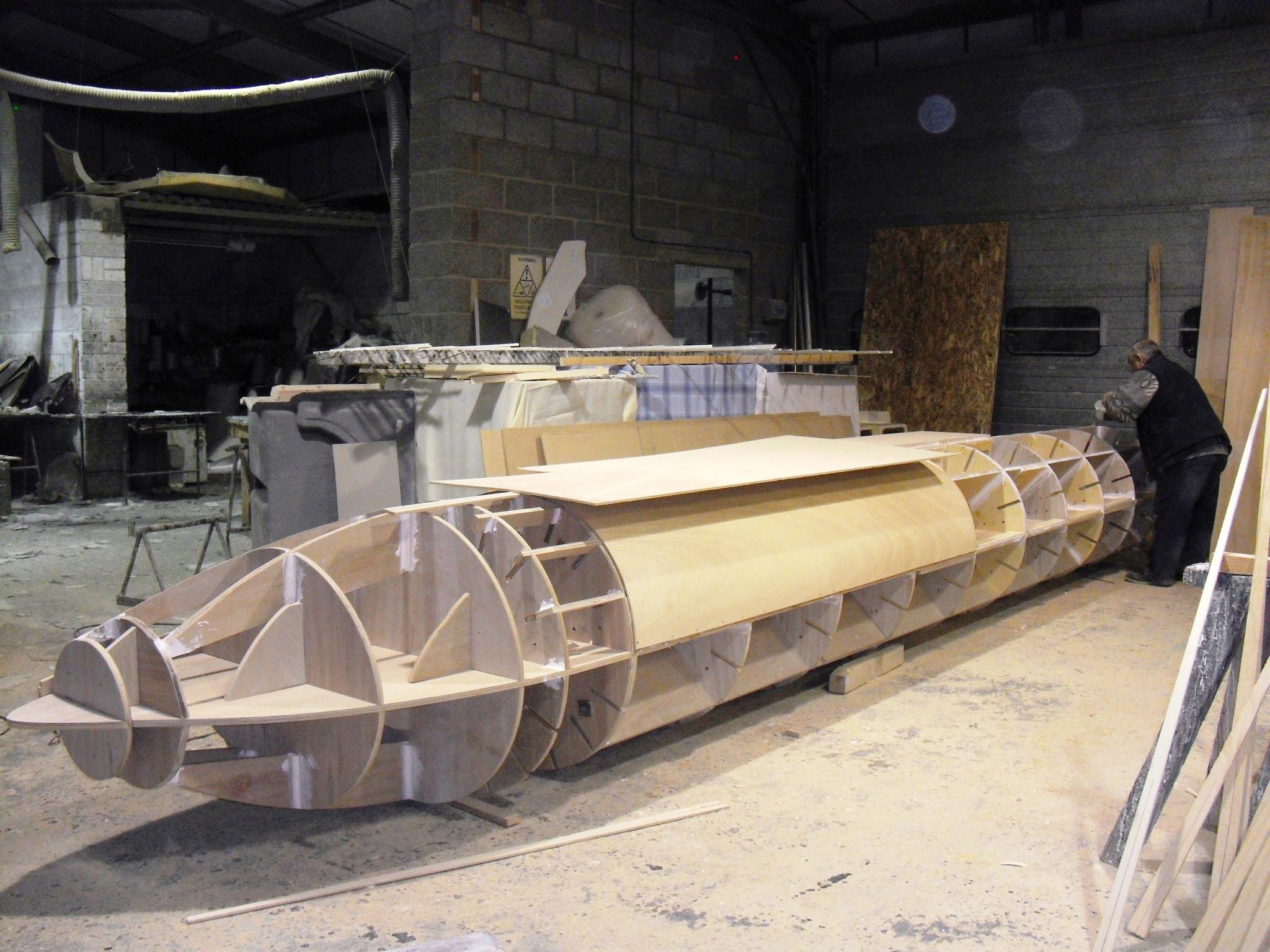

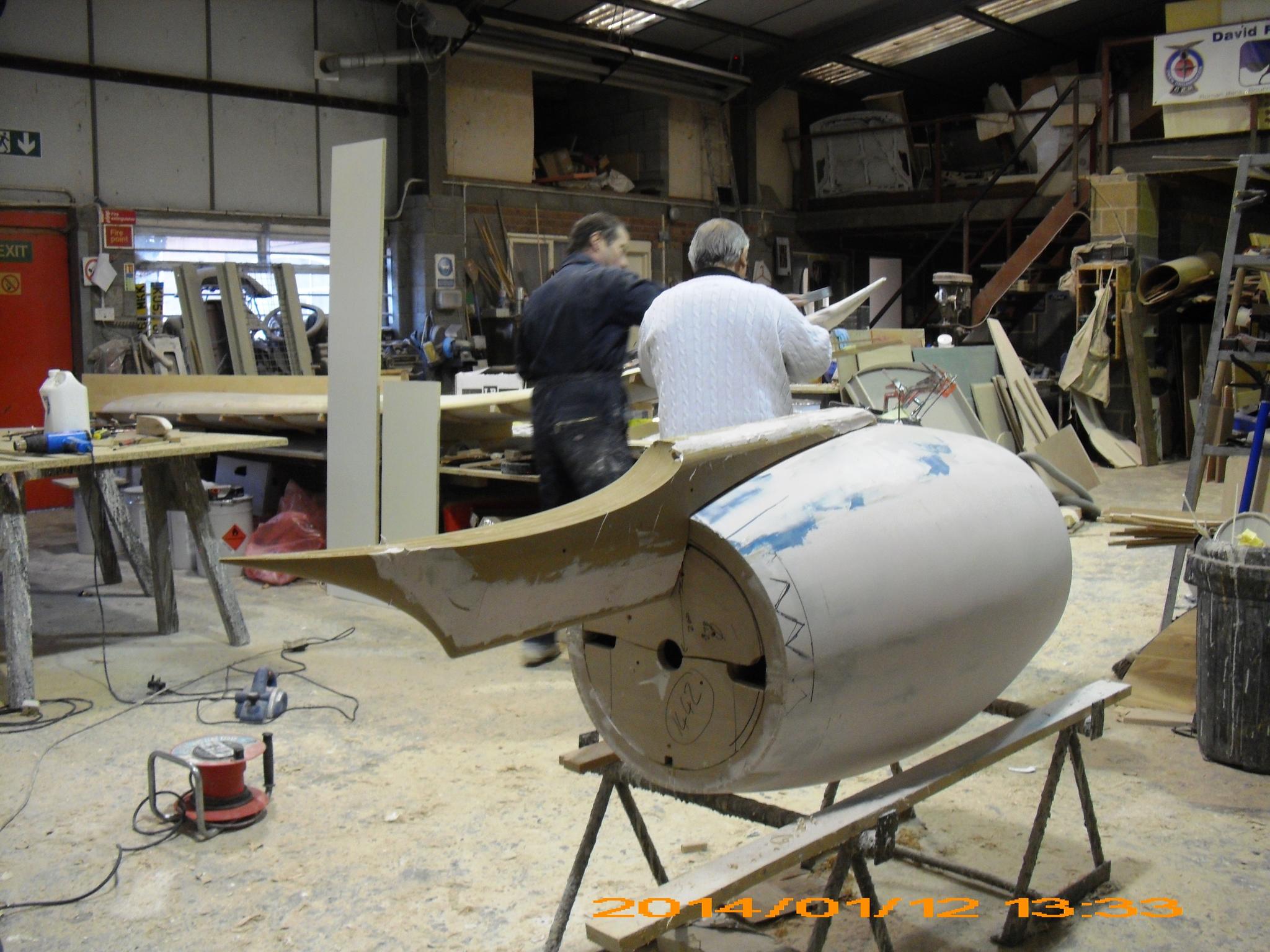

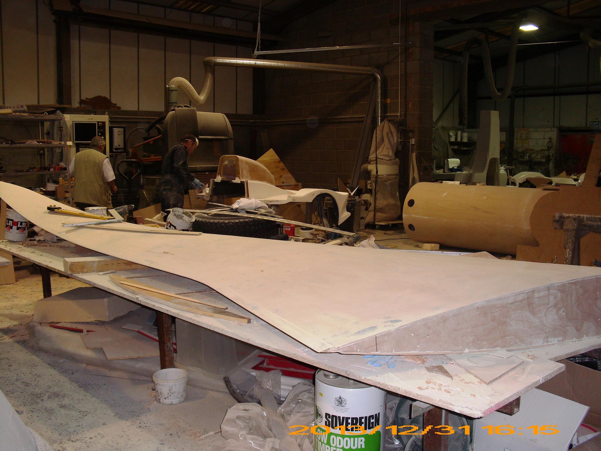

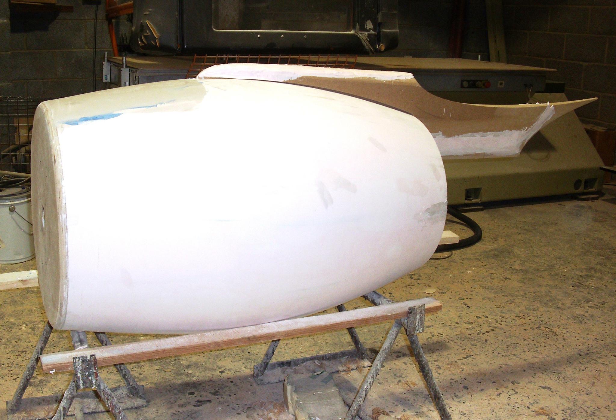

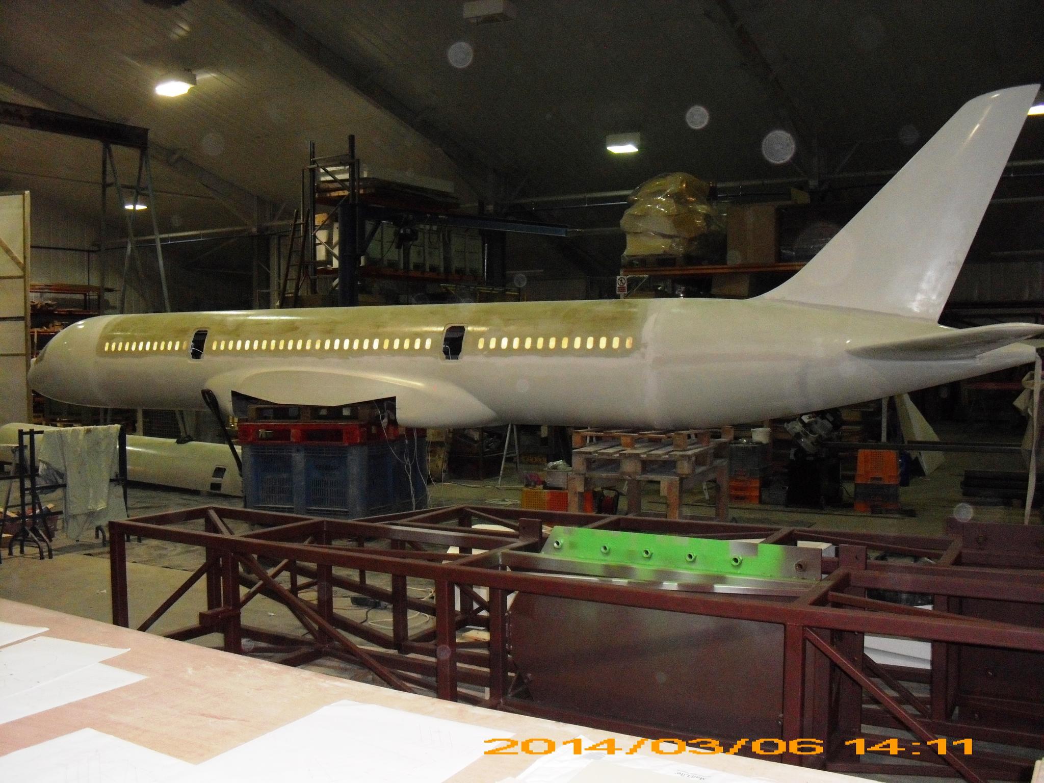

    About two years ago shortly after the purchase and repair of an old SCM 120 router my friend (who has a fibreglass works) showed me a schematic drawing of a Boeing 787 dreamliner and asked if I could make a 1:6.5 scale "plug" (pattern) for it. Of course I can I replied, convinced that he would never get the order for it - well I was wrong!!!
    Anyway, to cut a long story short I decided how the model would be built, drew it up using alphacad, machined the components and with the help of my friend and his workers built up the model in sections. Fibreglass moulds were taken from the pattern and three complete models were built, delivered and erected on the roundabout at Heathrow, terminal 4. I have shown some of the pictures to a couple of members of this site, but now that KC has started this thread I thought that I would share the project with forum members.
    As there are about 30 photos (I probably have 100or more!!!) I would like to post I shall taken it easy on you all and just post a few at a time.Click image for larger version.

    Geoffrey..... Wow!! just wow!. What a fantastic achievement! What were the fiberglass planes used for in the end? you mention heathrow? Are they still on display?
    Hate to say it neil, but this really pisses on your party. :rofl
    Geoffrey, you cant go from nothing, to building these... Therefore I am assuming this is just one of the projects in your photo collection, so while you have it open .....
    thanks for sharing.
  7. #17
    That's fantastic!! Agree with you Matt mine pales into insignificance in comparison!!!! I think I remember seeing a plane on a roundabout when flying from Heathrow a couple of years ago?

    Matt, Neil, thanks for the +ve comments, but my efforts are no better than any others - I think everyones efforts are fantastic. I must admit that when this opportunity arose I was very keen, and am so pleased with the end results. The models are still on display at Heathrow, indeed 6 months after they were errected they were taken down and returned to the paint shop, redecorated in the new ETIHAD livery and re-errected on site. All three models are grouped in a flying position (on pylons) on the roundabout at terminal 4. After leaving the engineering/construction field in 1992 I decided to try to start up a modeling business, but my wife was not too interested, however when I said dollhouses she snapped up the bait!!! CNC machines were unknown to me until I visited a DH builder who had an old Wadkin cnc router. I was captivated. I had to have one!!! I purchased an old PCB drill-router, wasted many hours trying to get it working (I failed) and eventually bit the bullit, bought an AMC4 dedicated controllerand with the help of a friend converted that old machine that I love. A very strong fixed gantry 540mmx450mm 3 axis machine. I have built hundreds of dollhouses, miniatures and models (mainly dollhouse related) since then and even used alphacam to draw up the design for my new house and all the plans required for building regs and planning etc. I would like to add that I am self taught in all things CNC, but I am lucky enough to have a clever friend who has helped - thanks Graham.
    Anyway sorry about the long story (hope it may inspire someone) and time to post the next batch of pics. G.[IMG]desktop[/IMG]Click image for larger version.

    Geoffrey do the Cabin windows have lights in them.?
    Good job they weren't up here last night because they would have lifted off, Pylons an All, with the winds we have.!!
  10. #20
    Hi Jazz, all will be revealed in the next batch of pictures!!! G.
