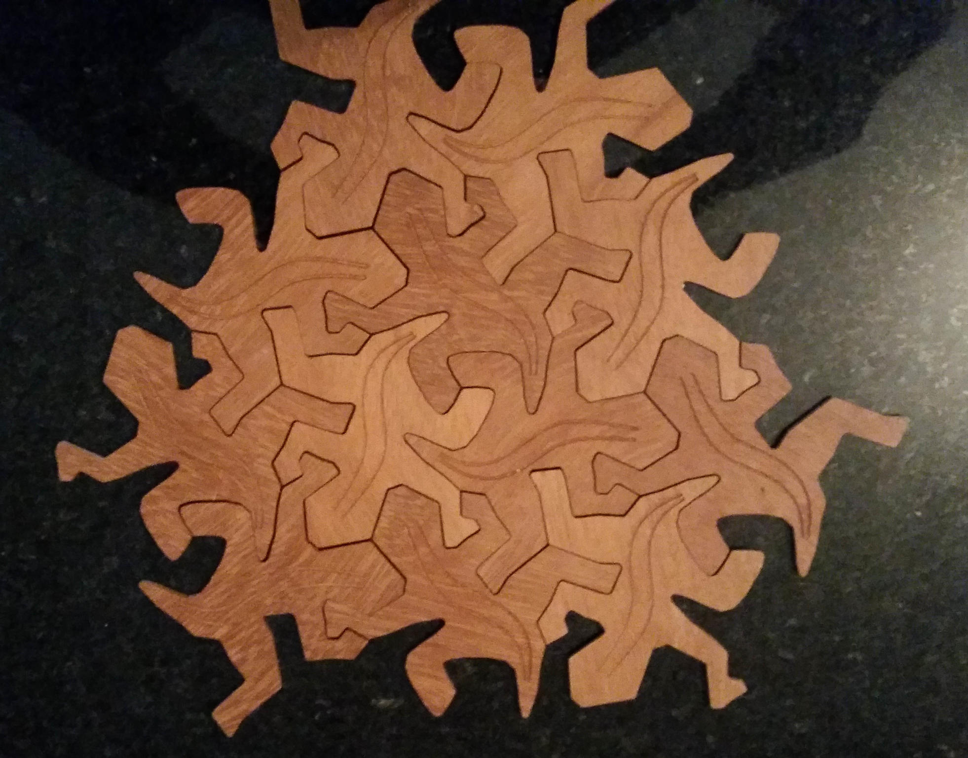

    I would like to lower the tone a bit here... These intricate/large etc models and so on are great, but I tend to find myself a bit discouraged sometimes by seeing beautiful bits of work from others. So, to counter this, and to show something much, much simpler but which goes down well as stocking-filler type gifts at Christmas, here are this year's coffee-table coasters. A set of these separates into individual pieces, but form a conversation-starting jigsaw when assembled. I was originally inspired to make these by the blog I found which described one man's efforts to tile his hall and sitting room with larger versions of the same design. Came out well, too. Mine are in sapele, and show what can be cut with a 3-year-old MDF router that's only just about hanging together still.

    I have seen that vid of he guy in is hall it looked good, have you drawn the dxf.

    Yes, I remember that post, I think gavtheouch was going to do his caravan floor like that. Neale, I think that work is great, and the idea of scaling it to make table mats, coasters etc. was very clever. Your work looks lovely and does indeed show just what can be achieved even with an mdf build. I have often said that I love all CNC machines and I am still amazed at what work can be produced - I just love the fact that it is possible to have an idea, design, draw, cut build and see the idea come to life. Most of the work that I do involves very small pieces, and I had no intention of ever showing the dreamliner build on here until KC started his post. The last thing that I would want to do is "rain on anyones parade". I would also like to add that I think the aztec calendars that have been made and displayed on this site are far superior to any of my own work. G.

    Yes, I found I had to. There are quite a few variations on the same theme, all based on the original "Reptiles" by Escher, but when you look closely none of them quite work (or, at least, none of the designs I found). So I did my own drawing, based around a hexagonal tessellation. But that's probably as much mathematical theory as anyone wants on this forum, so let's just say it took a while to get it right. Then import into Vectric vCarve to do the CAM stuff.

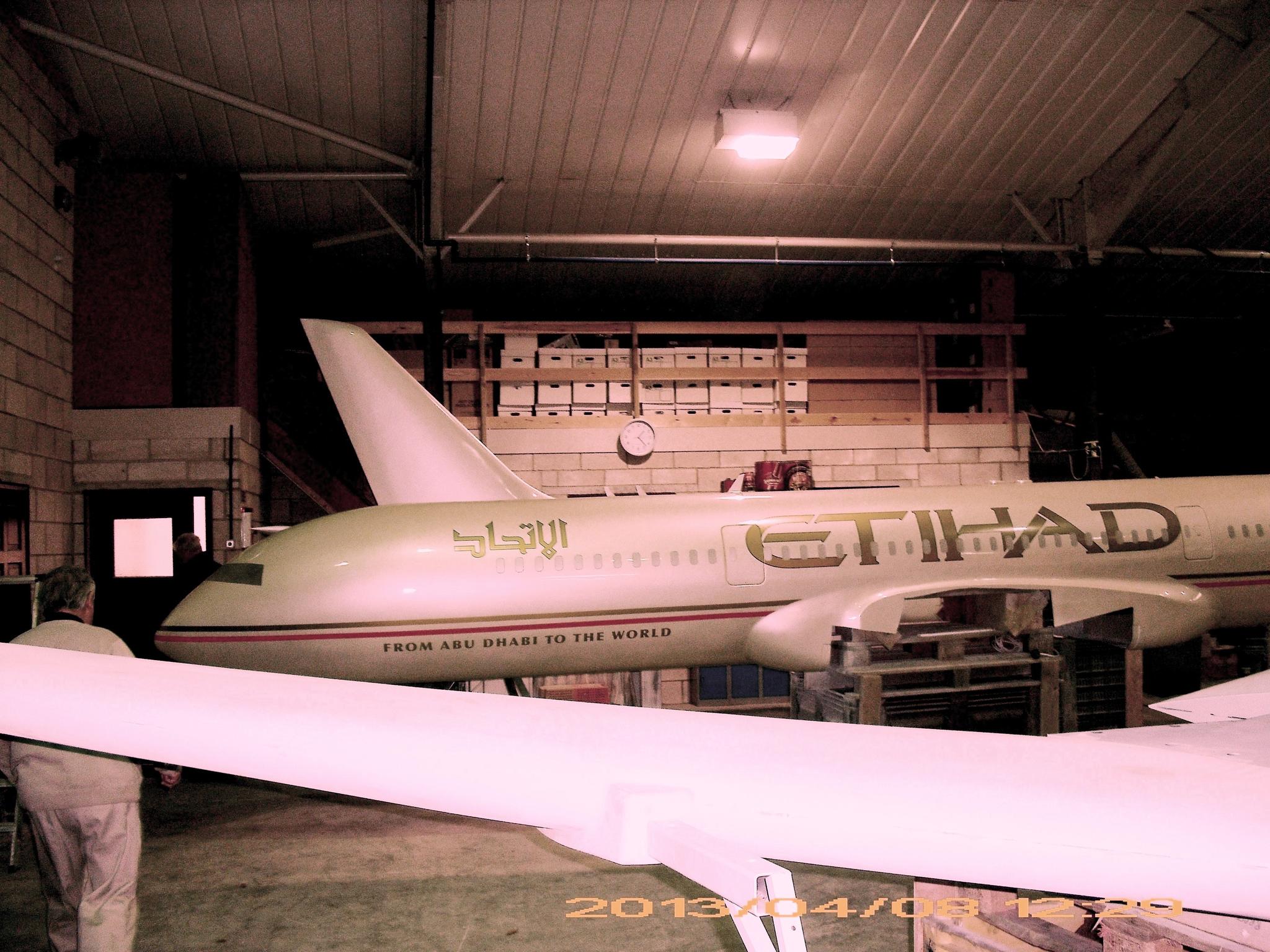

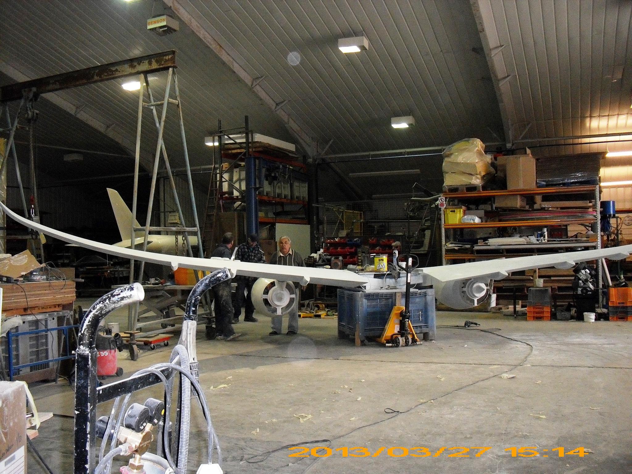

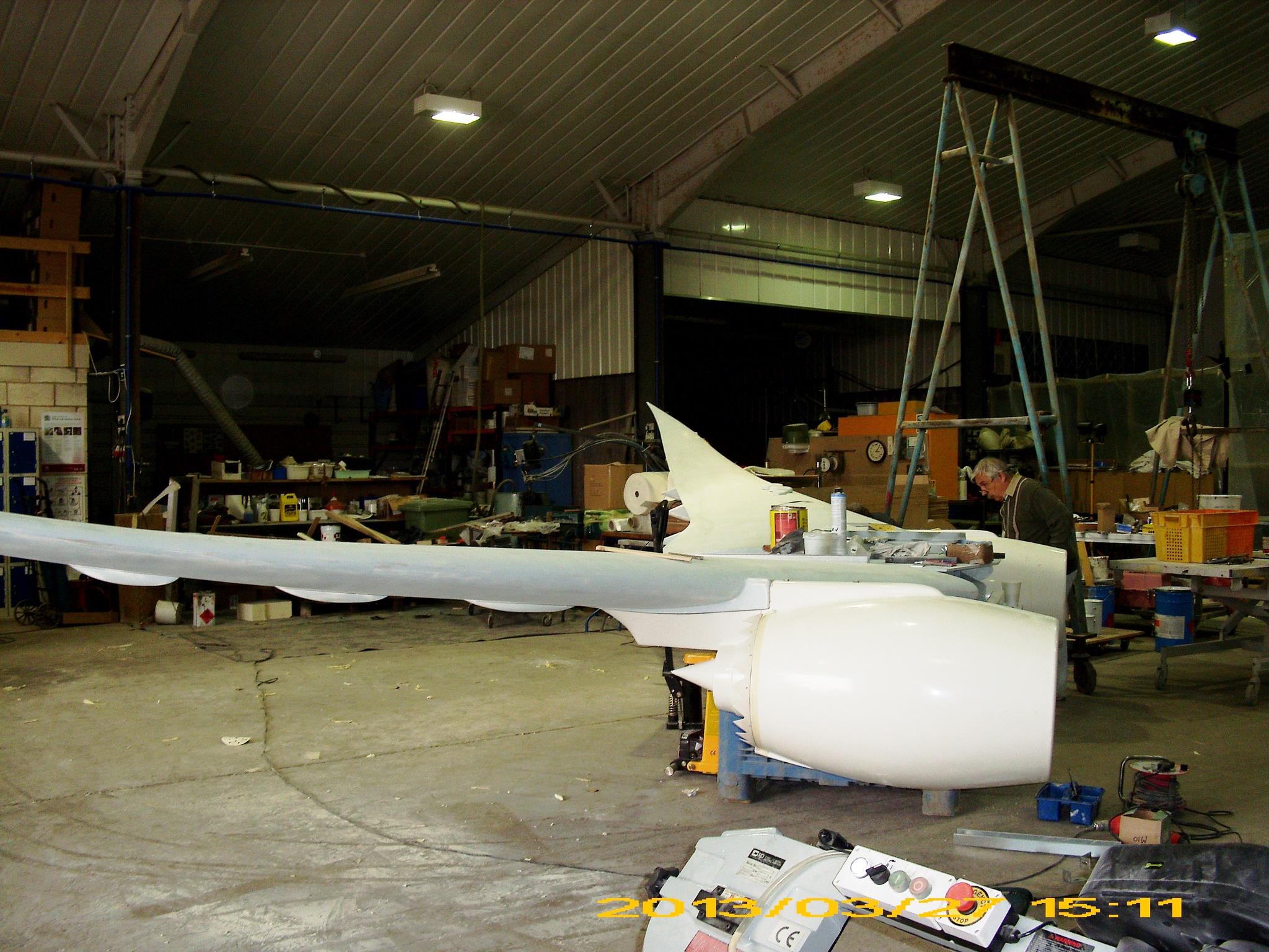

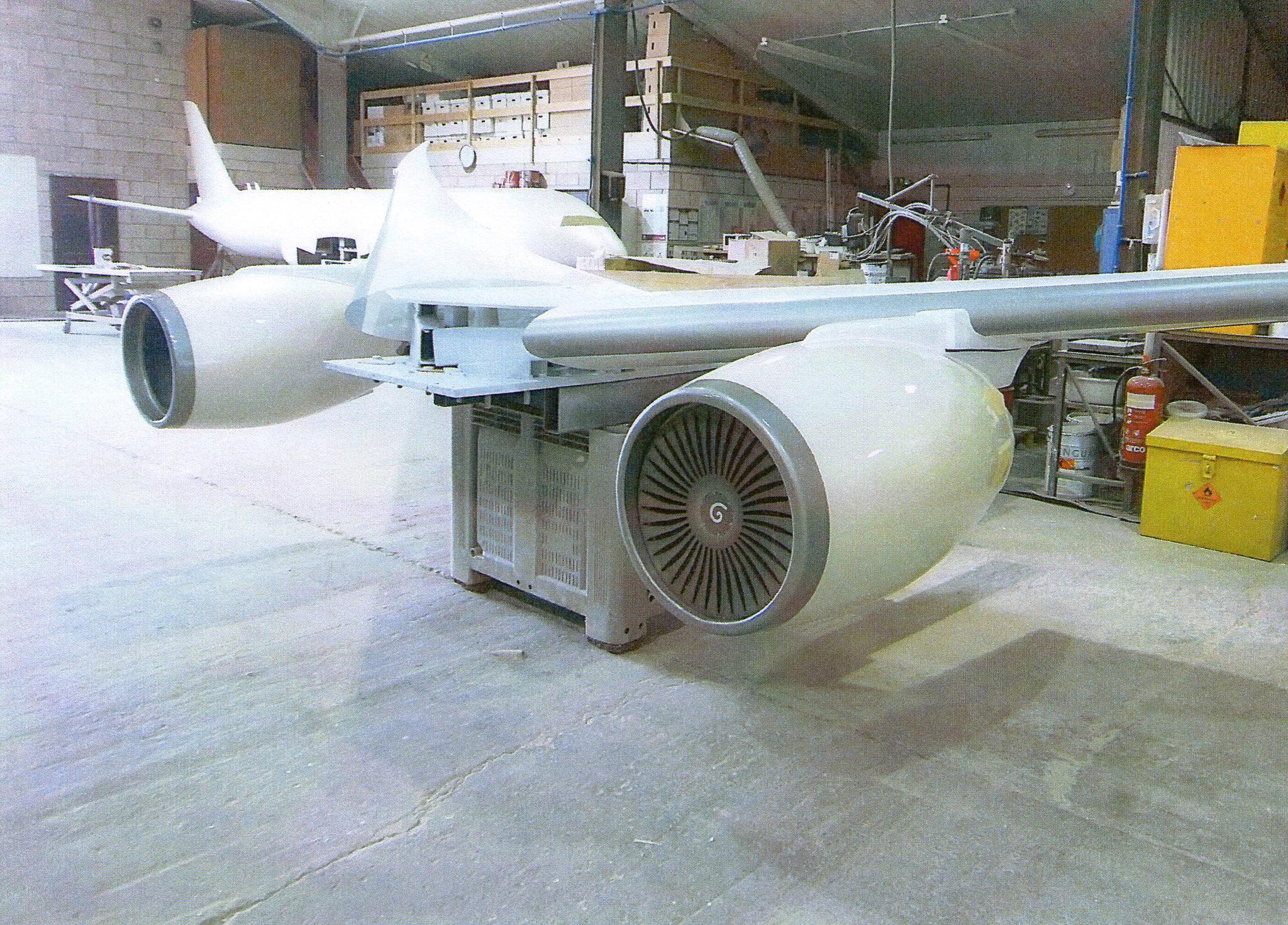

    Well its time now to post the remaining pictures of the dreamliner models at Heathrow. After the patterns were finished moulds were taken and mouldings produced, a steel frame (by others) was fabricated and the steelwork was bonded into the fuselage, wings and tailplane. The fuselage and tailplane sections of the model were bonded together, the wings and engines were trial assembled, but removed for transport. I made shadow masks for the cabin window lights to shine through, fixed to internal light boxes containing LED lighting strips. Cockpit, wingtip and tail lights were also fitted. The aircraft were painted in ETIHAD colours and livery vynals were added. I supplied a dxf of the window shadow masks to allow the vynal chaps to supply a mask for the windows prior to painting. As I said earlier,Click image for larger version.

    six months after the planes were errected they were dismantled and returned to the paintshop for the new livery. I have used the dusk photograph of the three planes as screen wallpaper on all three of my computers!!! G.
