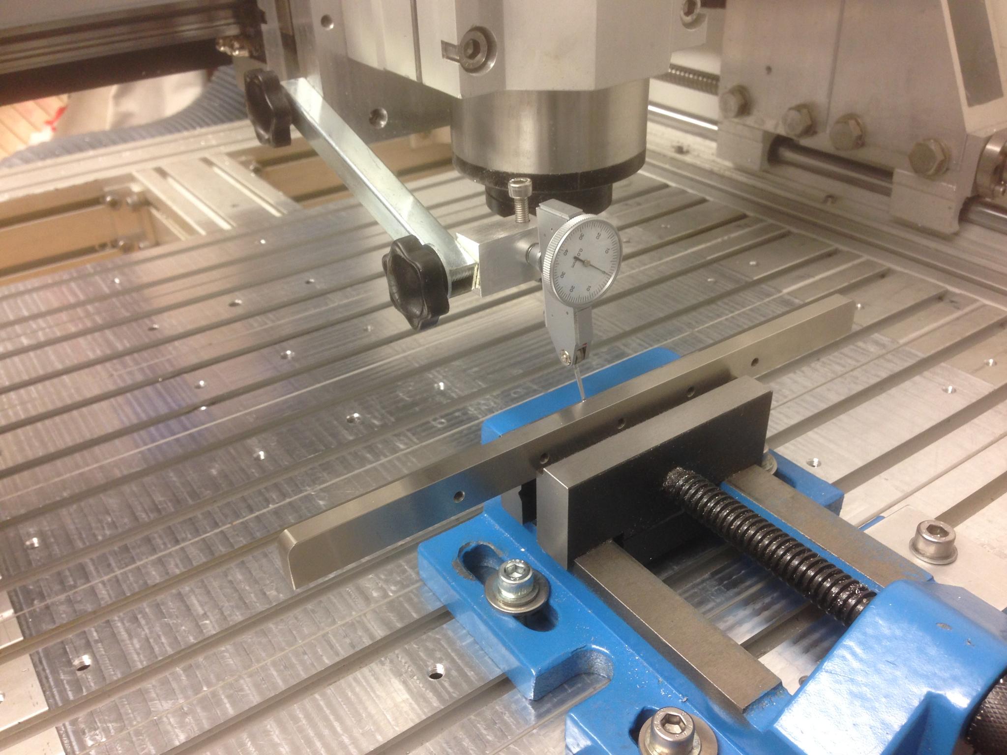

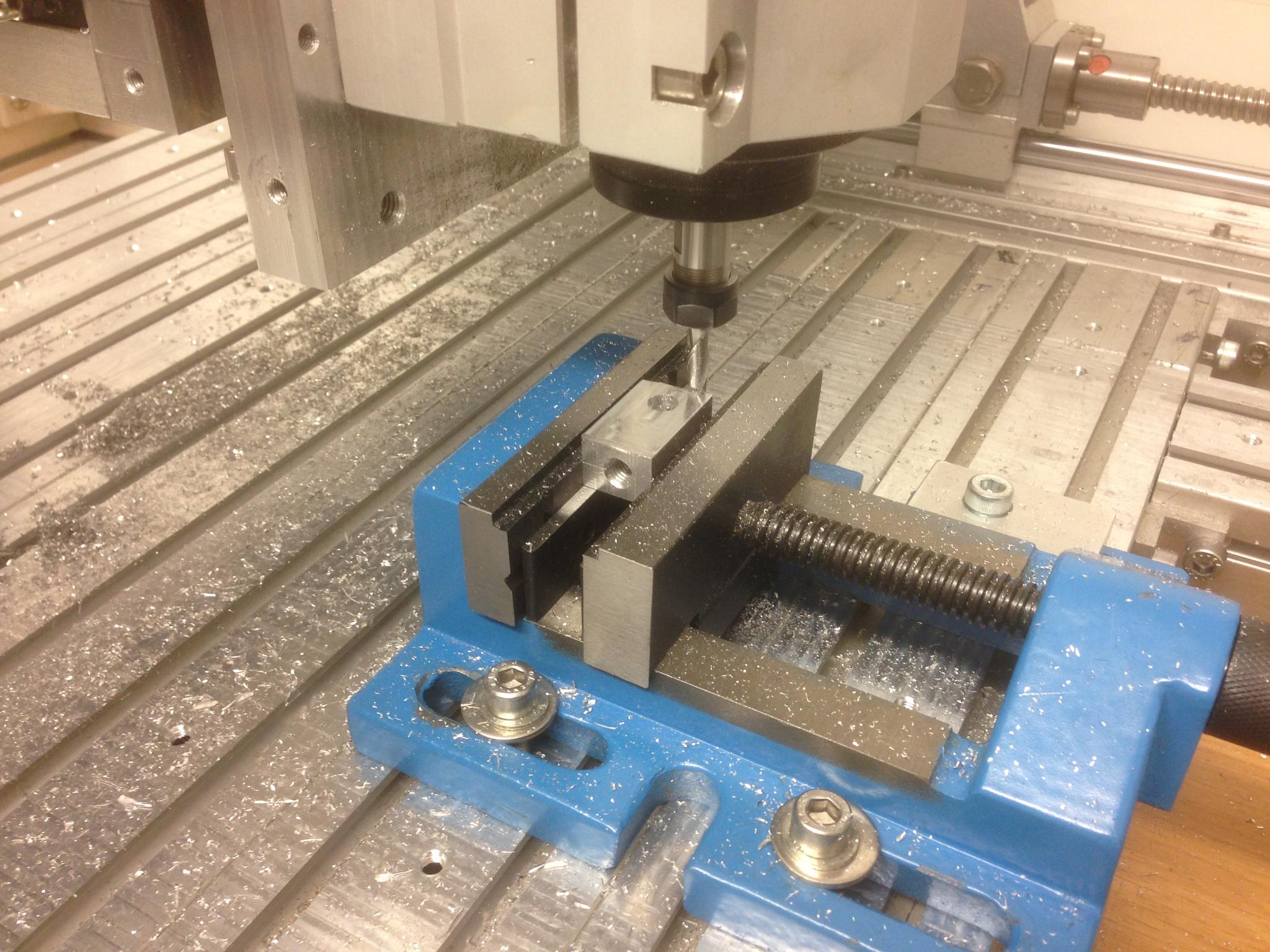

    Couple of little projects I made a few weeks back - thought I'd share them here.
    First up is a DTI holder to make it easier to clock the vice.
    Started with a scrap bit of aluminium and marked it out, drilled some holes, and did a trial fit:
    Attachment 16991
    Seems OK so trimmed it to size:
    Attachment 16992
    And there we are. Makes clocking the vice a bit easier - I used various clamps and bolts before and it took a while to set up. Now it is ready in moments:

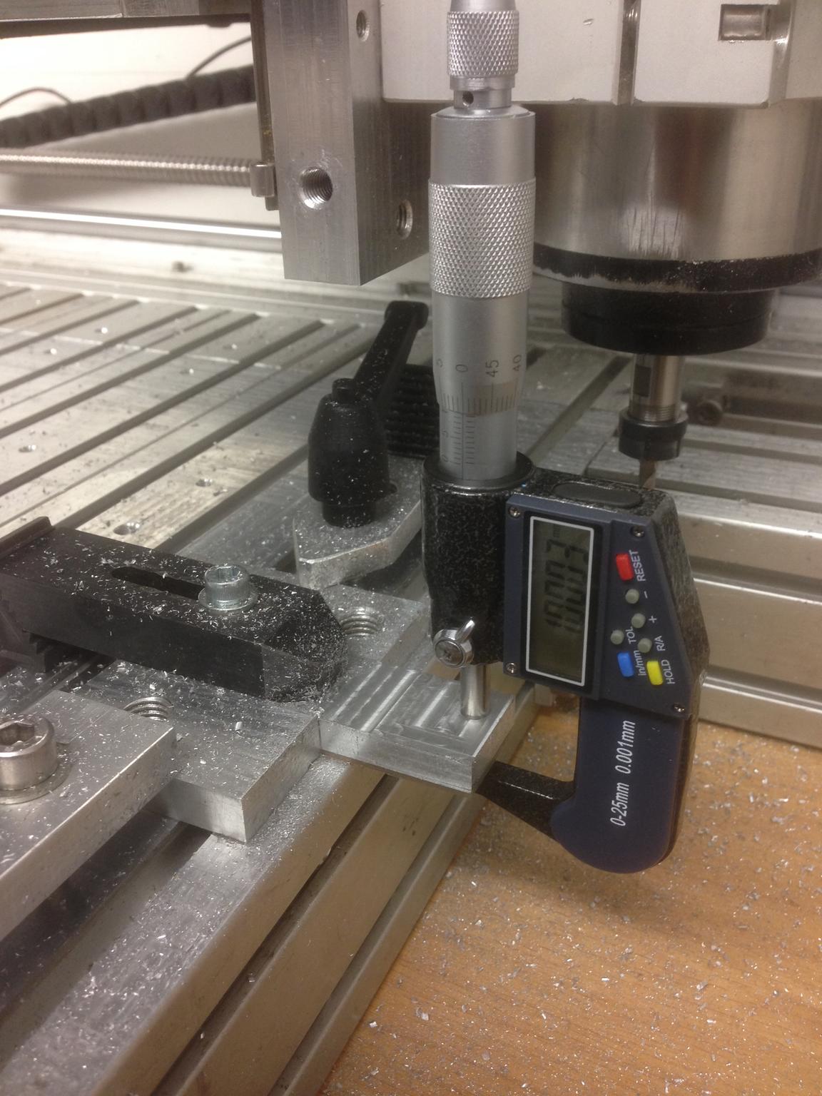

    Second little project is a touch probe. This is a piece if PCB board superglued to a block of aluminium. The PCB provides electrical isolation from the machine bed (otherwise the probe would be active all the time). I glued it to the block to give it some weight to hold it in place, and the PCB was not super flat.
    I've already glued the board to the block, and sized the block around the perimeter prior to this photo.
    Here is the block depth being skimmed to as close to 10mm as possible. Actual dimension is not critical as long as it is flat but 10mm is easy to remember!
    Attachment 16994

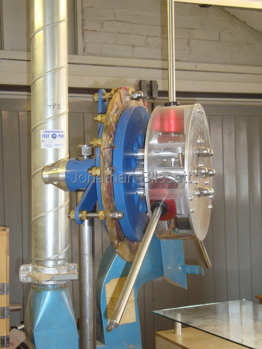

    I'll take this a bit more seriously now ... will try to make a post every week or so with something different I have made, as there are plenty of things. Lets go in date order and exclude things I've posted elsewhere on the forum, so starting in 2009/10, here is the wind turbine I made as my A-level DT project:
Name:	3m_variable_pitch_wind_turbine (Large).jpg
    This is the project that caused me to make my first CNC router - so I could make the blades for this wind turbine. Six years later and I've still not made the blades, but I found plenty of other things to do with the machine!

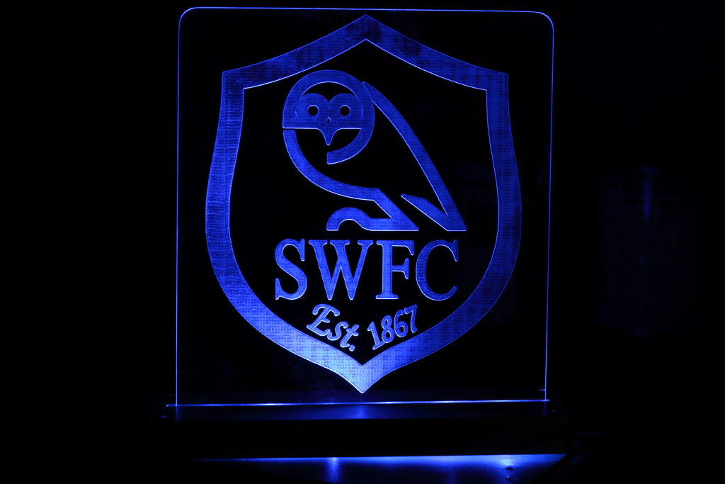

    Can't say I've been making anything "easy" like planes and guitars but, apart from a few signs/ plaques and a real badly designed butter dish, I've been making a few of these:
    Started with HDPE bases, but moved to black and silver Dibond. Much better and very "hard" to make ;)

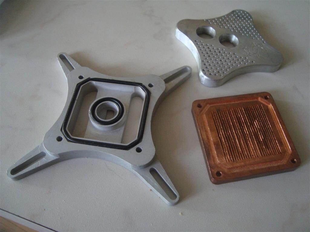

    One of the first things I made with my CNC router, with some help from my mill, a water cooling block for an i7 processor:
    The funny colour is from the anodising.
