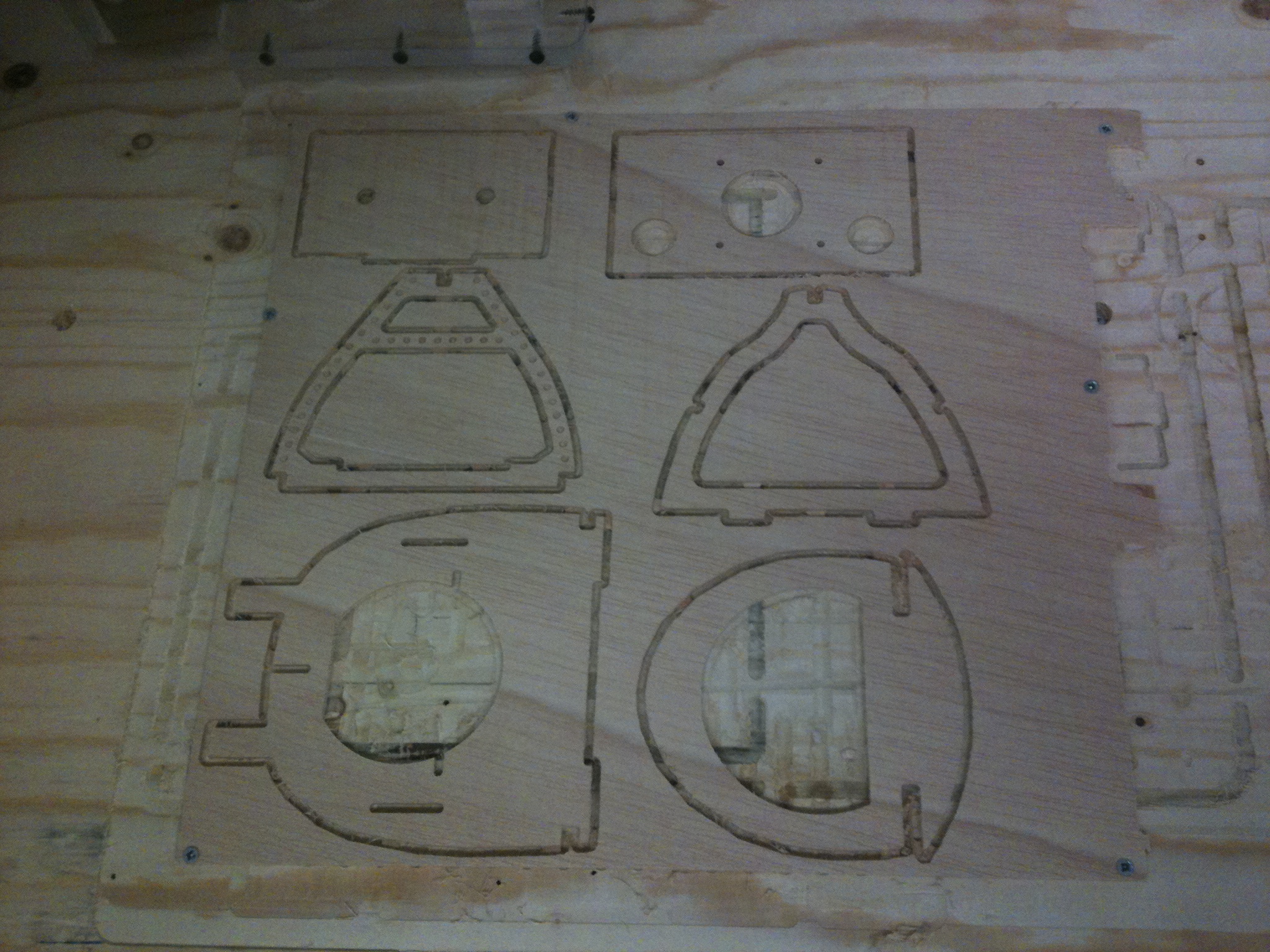

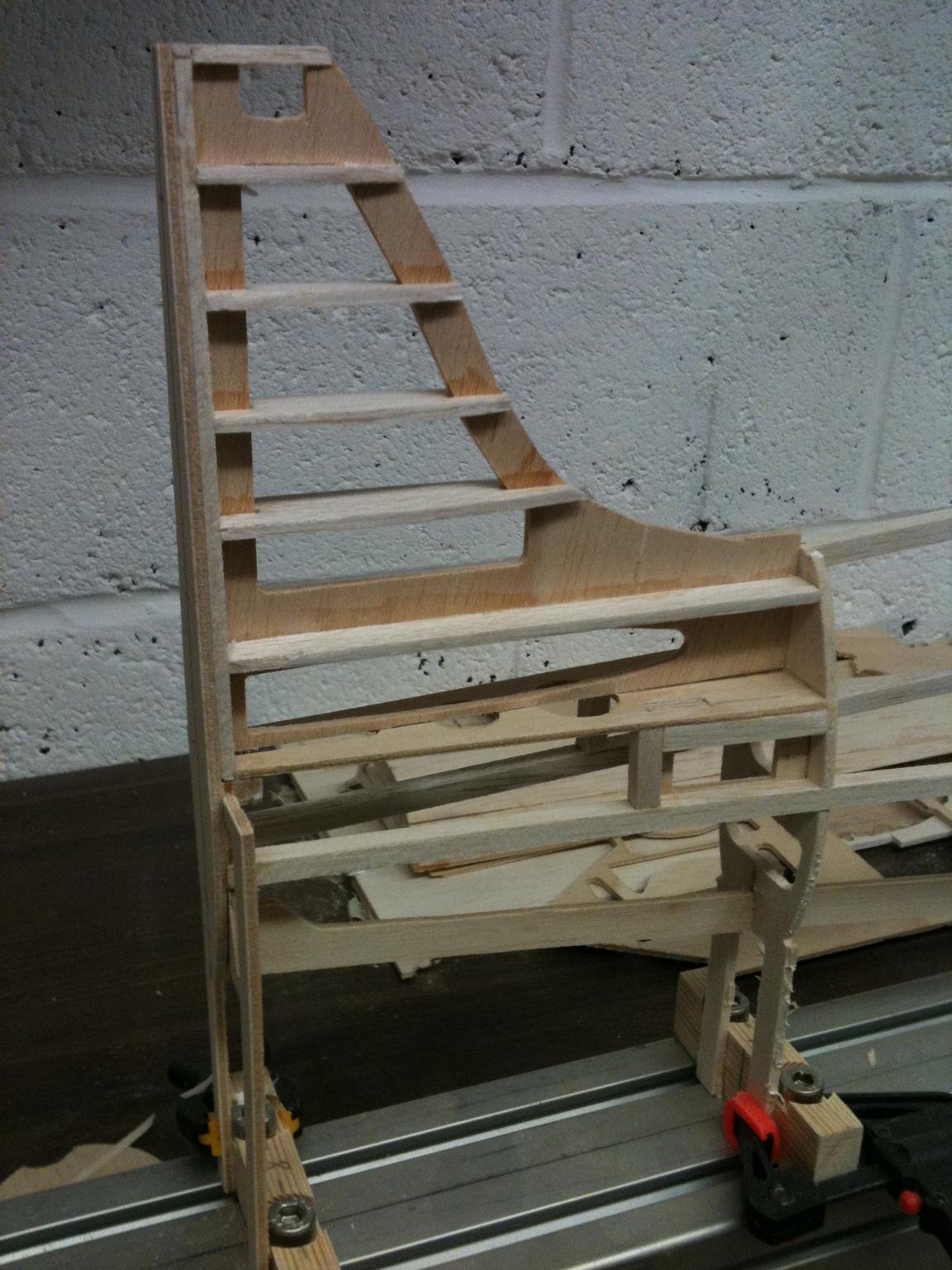

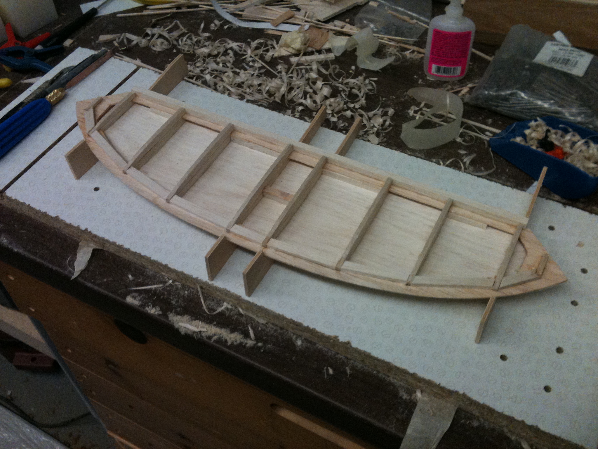

    Not quite as fancy as the trains etc in the link but this is what I started making about 4 years ago (!). It's my own design and should look like a Spitfire when complete.
    Formers being cut out:

    Fuselage:

    Fin:

    I've since gone through 2 cnc machine upgrades since these photos were taken and various workshop improvements. The CNC side has dragged me in - so much so that when I showed some pictures of my current CNC machine to a friend recently and he said what do you make with it? I had to pause and think a bit, before remembering it was originally designed to make balsa and liteply bits for RC planes.

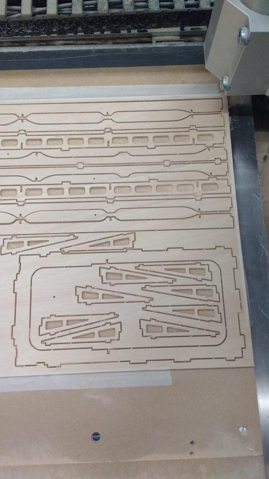

    Here's something I'm starting to build.....
    And when I've cut all 14 sheets of 3mm lite ply (600mm x x400mm) and assembled it should look something like this...

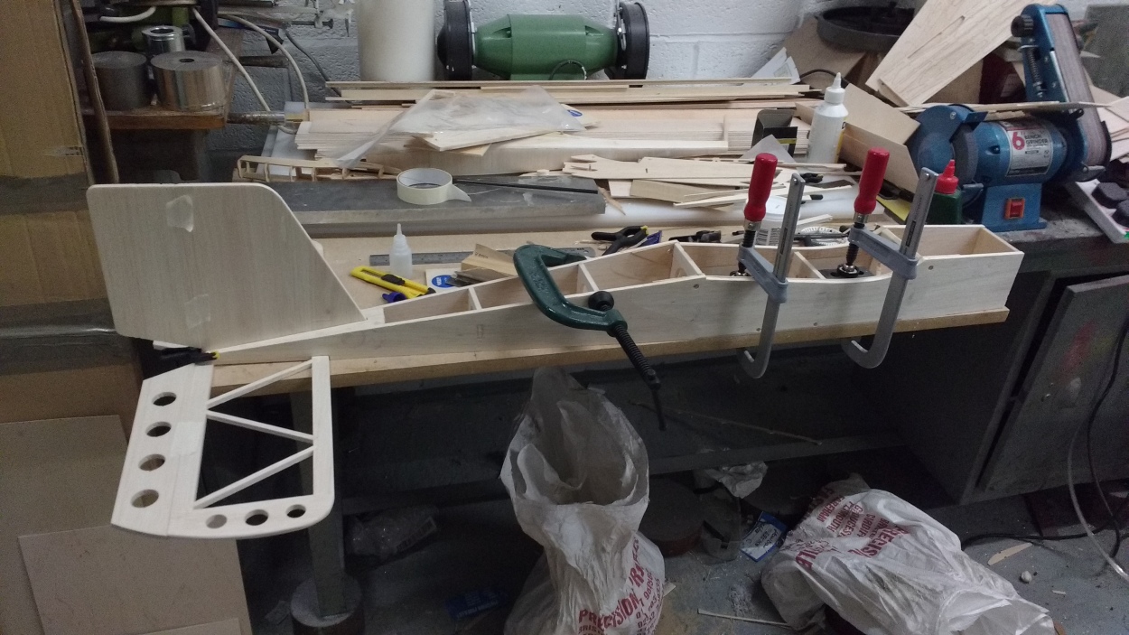

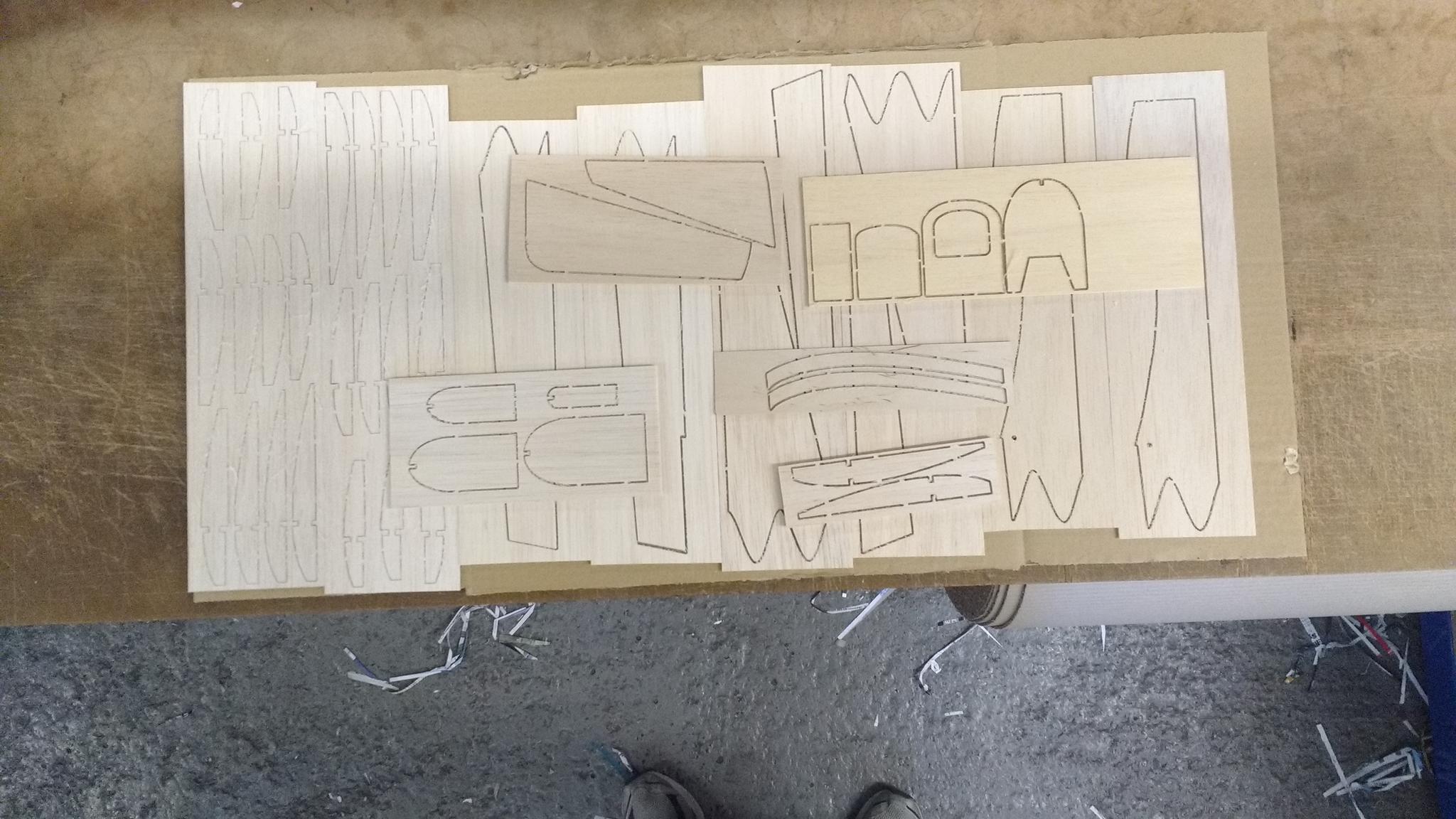

    Also making Ridge Runt RC glider short kits and Fournier RF4 short kits which I'm selling on eBay at the moment....
    shortly to expand the range to include my take on an Ugly Stick RC plane and an old timer 3/4 Ch plane.....lots more planned!!

    It's a carbide single flute 2mm cutter, can't use a 3mm as the slots are 3mm (would leave too much trimming of the slots to make them square) and some holes are 2mm. I've tried 2 flute cutters but they lift the balsa and ply too much. Also if I go much faster the splined joints don't fit as well. I'm still learning so no doubt feeds will increase once I get used to it!

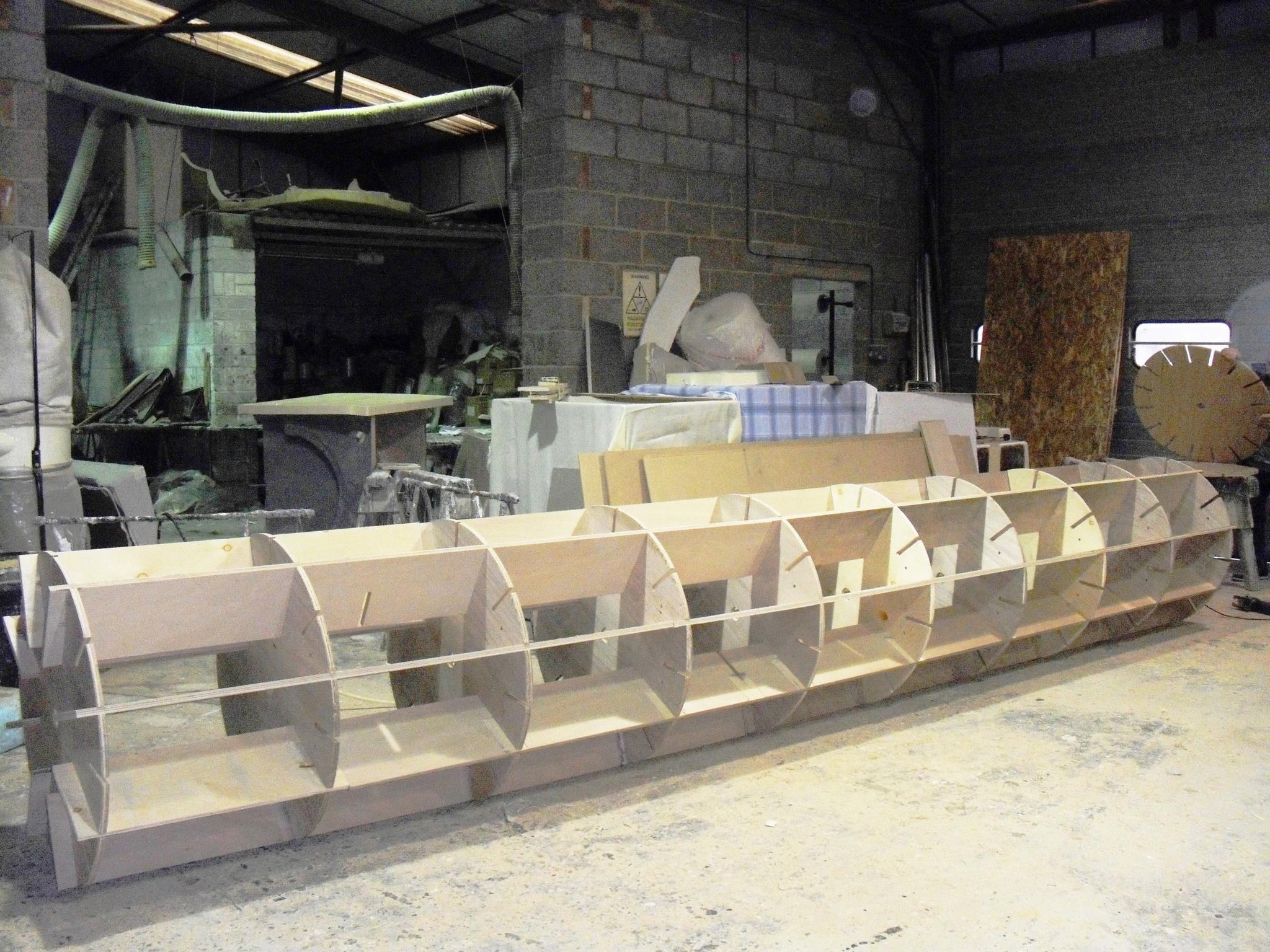

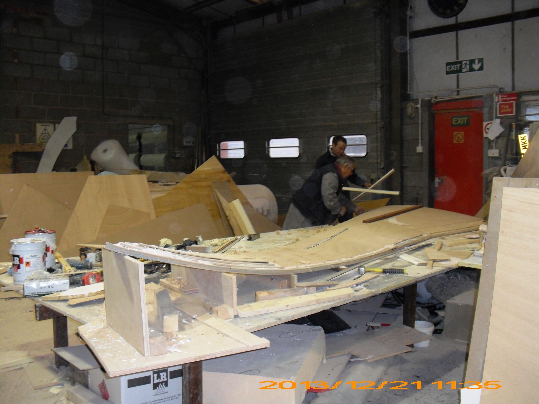

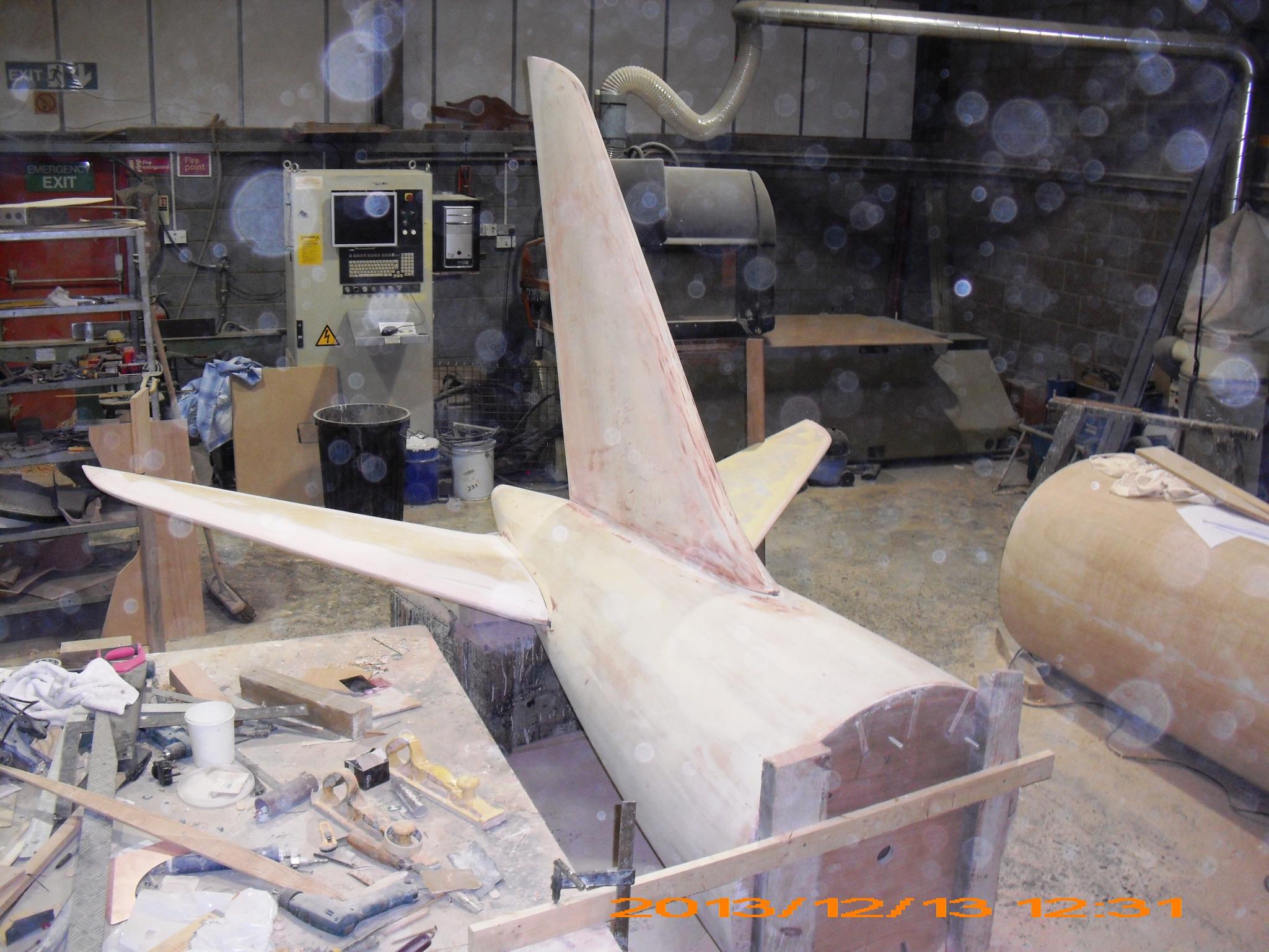

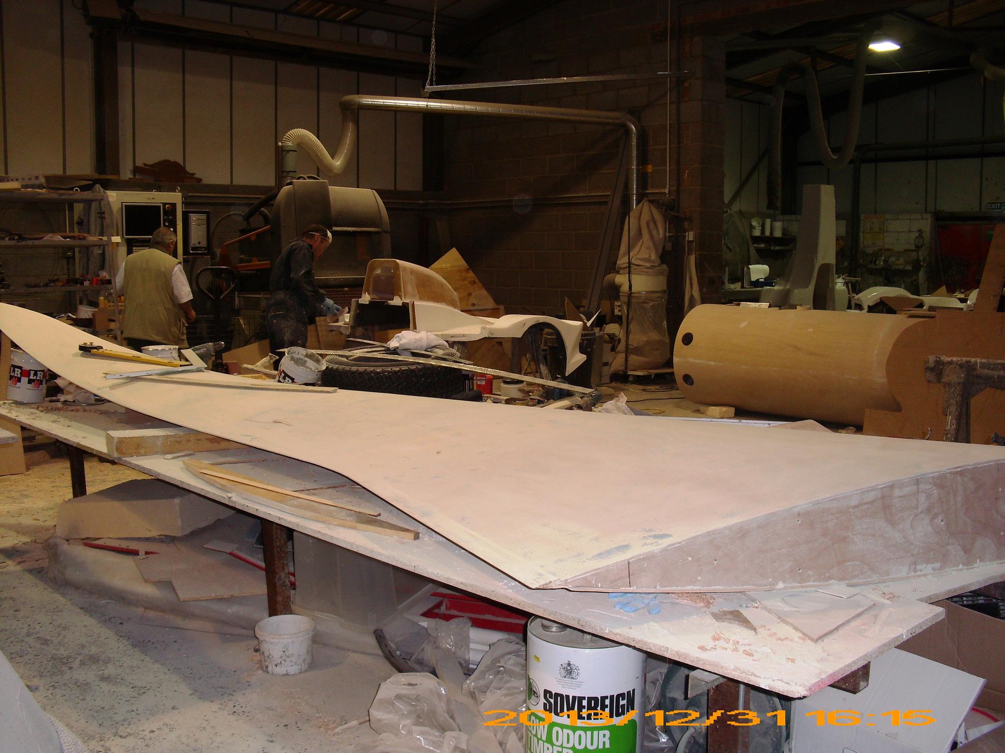

    About two years ago shortly after the purchase and repair of an old SCM 120 router my friend (who has a fibreglass works) showed me a schematic drawing of a Boeing 787 dreamliner and asked if I could make a 1:6.5 scale "plug" (pattern) for it. Of course I can I replied, convinced that he would never get the order for it - well I was wrong!!!
    Anyway, to cut a long story short I decided how the model would be built, drew it up using alphacad, machined the components and with the help of my friend and his workers built up the model in sections. Fibreglass moulds were taken from the pattern and three complete models were built, delivered and erected on the roundabout at Heathrow, terminal 4. I have shown some of the pictures to a couple of members of this site, but now that KC has started this thread I thought that I would share the project with forum members.
    As there are about 30 photos (I probably have 100or more!!!) I would like to post I shall taken it easy on you all and just post a few at a time.Click image for larger version.

    Geoffrey..... Wow!! just wow!. What a fantastic achievement! What were the fiberglass planes used for in the end? you mention heathrow? Are they still on display?
    Hate to say it neil, but this really pisses on your party. :rofl
    Geoffrey, you cant go from nothing, to building these... Therefore I am assuming this is just one of the projects in your photo collection, so while you have it open .....
    thanks for sharing.
    That's fantastic!! Agree with you Matt mine pales into insignificance in comparison!!!! I think I remember seeing a plane on a roundabout when flying from Heathrow a couple of years ago?
