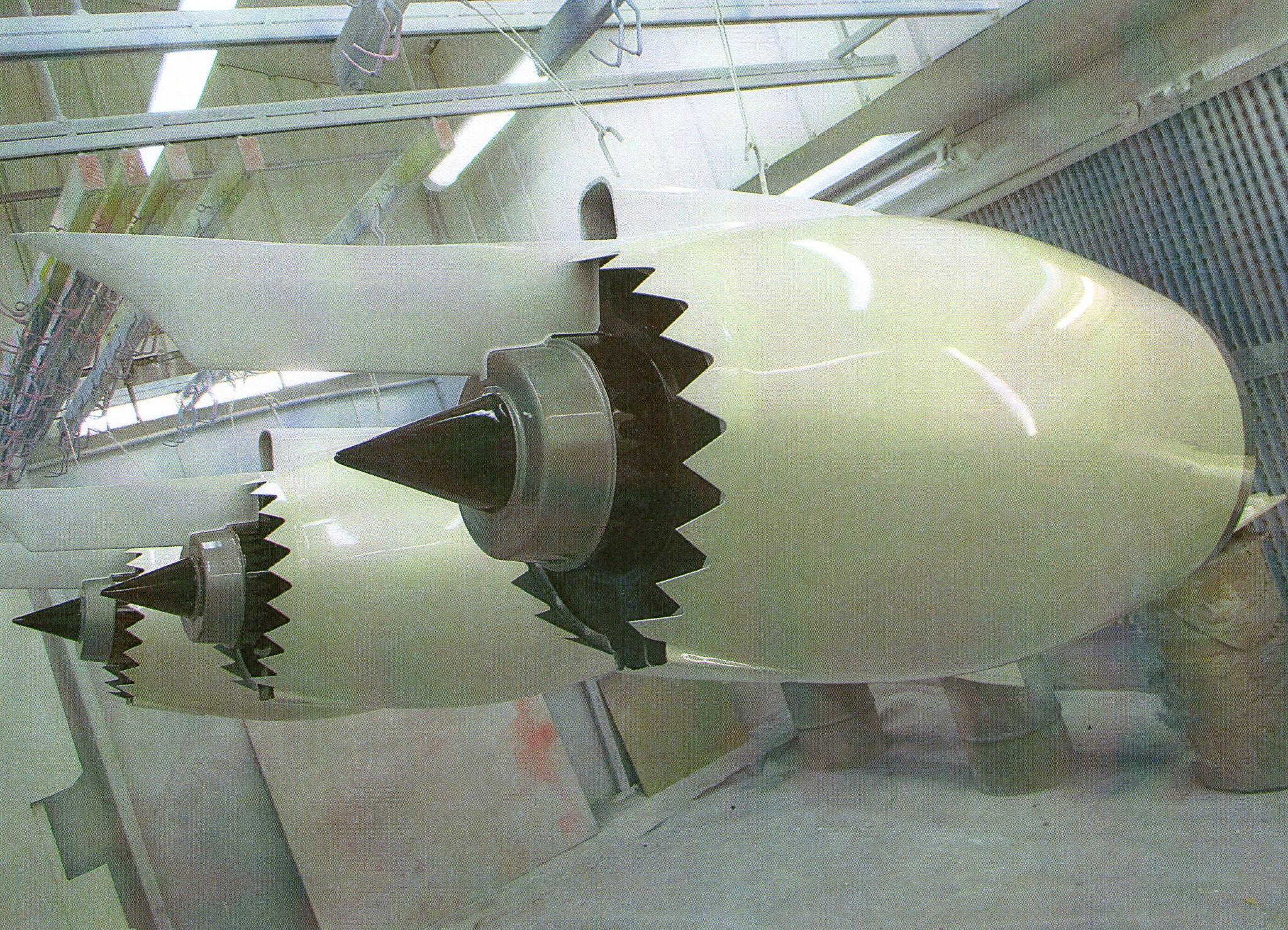

    Well its time now to post the remaining pictures of the dreamliner models at Heathrow. After the patterns were finished moulds were taken and mouldings produced, a steel frame (by others) was fabricated and the steelwork was bonded into the fuselage, wings and tailplane. The fuselage and tailplane sections of the model were bonded together, the wings and engines were trial assembled, but removed for transport. I made shadow masks for the cabin window lights to shine through, fixed to internal light boxes containing LED lighting strips. Cockpit, wingtip and tail lights were also fitted. The aircraft were painted in ETIHAD colours and livery vynals were added. I supplied a dxf of the window shadow masks to allow the vynal chaps to supply a mask for the windows prior to painting. As I said earlier,Click image for larger version.

    six months after the planes were errected they were dismantled and returned to the paintshop for the new livery. I have used the dusk photograph of the three planes as screen wallpaper on all three of my computers!!! G.
