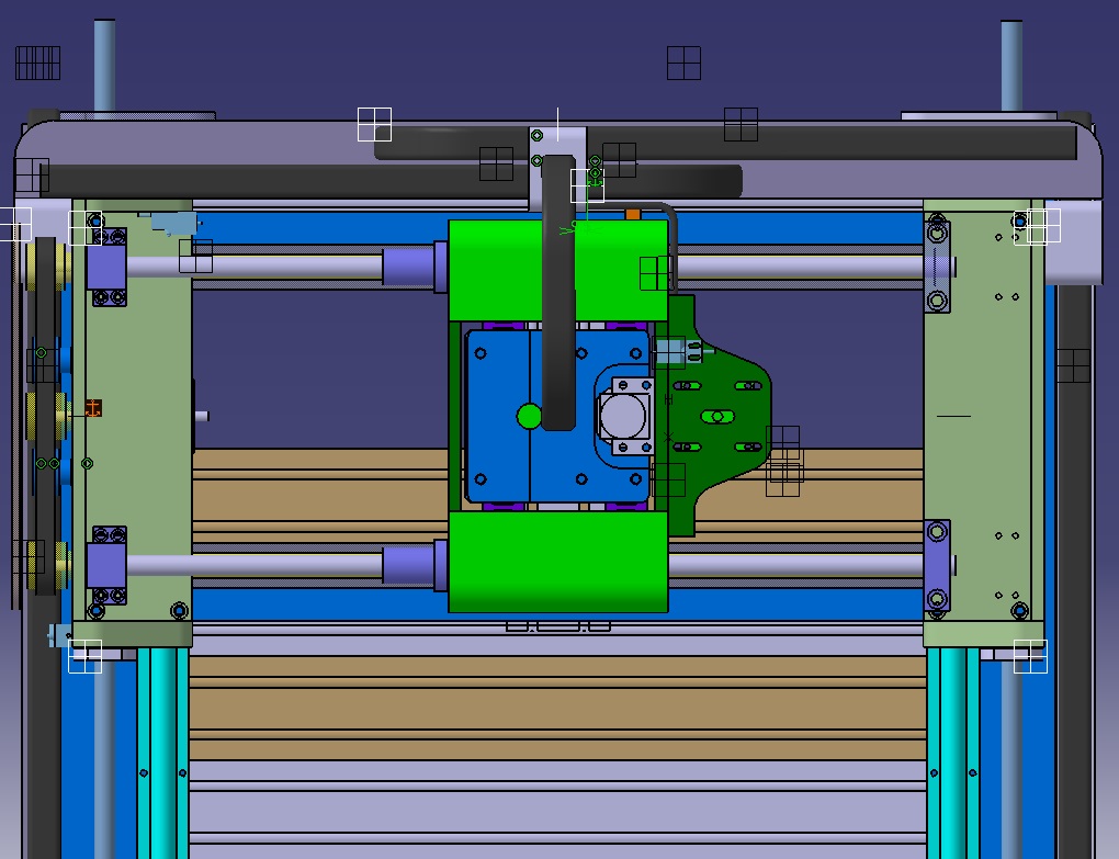

    So I would like to get a larger mill that is designed mainly for cutting Aluminium. This means high speed spindle and fairly quick feed rates.
    Heavily inspired by this design (http://uk.dmgmori.com/blob/172034/d7...0-pdf-data.pdf), see pages 4 to 7, I came up with the following design. This is also very similar to the Ultimaker 3D printer design where you have a 'box' and you keep all the movement on top and place everything centrally over the table.
    The design is drawn using 1605 Leadscrews (C5 grade) and 400W Servo Motors (4, 5 or 6) - Cant decide if Z and Y need 2nd screws or not. Rails are Hiwin 20 (for Z) and 25 for X and Y.
    The spindle will be a 4KW Chinese Watercooled spindle.
    Cutting size based on the design is around X and Y - 600 mm x 600 mm x 250 mm.
    For the frame, I want to look at using something 'interesting' like Epoxy Granite or something similar. For any parts that are needed, these will be done out of either steel or aluminium.
    Thoughts / critique welcome. Thanks.

    Hi Chaz,
    Some thoughts -
    1.The plates which hang off the Y axis (and hold the Y bearings) look weak as they cantilevered off the side.
    2. How will you clamp the spindle? Are you planning on using grub screws? Not sure that is a good idea.
    3. Are you only using 1 bearing per rail on the Z axis? I would use 2 per rail.
    4. I would use 2 screws on Y to get the most out of a machine like this.
    5. 2 screws in Z is worth looking at but it takes up Y travel and I think one screw is still pretty good.
    I've also been working on a new design over the past few weeks based on the DMG Mori - here is my attempt so far:

    Yes, forget it. How big should the machine be?
    That dubious concept isn't as easy as it looks. I think they have a gantry Axe on Y (if the normal X-Y is correct) only, because Hermle have a patent for a centralised Spindle. Gantry have no advantage against 1 spindle in the middle, except in a really large machine.
    And your control must handle 3 of it. Can it do this.
    The same for X and Z. This construction is ok, if you have a spindle with a ton or more. If not its much too complicated.
    And the Z axe don't work, you have 4 guiding carriage (I hope the word is correct, the slider on the linear guide) 4 or eventually 3 is correct, but not in these layout.
    You need 2 sliders per linear guide. And if you want 4 side by side each must
    parallel within a rather tight tolerance.
    If its for yourself and you don't want to sell it, then you can make it with a central spindle.
    A gantry spindle brings no advantage, but much more effort, each Motor and driver must bought double.
    The concept with the u-shaped bed is good, but all other too complicated. Unfortunately I don't know, how I can add a pdf-file.

    Chaz,
    You seem to have money to spend on this which is why I am keen to see what you come up with. My suggestion on the spindle arrangement is to make the box section adjustable so that you use two of the rails as data to bring the other two in to take up the tolerances.
    Getting two carriages per rail should go without saying, but you may get away with two per rail on the back and one per rail on the front.
    Do you have the powersupply for the 4KW spindle?
