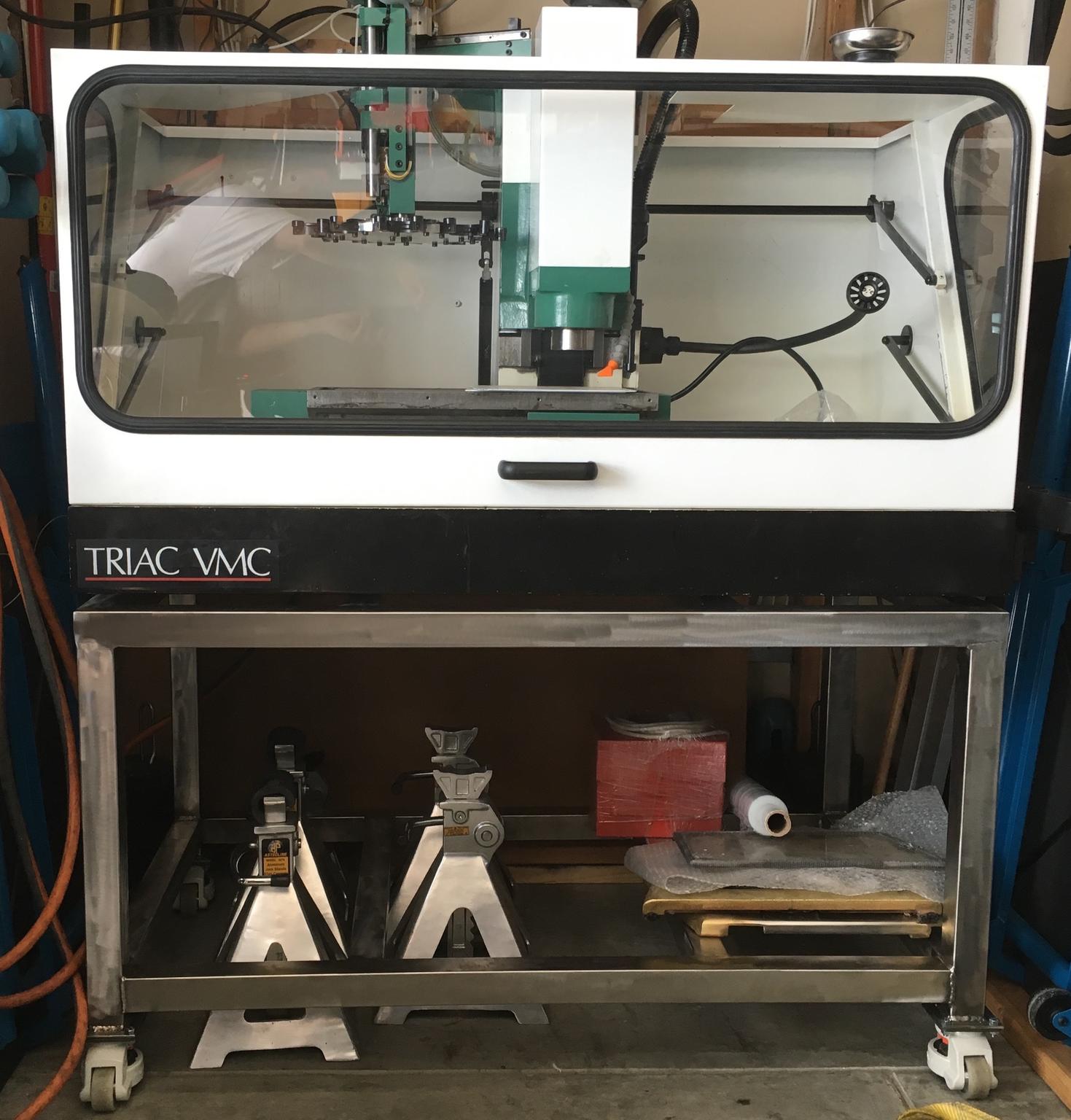

    Hello,
    This is my first post. However, I am not new here. I have been on since 10/2012 reading about all great stuff that you guys accomplish with your machines.
    After reading Chaz's Triac VMC conversion post, I decided that I am going to attempt to do mine. Thanks Chaz!
    http://www.mycncuk.com/threads/8800-...near#post70146
    I have a stepper one (not a servo), but the conversion should be close to Chaz's. The first thing that I did was weld up a stainless steel table on adjustable casters. The funny thing here, with all my great wisdom, is that I first made the table tall enough to fit the control box under it! Unfortunately, my thinking in the beginning was totally off. I didn't realize how bad it would be to work on a step stool to get to the machine. So I bit the bullet and removed the machine off the stand (what a pain) and cut the table legs down and re-welded it. It looked much better the first time.
    A pic of the second version of the table...

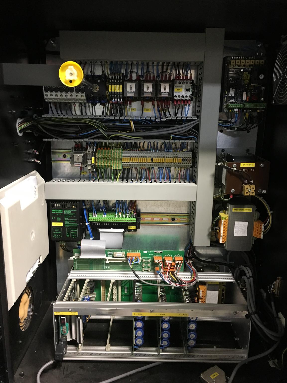

    The control box...

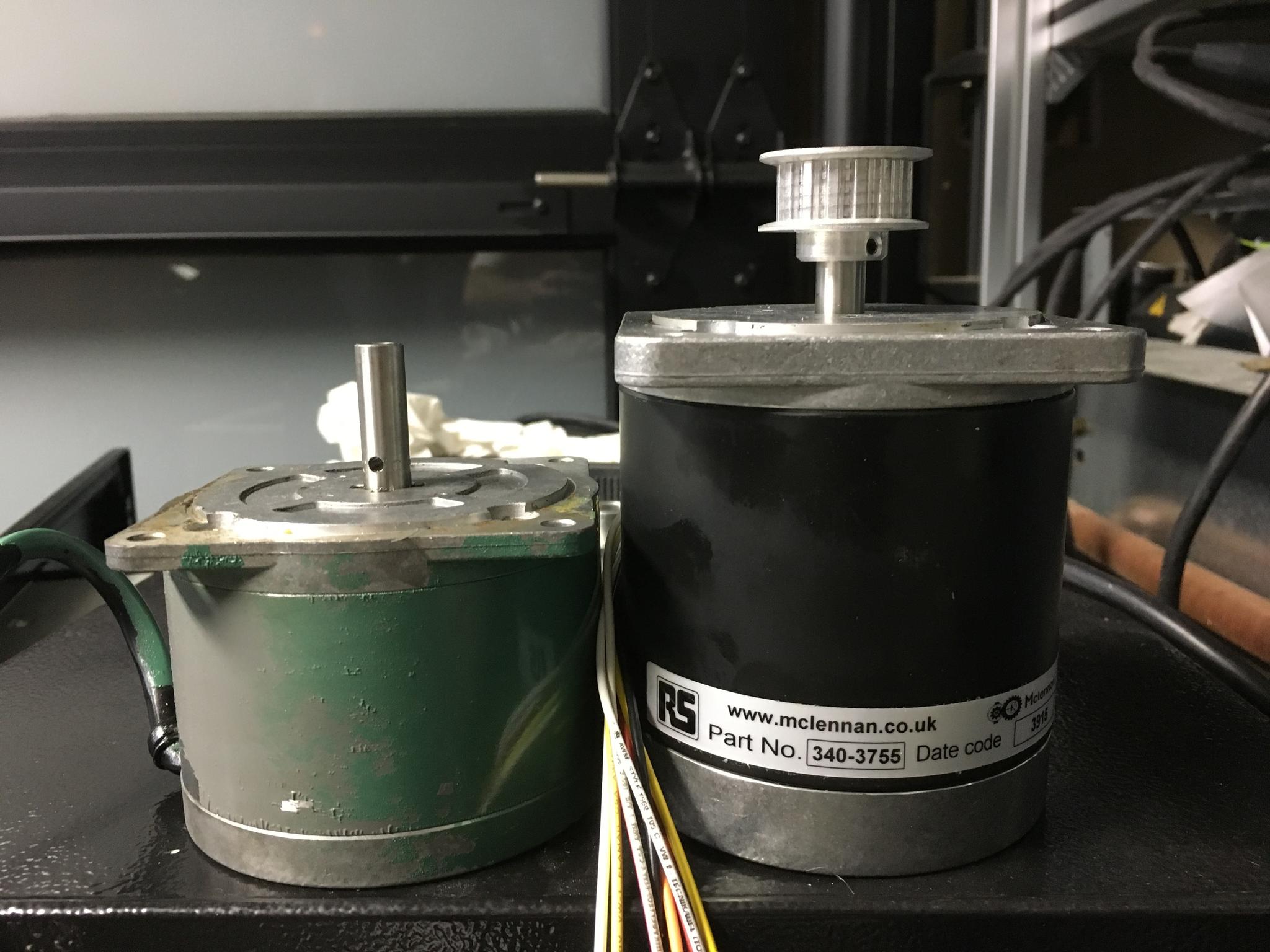

    ...so with the machine in place, I started my research on the following:
    1) New steppers for X,Y,Z
    2) Stepper drives
    3) Controller
    4) Mach 3 (reading that Mach 4 isn't not quite up to par)
    What I have so far are the new steppers. I found ones with 9.5mm shafts that would fit right in. Unfortunately, I didn't check the shaft on the Z axis, which is 12.7mm and keyed. So, I ordered a new pulley to fit the new Z stepper. Given that the shafts are small and are not keyed, I decided it would be better to use a coil pin on the pulleys to hold them in place. I felt this was especially needed because of the weight and torque on the Z axis.

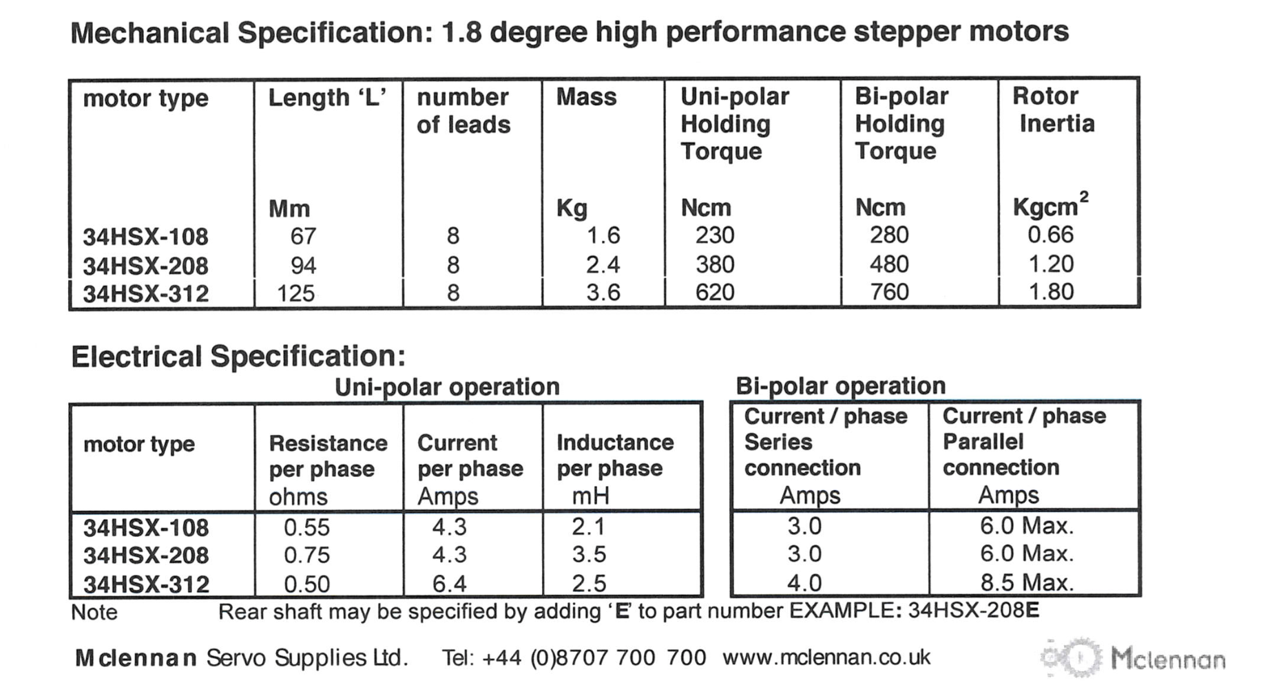

    The McLennan RS steppers:
    X = 34HSX-208
    Y = 34HSX-208
    Z = 34HSX-312
    Below are the specs...

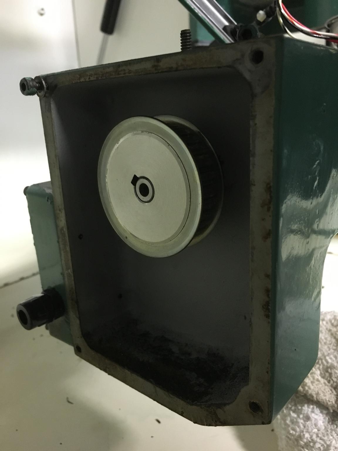

    The spacer should be on the inside race so it shows the lock nut squeezing the outer races together....if that's how its assembled? I thought they normally had the lock nut on the inner race with the ballscrew also on the inner race and the outer races locked in position?
    Neil...
    Build log...here
    The tab nut tightens the inner race of the bearings not the outter
