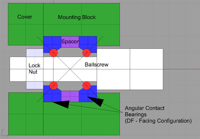

    ...the blue ones in the illustration below. I was trying to figure that out.

  4. #24
    i2i's Avatar
    the drawing doesn't really represent the action, but that's where it is.
  5. #25
    You cannot adjust the ball screw bearings, they are what they are.
    When you have an angular contact bearing in your hand the middle wobbles back and forth.
    So what your almost doing when you have a pair is pulling the middles together to get rid of that play.
  6. #26
    Quote Originally Posted by stallone View Post
    This drawing is not correct as it is not showing the inner part of the AC bearing
  7. #27
    The spacer should be on the inside race so it shows the lock nut squeezing the outer races together....if that's how its assembled? I thought they normally had the lock nut on the inner race with the ballscrew also on the inner race and the outer races locked in position?
    Neil...
    Build log...here
  8. #28
    The tab nut tightens the inner race of the bearings not the outter
