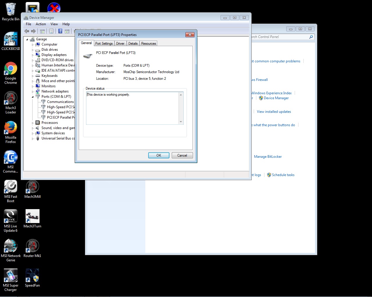

    Well it's all ok now
    Got a motion controller, as many PCI cards for the parallel pore are just jumped up usb cards and as such won't work. I used a uc100 cost a lot, but then I could have had to get several parallel port cards before I found one which worked. Note this will only work with win 7,8. 2000and xp. I went for win 7 (8 is awful) and xp is good but history. The installation puts mach 3 in first then it's own drivers and it has a smart little screen in the plugins section of Mach 3 which enables you to view the port conditions without using the complex diagnostics tab
