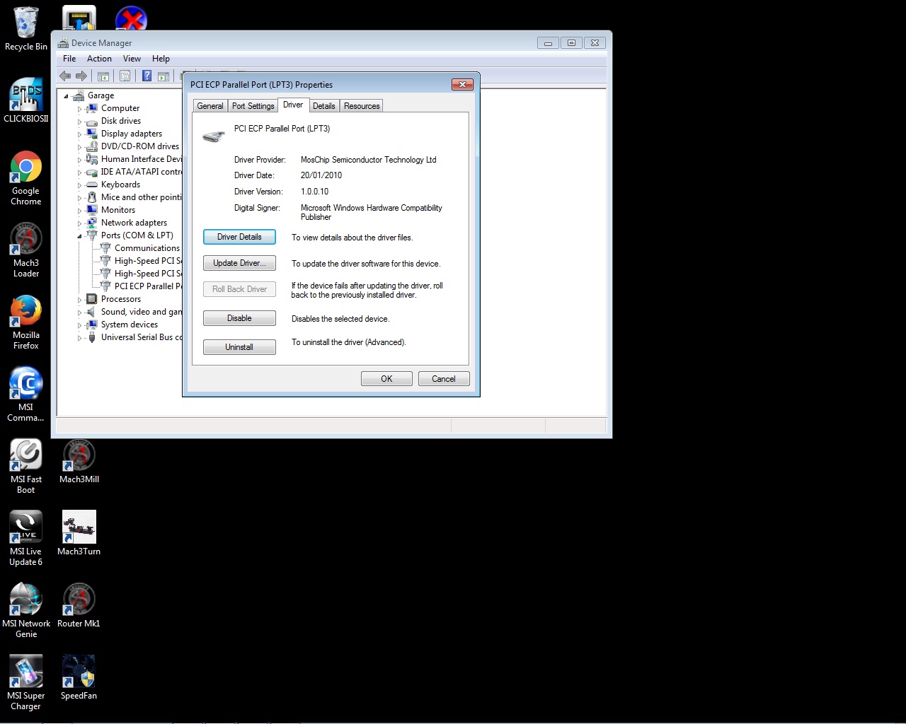

    Quote Originally Posted by Cnc many View Post
    problem is that the i/ o range at EE000-EE 007 is shown in the device manager (resources) is listed as unavailiable with a red no entry sign in the device manager.
    The red flag on the device indicates that the driver is not properly installed. It could be that the driver is not compatible with Vista. Software for a lot of add on cards was not developed after XP so you could be struggling. My dedicated CNC machine uses XP without any unnecessary 'features' I have PP card installed as well as the onboard LPT. Both work OK.
    If you go into Device Manager and click on the PP you will get a window with General, Driver and Details tabs. Under details there is a Hardware Id in the list. If you select this you should get the hardware id, which you can copy and paste into a search engine. It might point to a manufacturers page with drivers to download.
    It is a slim chance, but it is the best I can offer. It worked for me with XP.

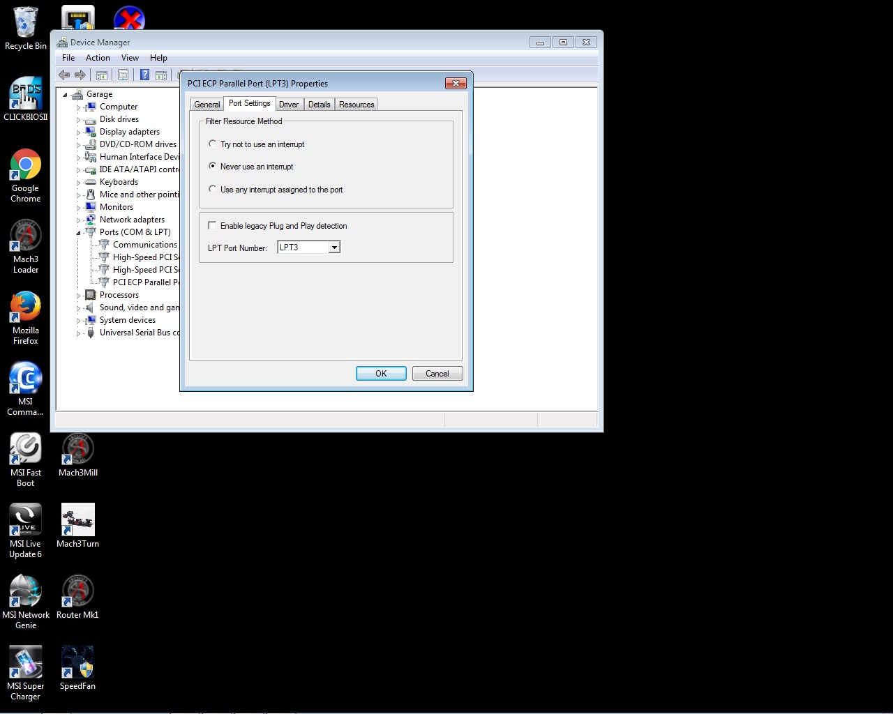

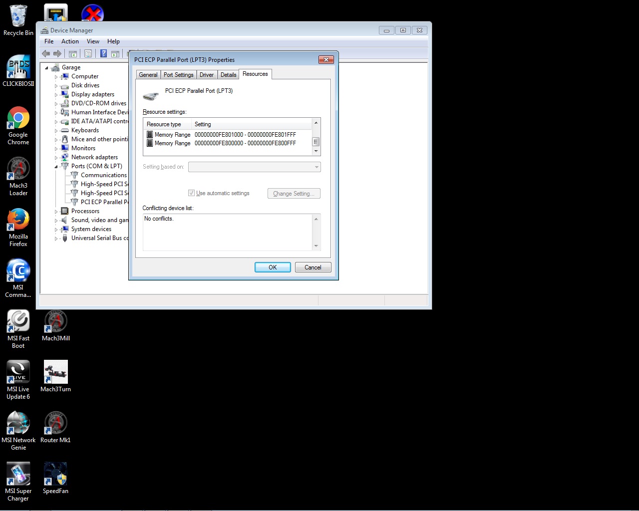

    I'm using one of these on an AMD A55M-E33 motherboard.
    Here are some screen shots of device manager entries, which may or may not be useful!

    I'm inclined to agree with Rob - most likely issue is the wrong driver. Are you happy that you have the right one for your system? Again, FYI, I'm using Win7 64-bit. Sometimes you might need the corresponding Vista version (32- or 64-bit) if there is nothing newer around and these seem to run OK on Win7.
