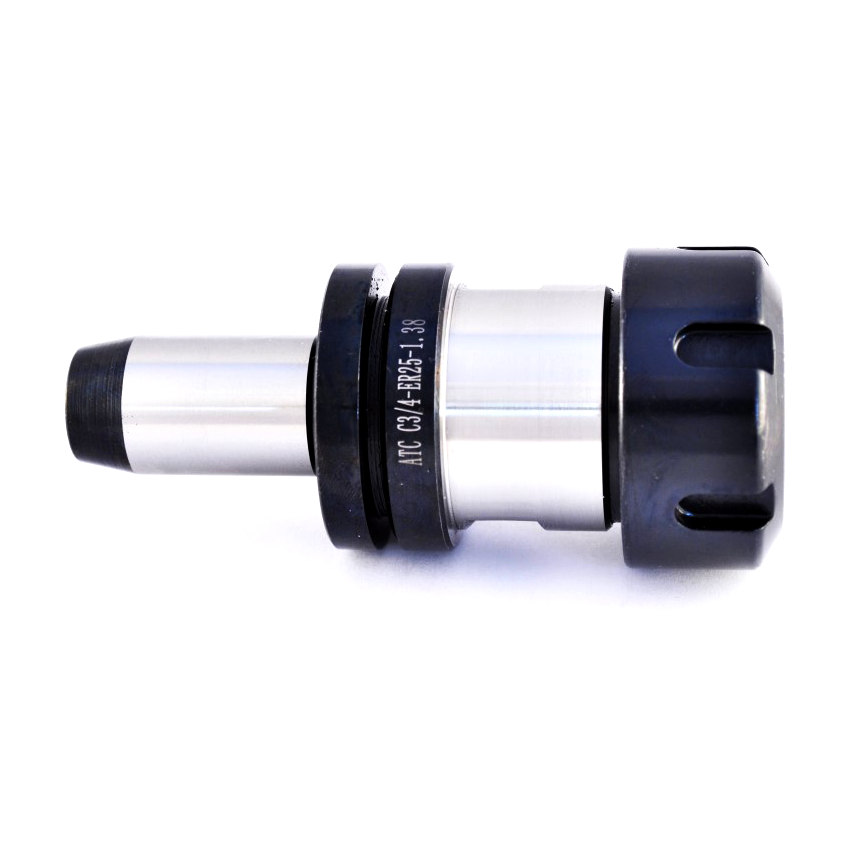

    It`s actually an MT3 spindle, which is using a 3/4 collet adapter, which means I can then use "tormach style" tool holders. I got 10 x holders from china for around £112 posted
