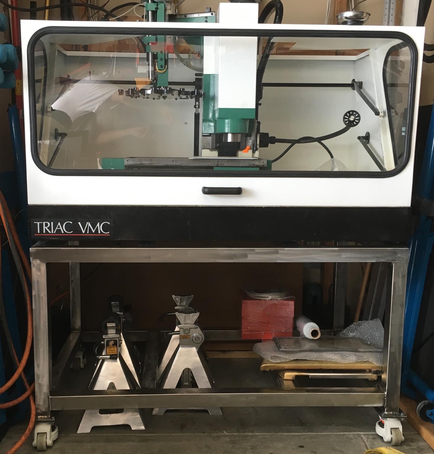

    I have a stepper one (not a servo), but the conversion should be close to Chaz's. The first thing that I did was weld up a stainless steel table on adjustable casters. The funny thing here, with all my great wisdom, is that I first made the table tall enough to fit the control box under it! Unfortunately, my thinking in the beginning was totally off. I didn't realize how bad it would be to work on a step stool to get to the machine. So I bit the bullet and removed the machine off the stand (what a pain) and cut the table legs down and re-welded it. It looked much better the first time.
    A pic of the second version of the table...

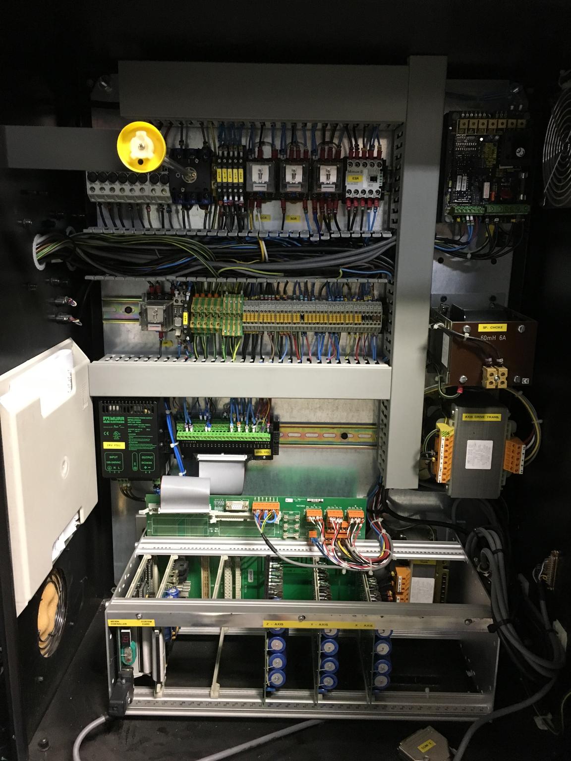

    The control box...

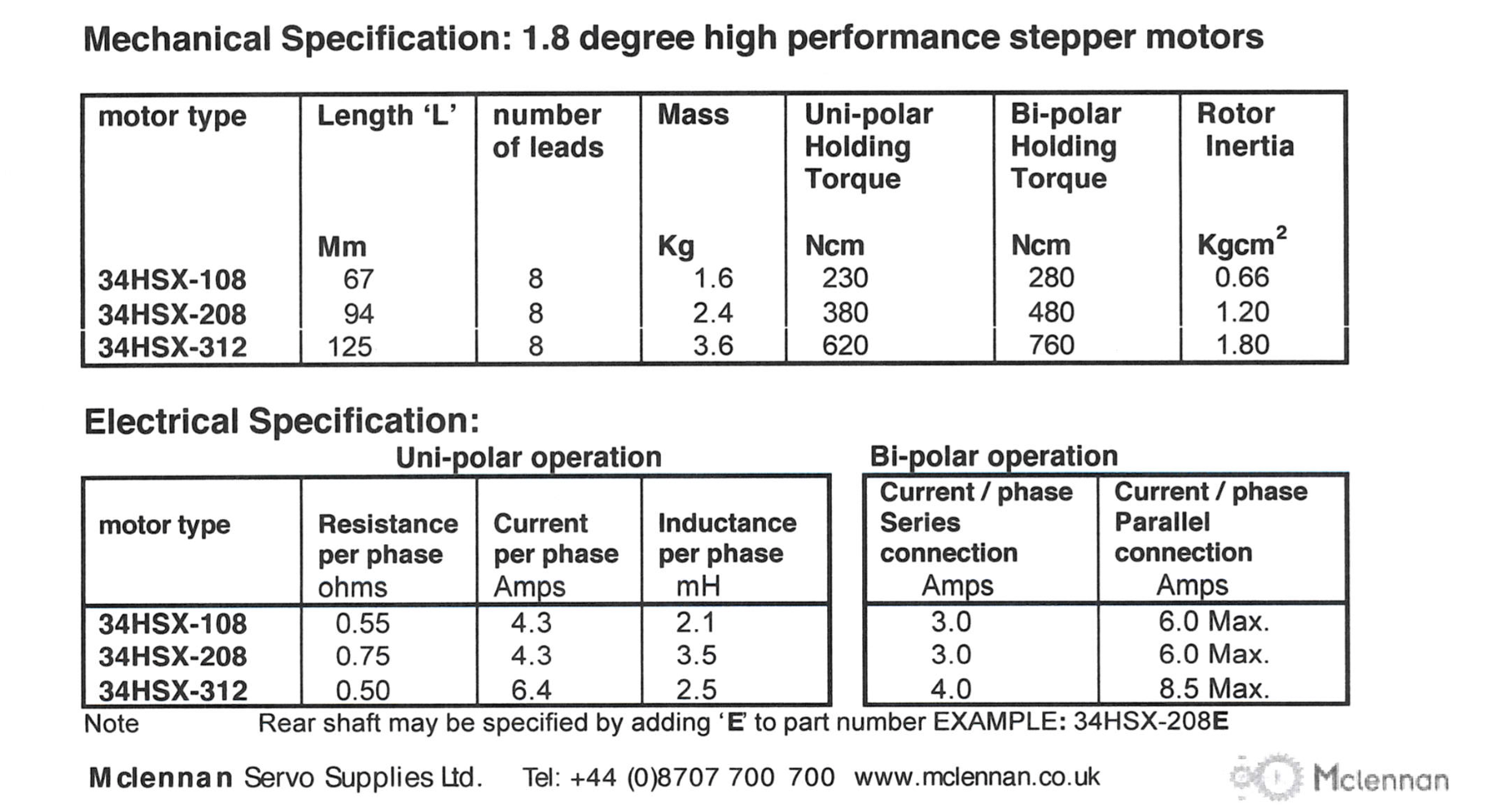

    What I have so far are the new steppers. I found ones with 9.5mm shafts that would fit right in. Unfortunately, I didn't check the shaft on the Z axis, which is 12.7mm and keyed. So, I ordered a new pulley to fit the new Z stepper. Given that the shafts are small and are not keyed, I decided it would be better to use a coil pin on the pulleys to hold them in place. I felt this was especially needed because of the weight and torque on the Z axis.
    The McLennan RS steppers:
    X = 34HSX-208
    Y = 34HSX-208
    Z = 34HSX-312
    Below are the specs...
